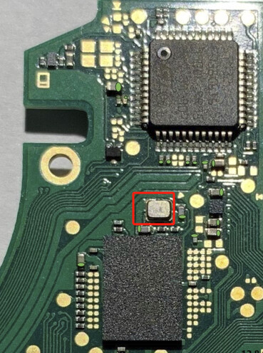

It was the crystal for the card reader. Replaced and all good
