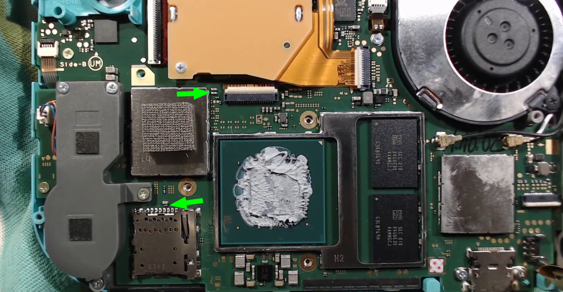

Recently I received a Switch Lite which has been tampered with. Current owner says he attempted to install the SXOS modchip by himself, which went wrong. So he asked me to remove it from the board and I had to undo all the solder and flux leftovers.
The board is now free from the modchip set, but in the process I removed a capacitor, which I believe it’s a bypass one, by the screen connector and also another cap, a 0201 one, next to the microSD card slot (Check picture).
Those have been fixed and new ones soldered onto the board. But now there’s a problem: I set the screen brightness to 30% and then start downloading a game and I let it enter sleep mode (while still downloading the game); If I press a button to wake it up, screen brightness is now at max and the slider no longer works - as if that wasn’t bad enough, there is this constant buzzing going on around the right side of the Switch, which involves the area where those caps have been replaced.
If I enter sleep mode again (this time, not letting the system do that over time - rather, I do it manually) and then wake it up the noise is gone, screen brightness goes back to 30% and the slider now works. Could that have anything to do with the caps I replaced?
