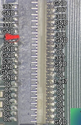

I have a switch lite that aparently is turning in because i can hear sounds…the backlight i think its working because i can see a light behind the lcd when the console is opened… but i have no picture…i tried reading the lcd connector in diode mode and got a strange reading at one spot that should be 306… its shorted to the ground… sould it be a bad connector or any other tip on how to find the problem? The picture below show in red the pad i’m getting short to the ground
My guess is a bent pin inside the connector. Can you check if your grounded pin isn’t touching the neighbor GND pin.
I put a needle between the poijts…now i get OL reading…i think thats the lcd connector the problem right?
