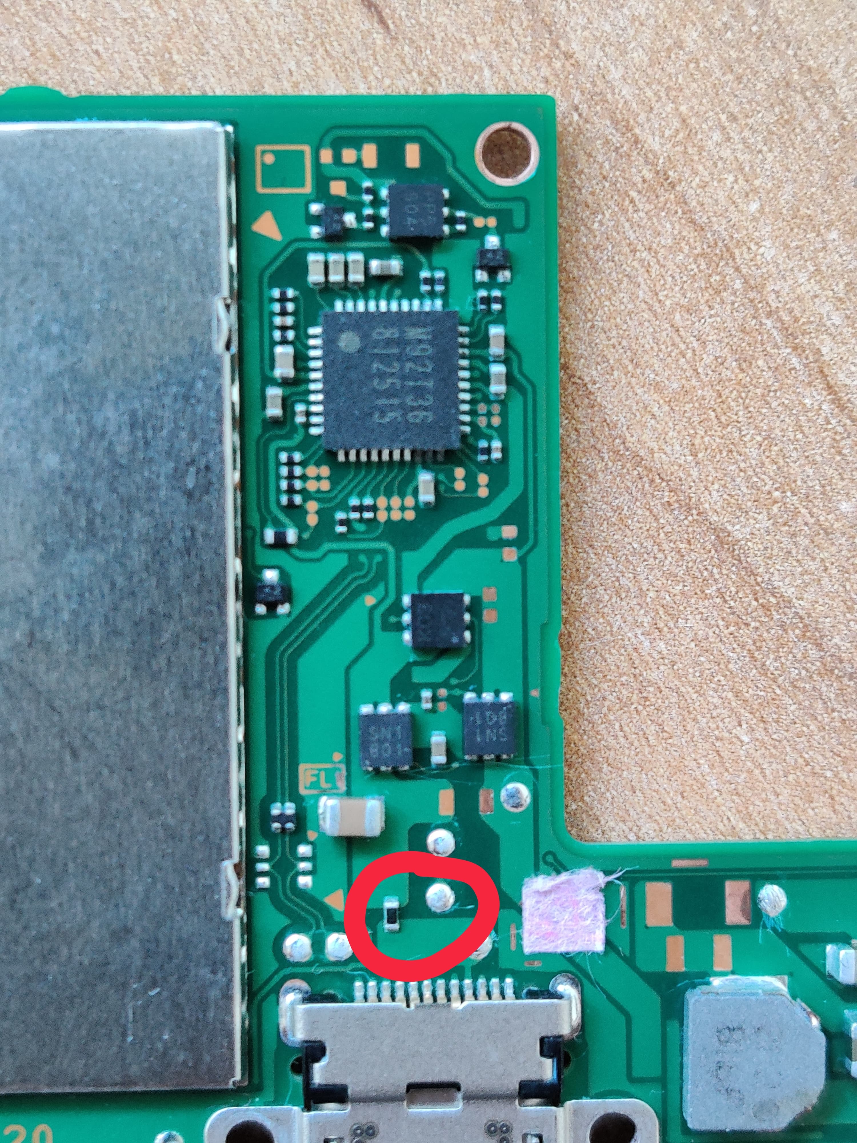

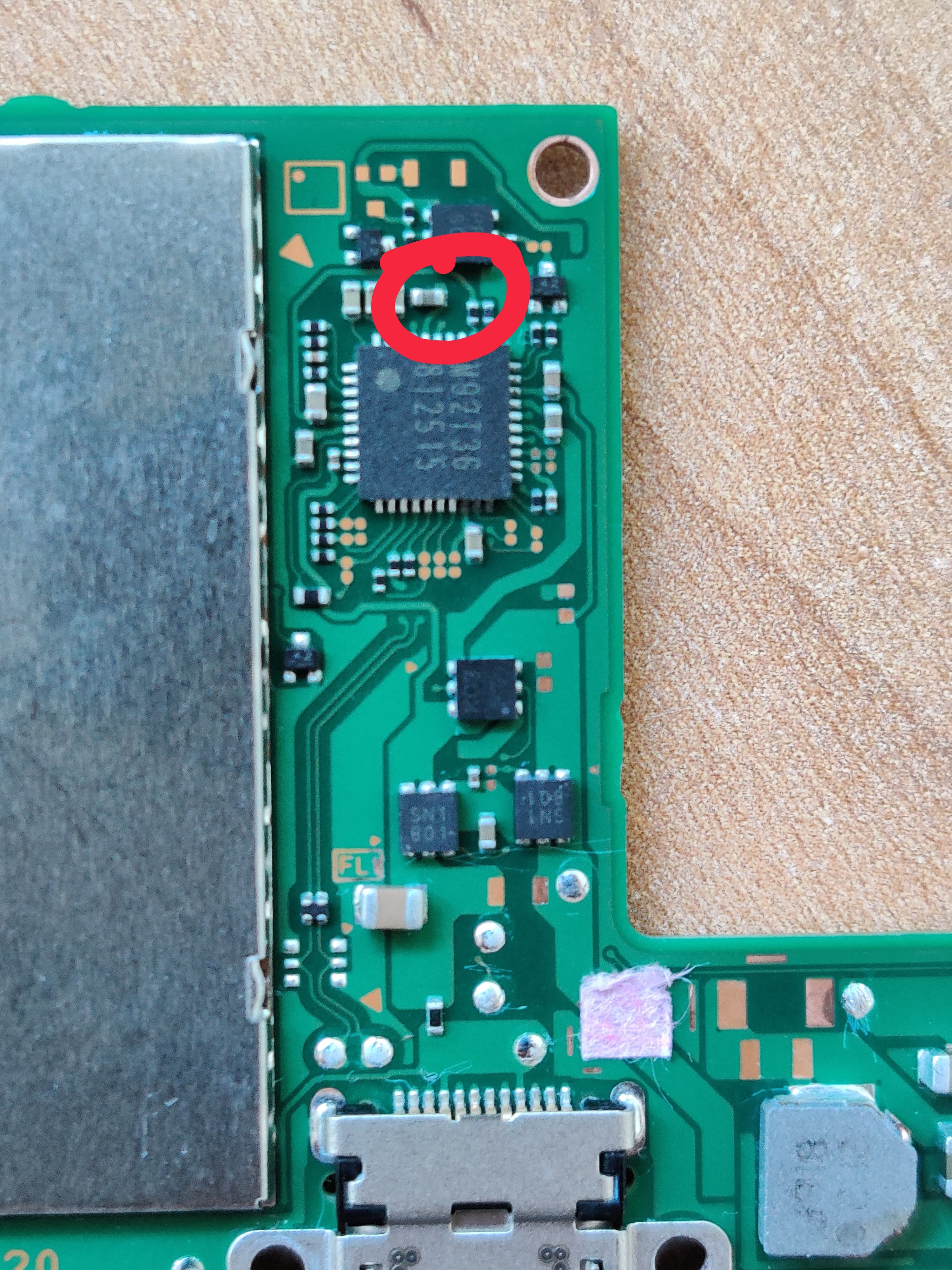

Hello everyone. So my switch is currently not charging and is at 5V and 0A constantly. It had liquid damage and I have removed all the corrosion I can see. I have found 1 short at a capacitor near the M92T36 and there is no continuity within the fuse. I plan on replacing the fuse, but should I also order a new M92T36 or does replacing the fuse generally fix both problems. Also if anyone know where to buy the fuse a link would be very helpful. Thank you in advance.
