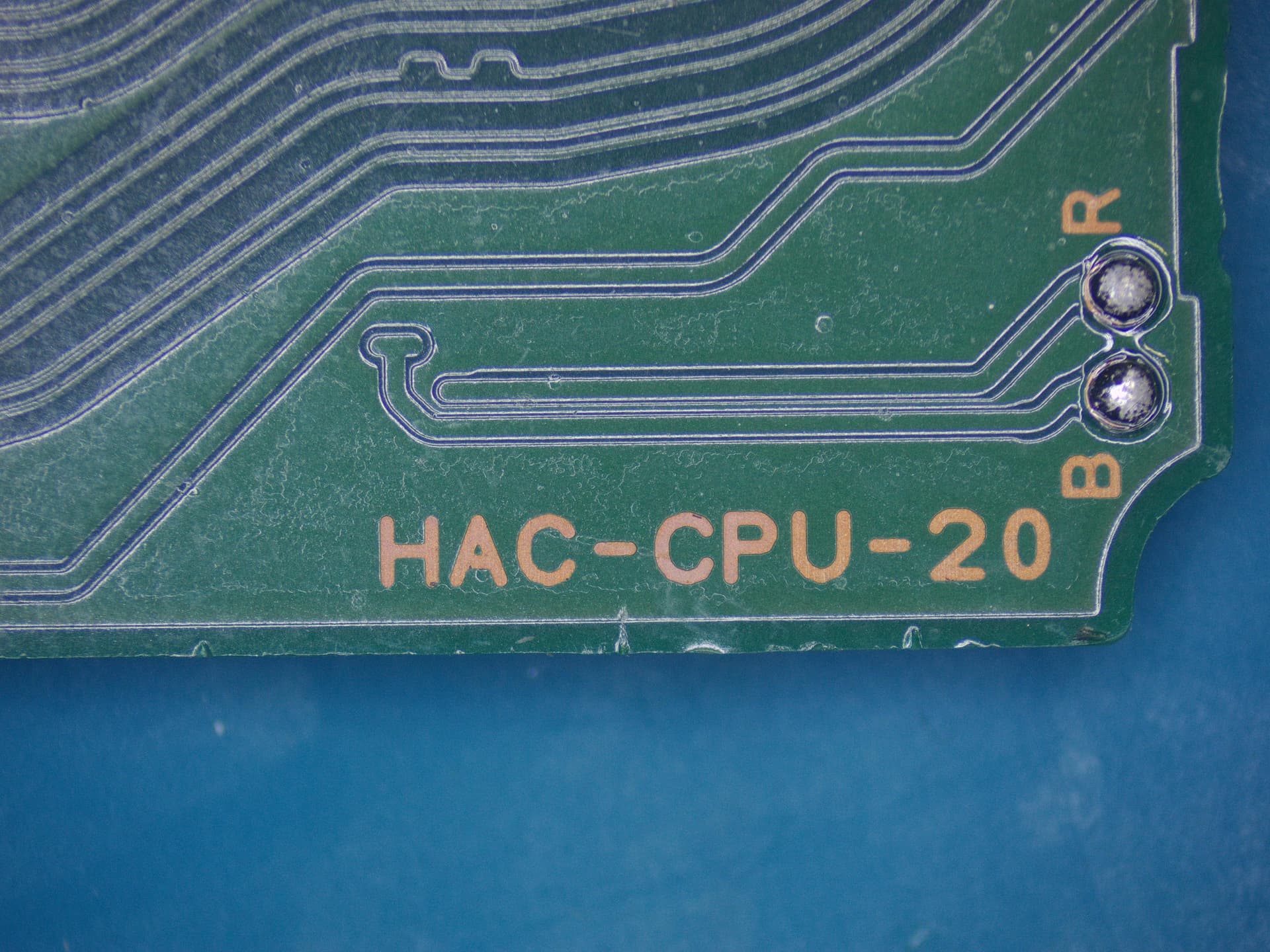

Currently, I have a switch that does not turn on, no switch logo , no backlight ,The Motherboard shows HAC-CPU-20,

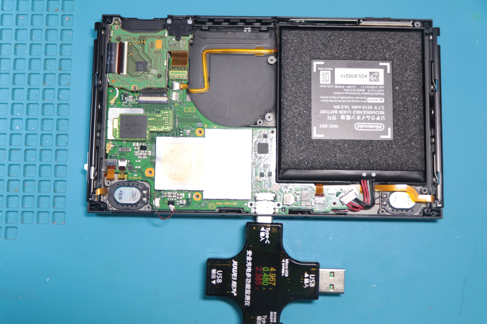

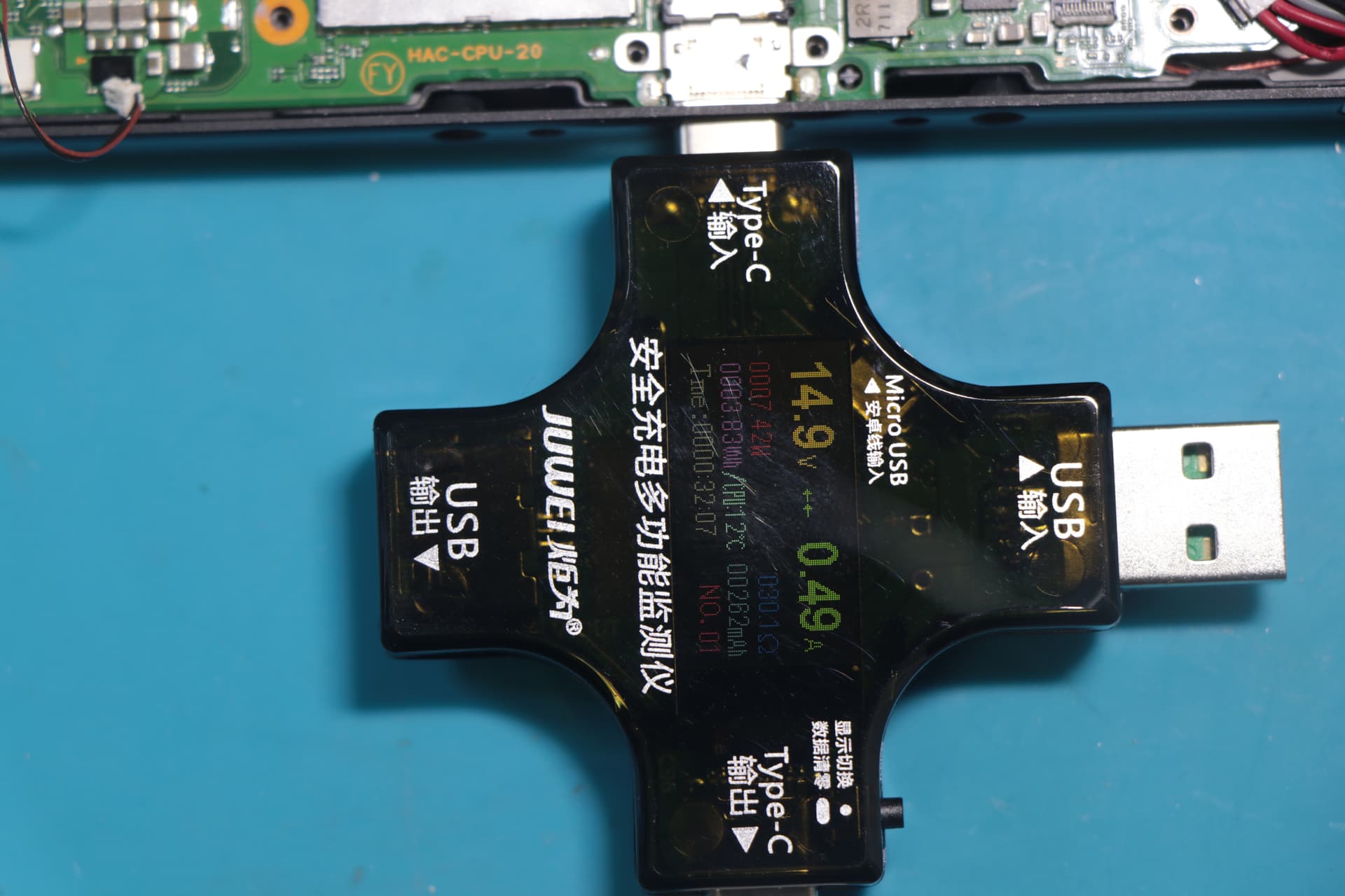

when I plug it to 5v power shows as below and stuck at 0.47A.
when I plug in the charger it shows 14.9v. and still show 0.49a as below:

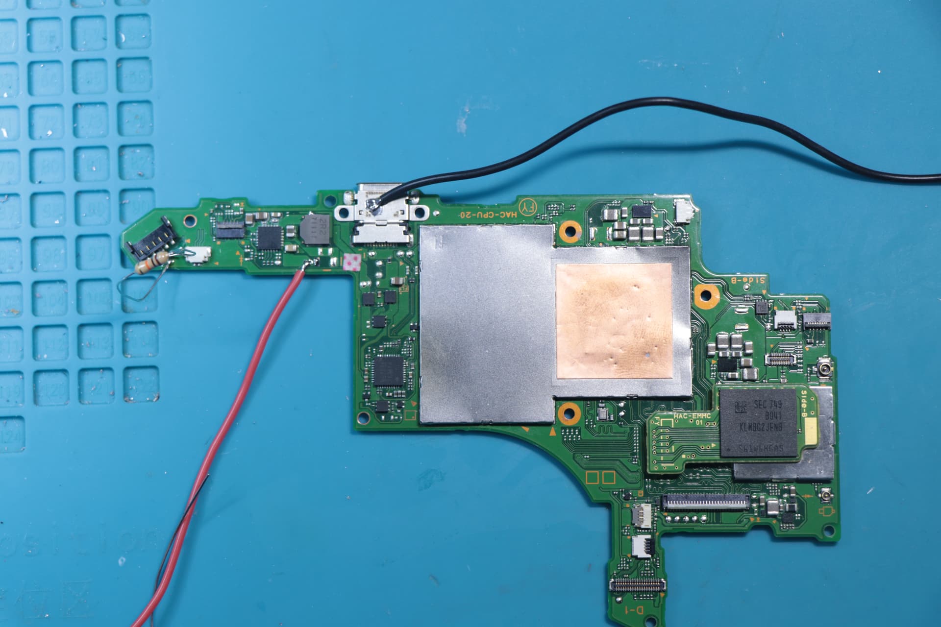

i soldered a 10k resistor between the battery connector as advised

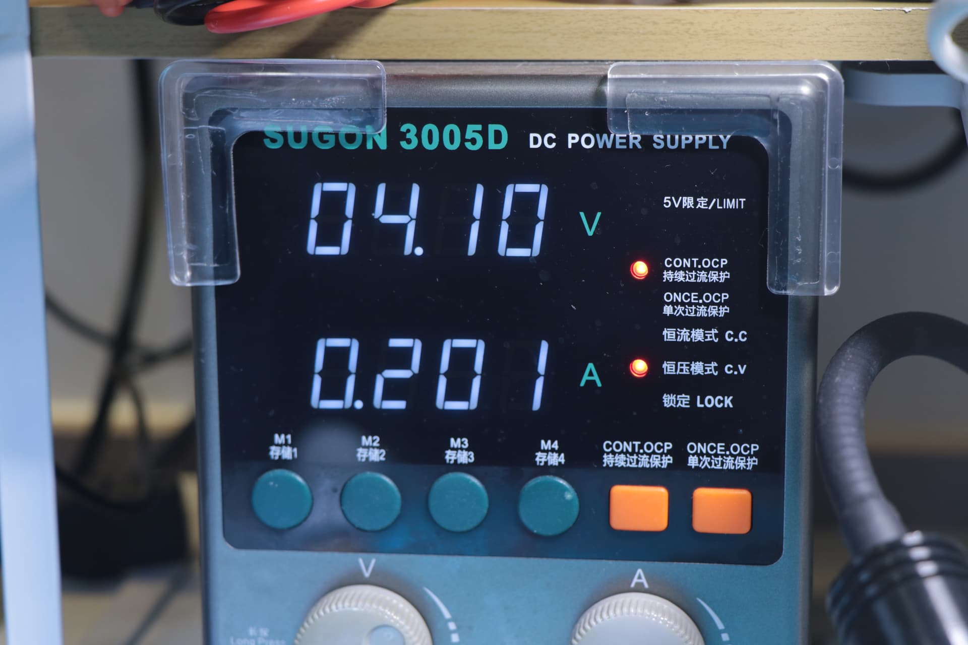

short the switch power on and stuck at 0.2a, I removed the emmc chip and do the same process and the amp still show 0.2a.

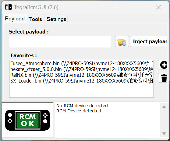

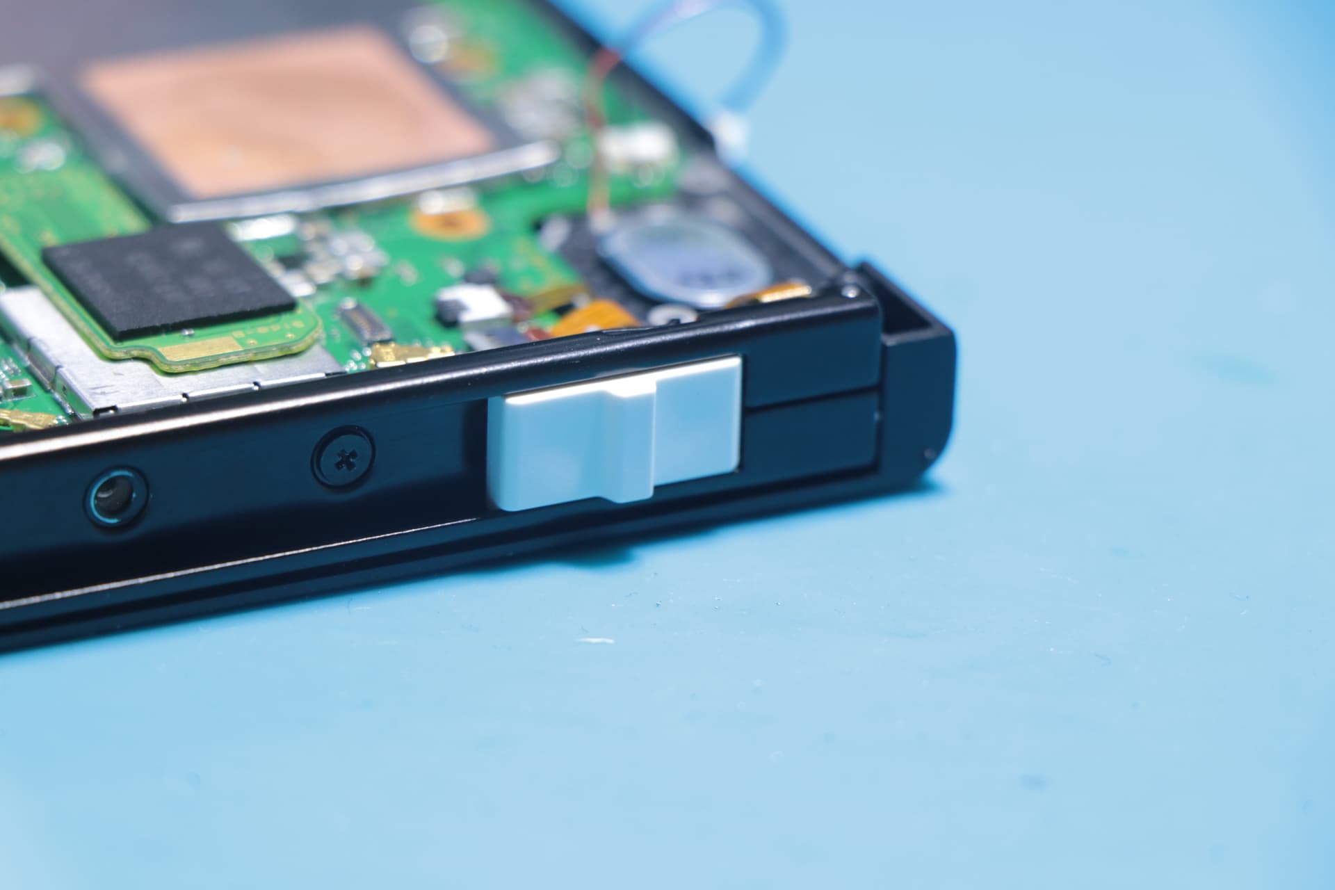

then I assemble the parts together and connect to the PC, and short the right slider as pics.

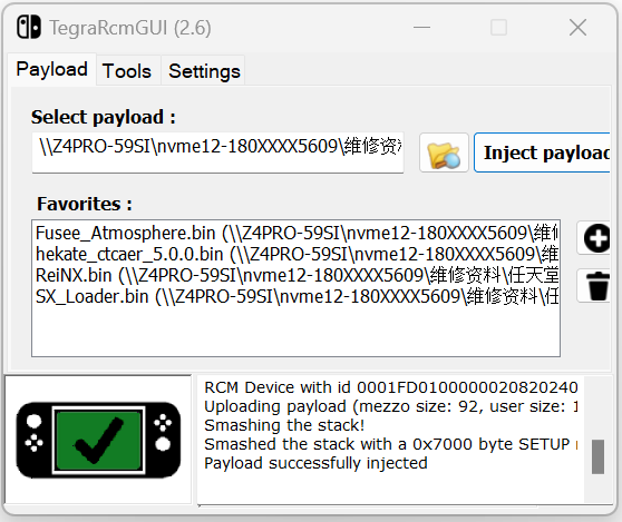

RCM was detected and also injected successfully as below, backlight works but nothing shows on screen.
RCM detected
RCM jinjected
now I have no idea how to go on…

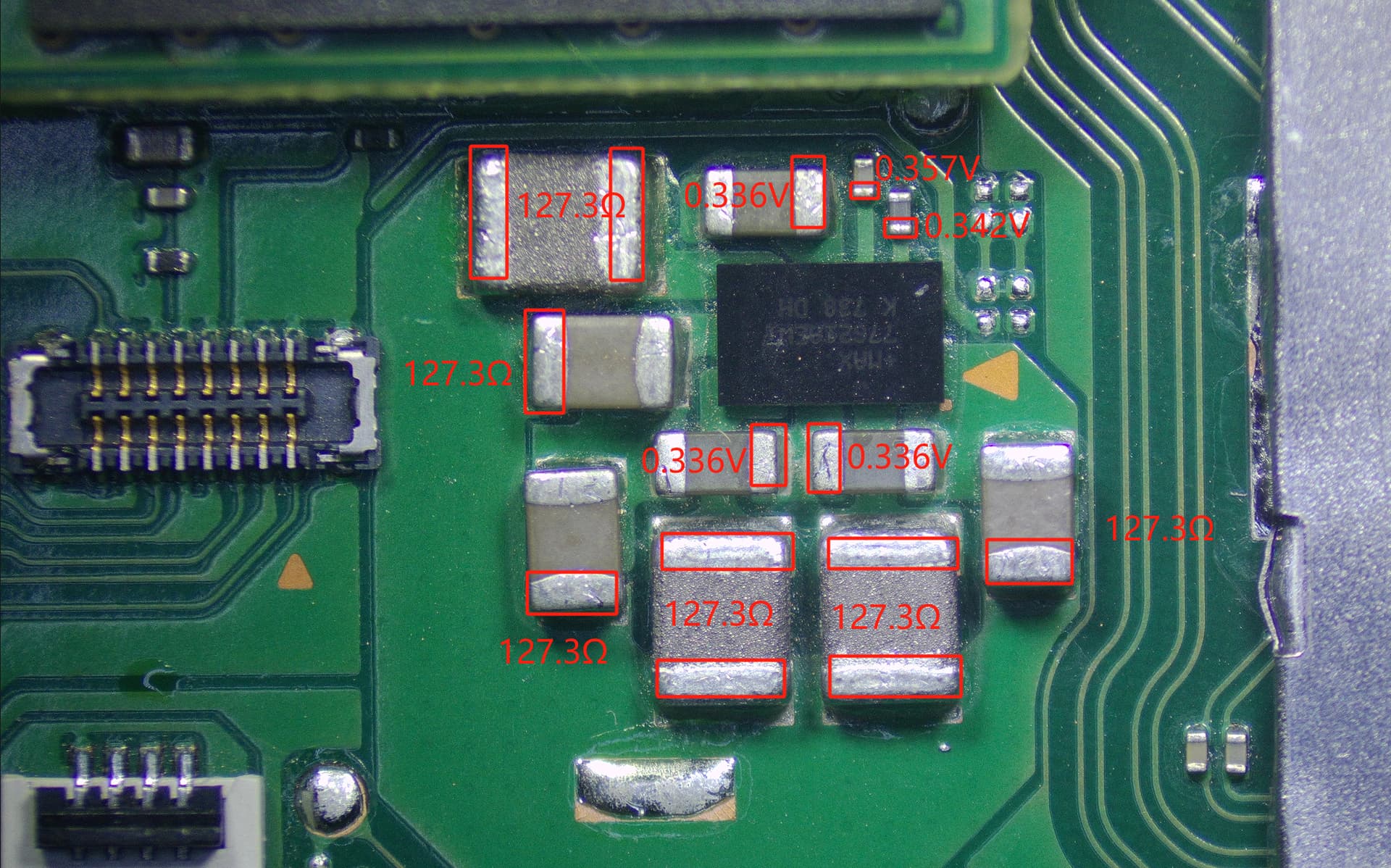

Is this value normal for the MAX77621AEW chip below emmc? measured by diode mode.

The message “Smashed the stack with a 0x7000” says the switch is patched I think, so you cannot inject anything.
