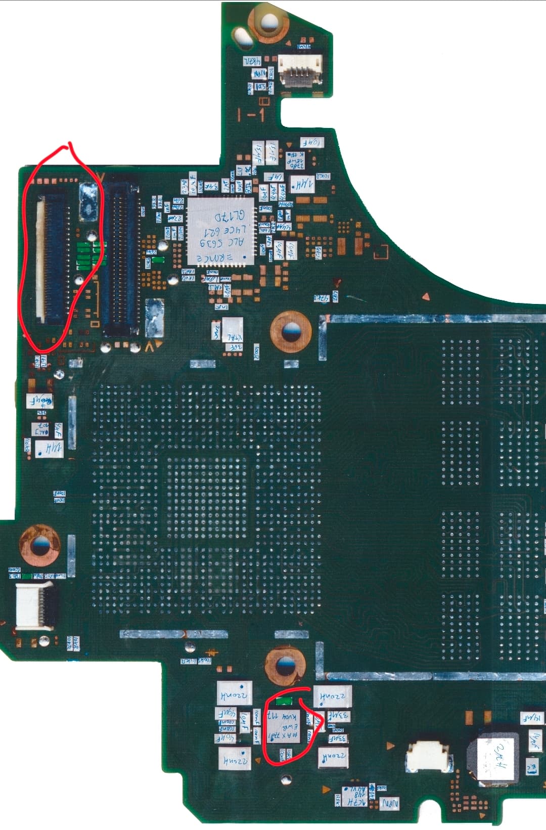

check if the max ic under the lcd connector broken
Hey, long time no see. Thanks for the reply by the way. Unfortunately, I don’t see a MAX IC under the LCD connector. The only 2 MAX IC’s I see “look” physically fine and are the ones I circled. Which one are you referring to and is there some diode checks you’d like me to do?

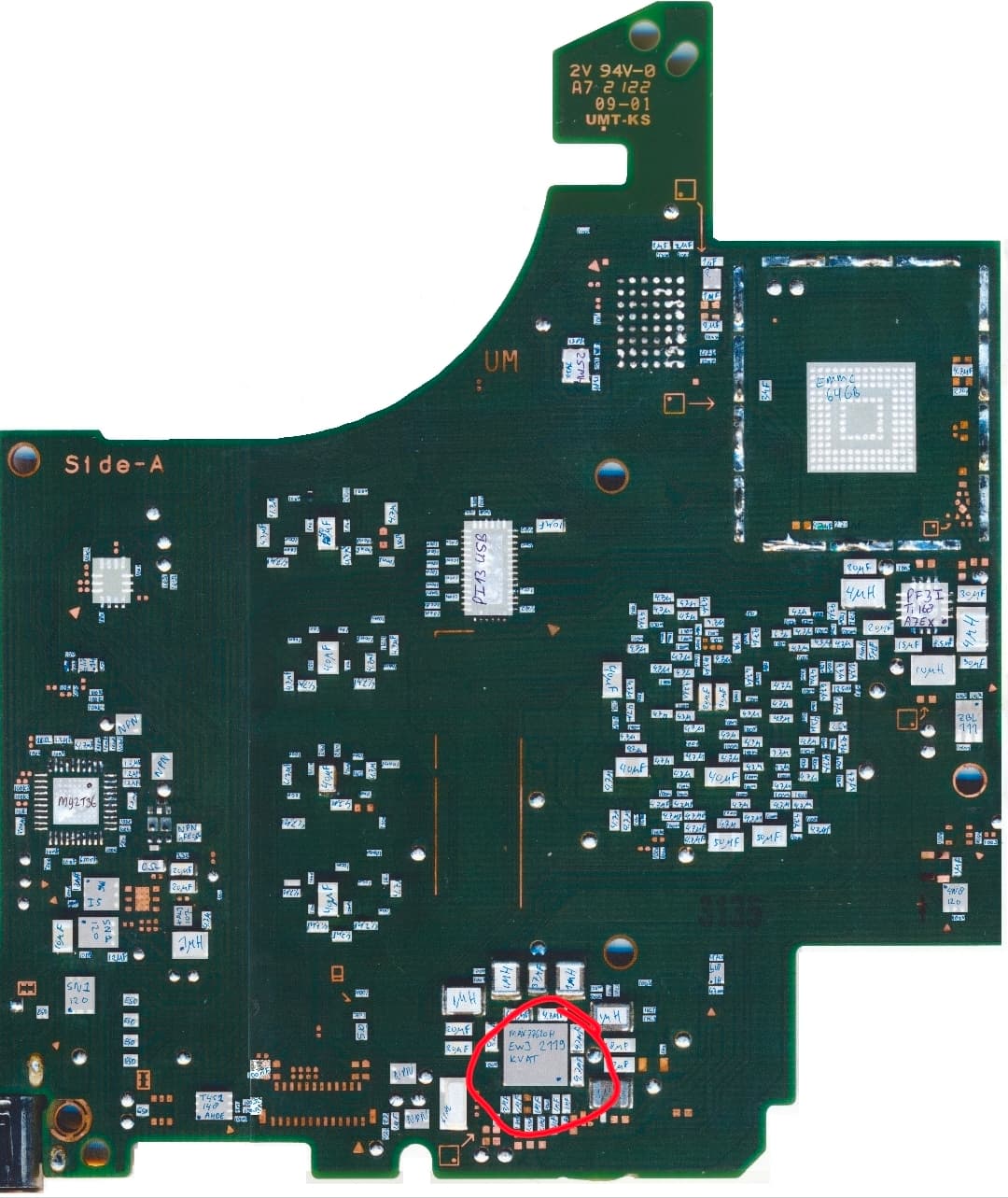

My bad, I meant the +ALJ/MAX8969EWL53 ic which is CIRCLE in red down below. It delivers 5v to fan and joycon charging
It looks good and I get a .488 diode reading on the large cap above it.
