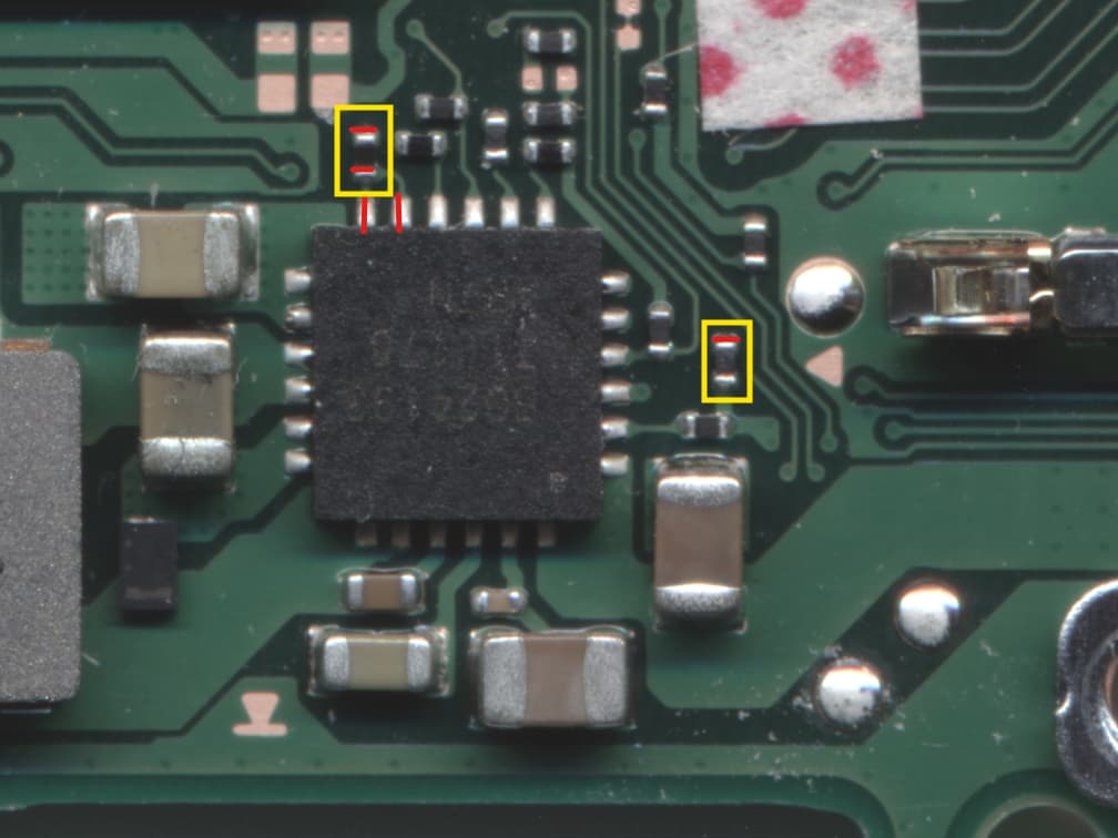

I purchased a Nintendo Switch OLED that is false charging (shows charging symbol but does not really charge)
I found some caps shorted next to BQ24193 so I replaced it and now the shorts are gone but it is still not charging.
I also found some shorts to ground that are not supposed to be shorted according to the readings I’ve got from a V2 switch.
Does anyone know the values of those resistors marked yellow? Also I marked in red the places where I found shorts to ground (TS1 and TS2 pins on the BQ chip)
Could the false charging issue be caused by that?
