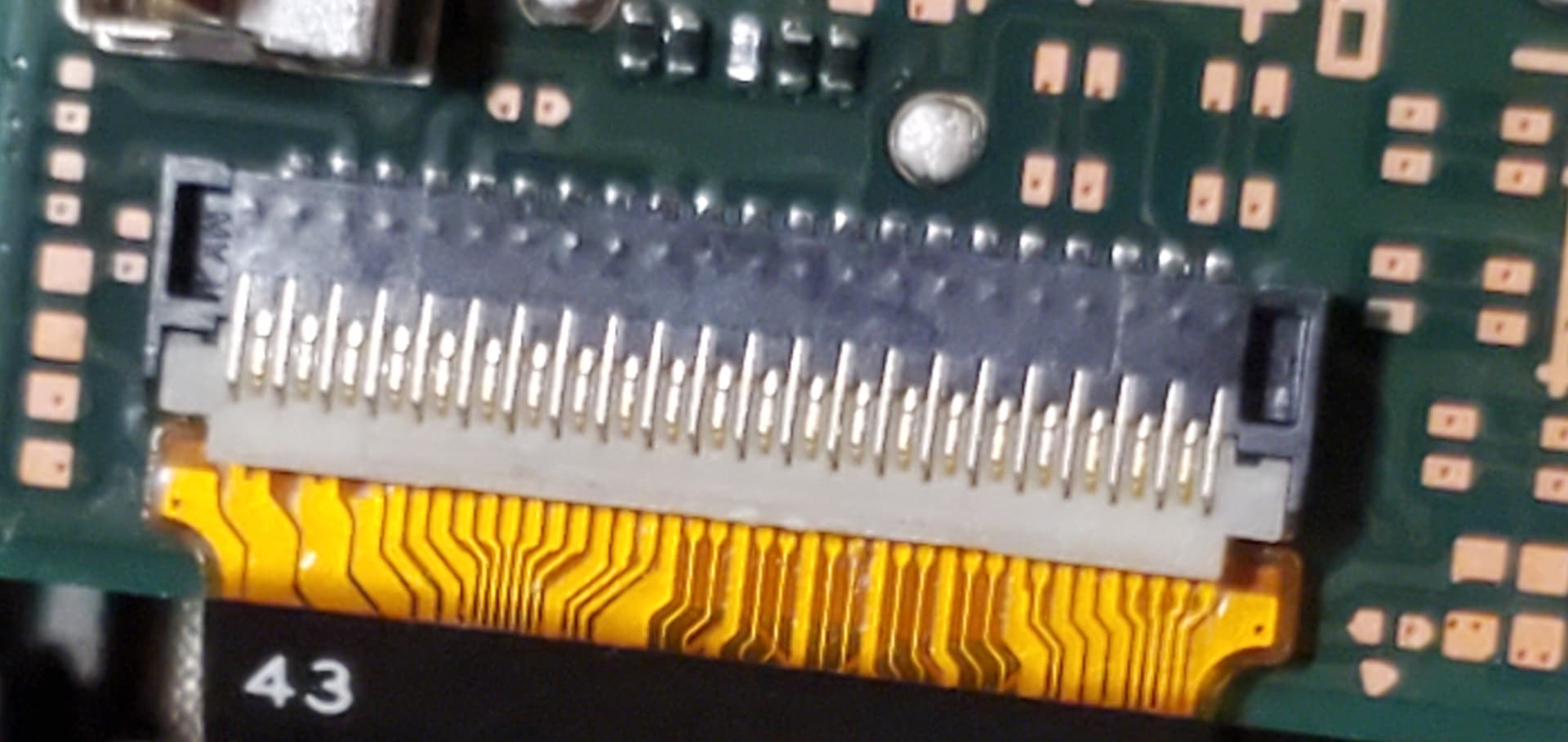

Fair enough! I don’t really have the console now for pictures as were I left it for fixing were trying one more time to check for any damaged capacitors tho the story between the 4 I talked felt a little off to me ^^;
But did took this one of the connector showing a friend I did connect it well

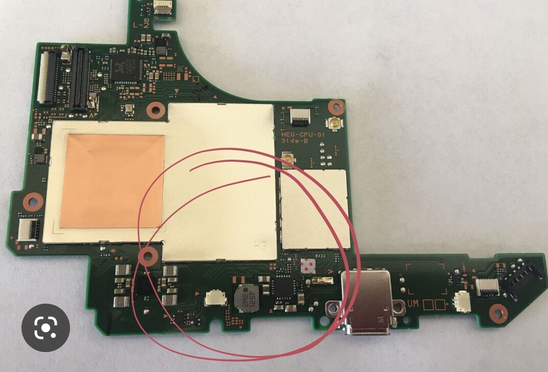

Yet when I plug battery in and hit power button, around area I circled on this internet image makes a tiny sound as if turned on but didn’t turn of despite my attempts at hard reset and what not ^^;
