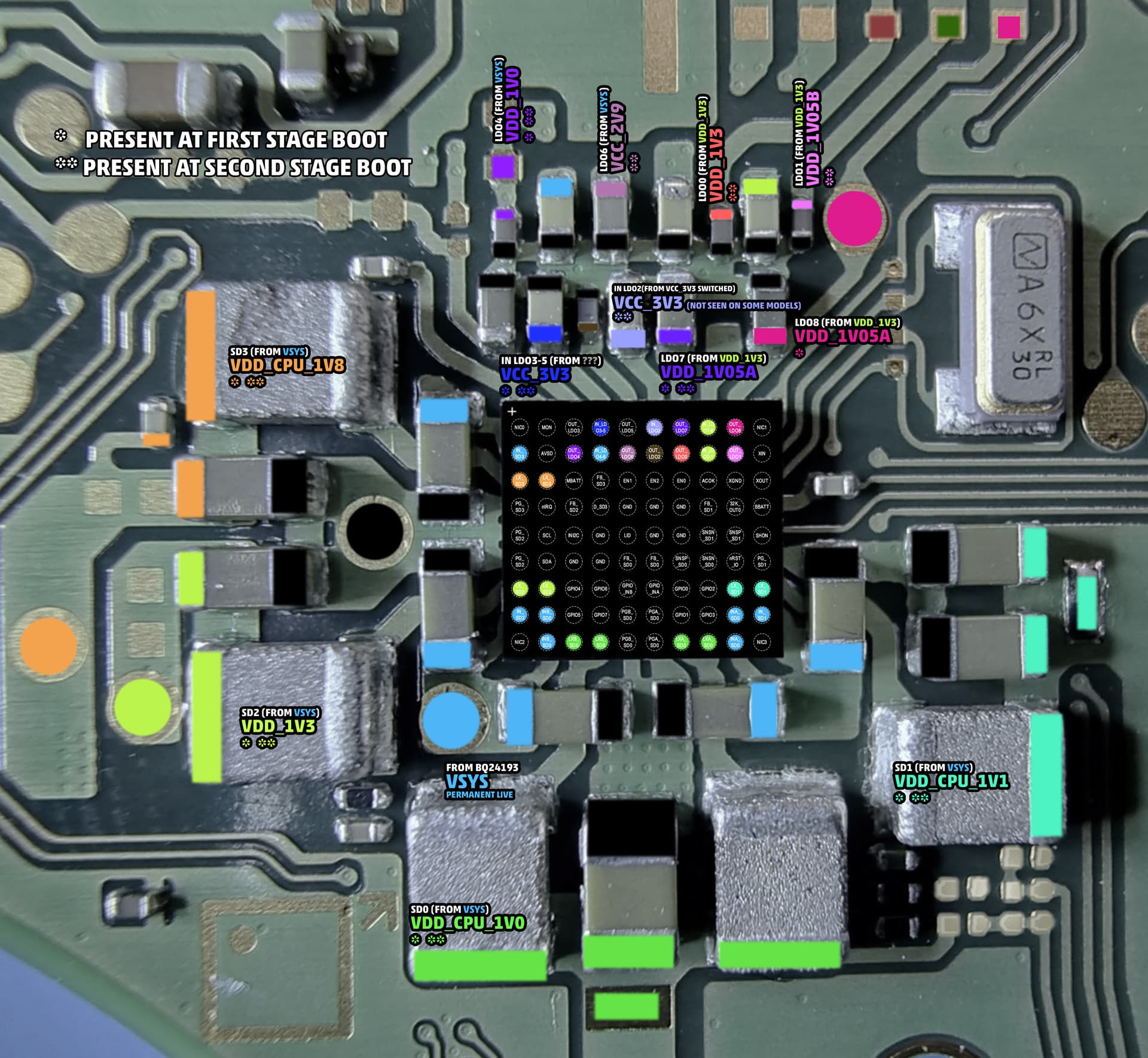

Install a wire to gnd and 2,2 Resistore and insert 4,2v to switch. No shorts, power on via button and measure the MAX 77620 chip and almost all rails have the correct voltage. Input is 4,2V
Only VDD_1V3 has 0 power, but should have 1,3V
See image.
Replace the Max chip with a good known chip, but got the same result.

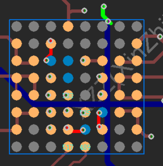

These line runs to the Max on the front site. MAX77621. (lines in red)
Any ideas. MAX77621 was not replaced yet.
