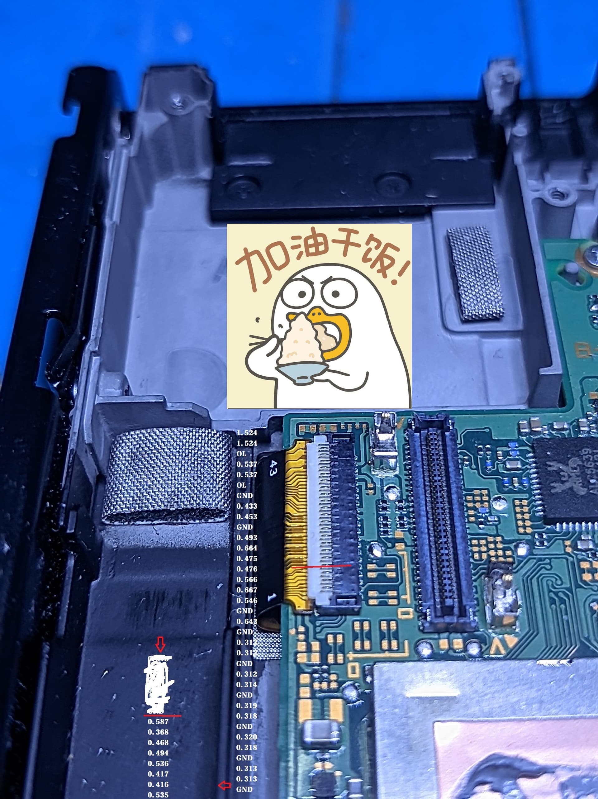

bro im not having enable signal for PF31 IC, maybe you have idea which signal came from???

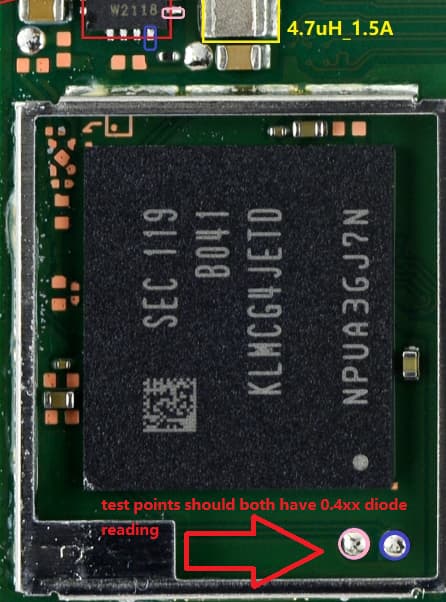

If your oled console been using dat0 adapter, check the emmc edge bracket ground point touching those 2 test points or not

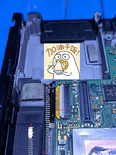

0.718 on pink line
0.480 on purple
So nothing wrong on your enable signal line then, maybe something else
does the board need to plug the screen to generate the enable signal from pin 8?
base here on schematic the enable pin is pin8 right?
It should be. What exactly stage your console having?
i have display on dock, and the touch is working i heard the sound when touching the screen,
Did you check lcd connector diode reading?
diode reading from my lcd connector is less 40 to 70 value than your sample
that’s reasonable and not far off the value, check the lcd cable if any dent or damage

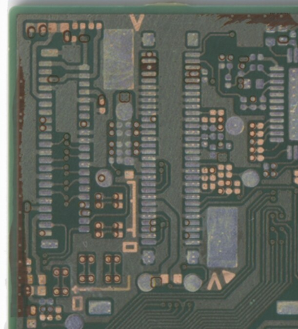

I had the same issue with the lcd and only touch. Press on the lcd connector during the oled is on and check for image on screen. I dont know why, but i removed the lcd original connector and hat some pads on the connector. I check the mainboard and the pads was still on the mainboard. My guess, the board has 2 layer of pads. Remove the lcd connector, try a new one.
thanks
red
If you check the layer scans for the oled, you can see that the pads are only at the first layer.
Hi Calvin,
Yes i know, but what is when the pad on layer 1 has 2 layers?!
