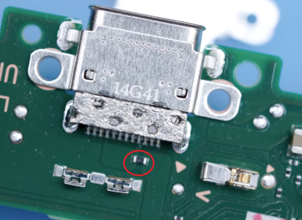

Hello,
replaced the usb Port and now pad 04 and 21 shows open line. where do those pads lead to?
thx
Not 100% how you count pins but based on the number, both pin4,pin9 and pin16, pin21 are Vcc for usb charge port, they all lead to fuse under the metal shield
