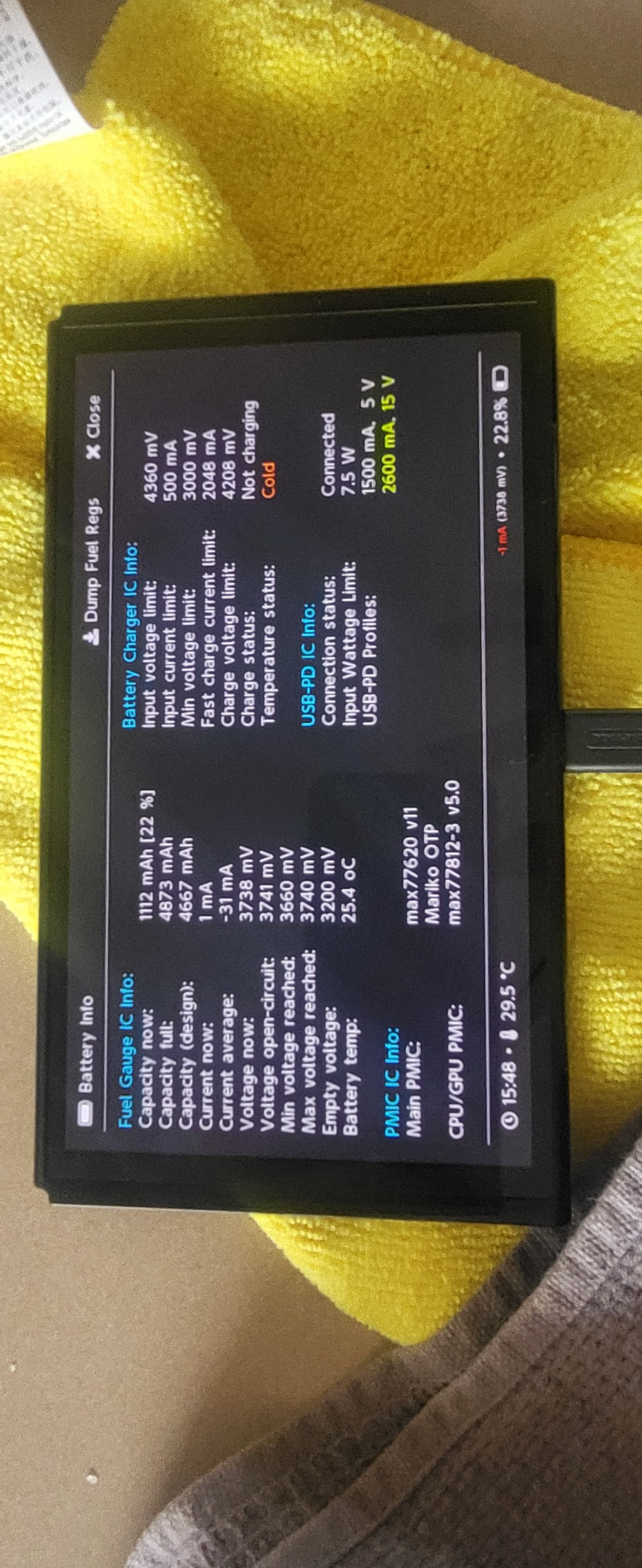

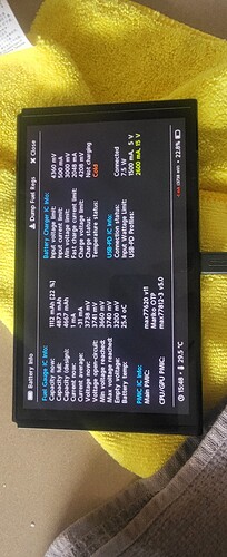

I decided to mod it so I could have a look at the charging info in Hekate. Everything listed for the Max IC looks normal and capacity is correctly listed. The only red flag is that battery temp is always listed as cold which I’m thinking is what stops the charging. PD profiles are also recognised as normal.

What could be the culprit as Ive said no shorts, no physical damage to components or traces and on a brand new console. I’ve attached pics of the battery info from Hekate.

The bq will stop charging if the battery temp is to high.
That the temp is showing cold while not charging is like expected.

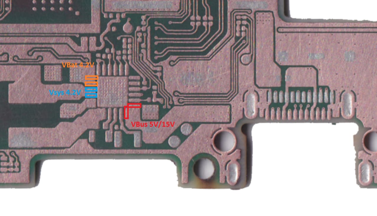

I would check that the 15 V are reaching the bq and if so, check that the VBat output at the bq has 4.2V while the charger is plugged.

Just as an extra piece of information the battery temp shows as normal until the charger is plugged in and then changes to cold. Not sure if that is relevant.
So the vbus is getting 15v but the vbat is only getting 2.8v and 3.2v.
Does this suggest a problem with the bq chip?
If a charger is plugged in, vbat should show 4.2V (charging voltage → battery)
I guess your battery has 2.8V, if measured unplugged to the board.
