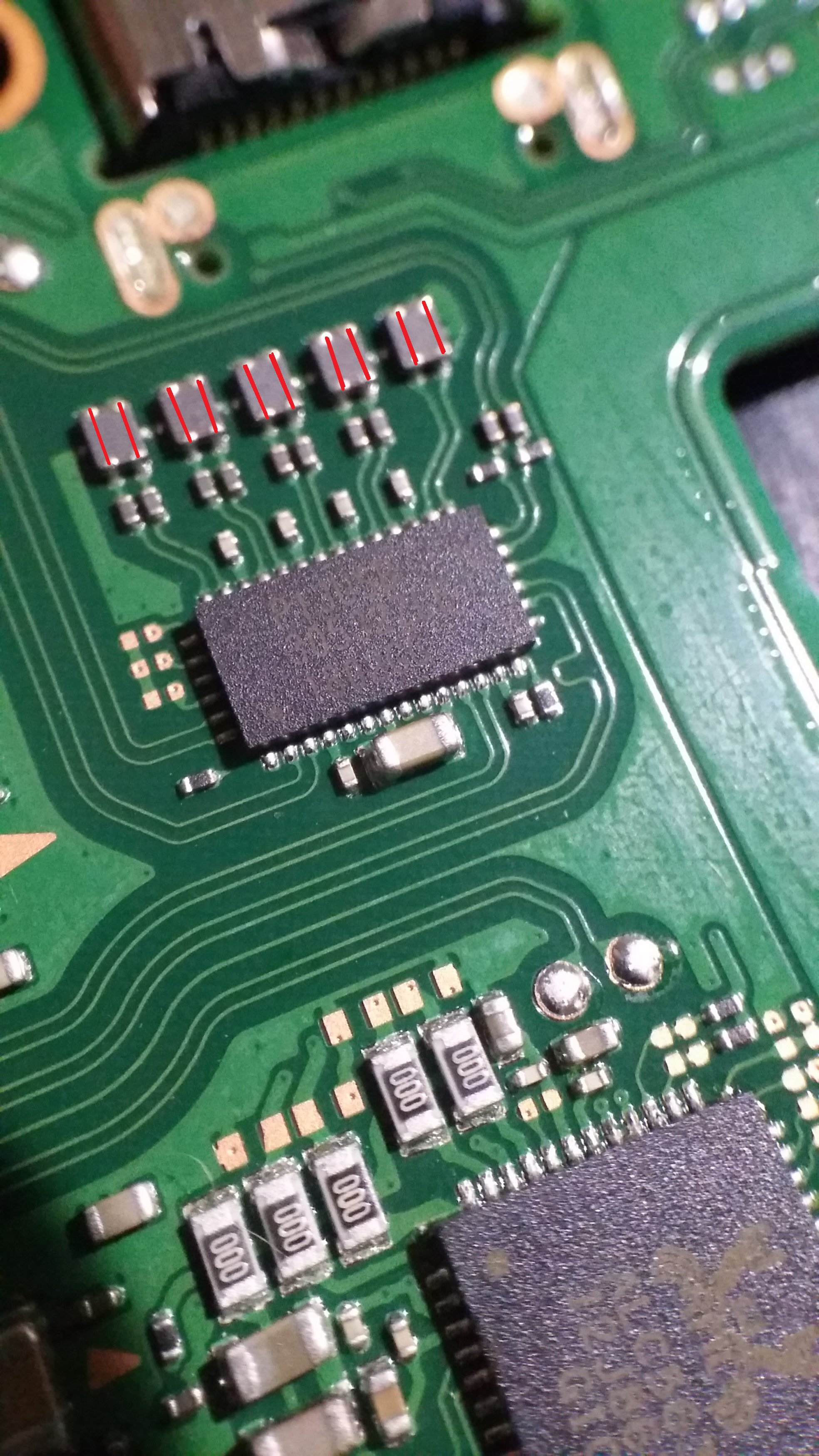

Switch Only Works In Dock
M92T36 - check with the multimeter in diode mode pin 5 and 6 vcc. Plug in to charger. Between 3 - 6v, power detector working, Chip likely to be Ok
P13USB - check with the multimeter the filters running to the Pi3usb just above the usb port you should have continuity on all of them.
