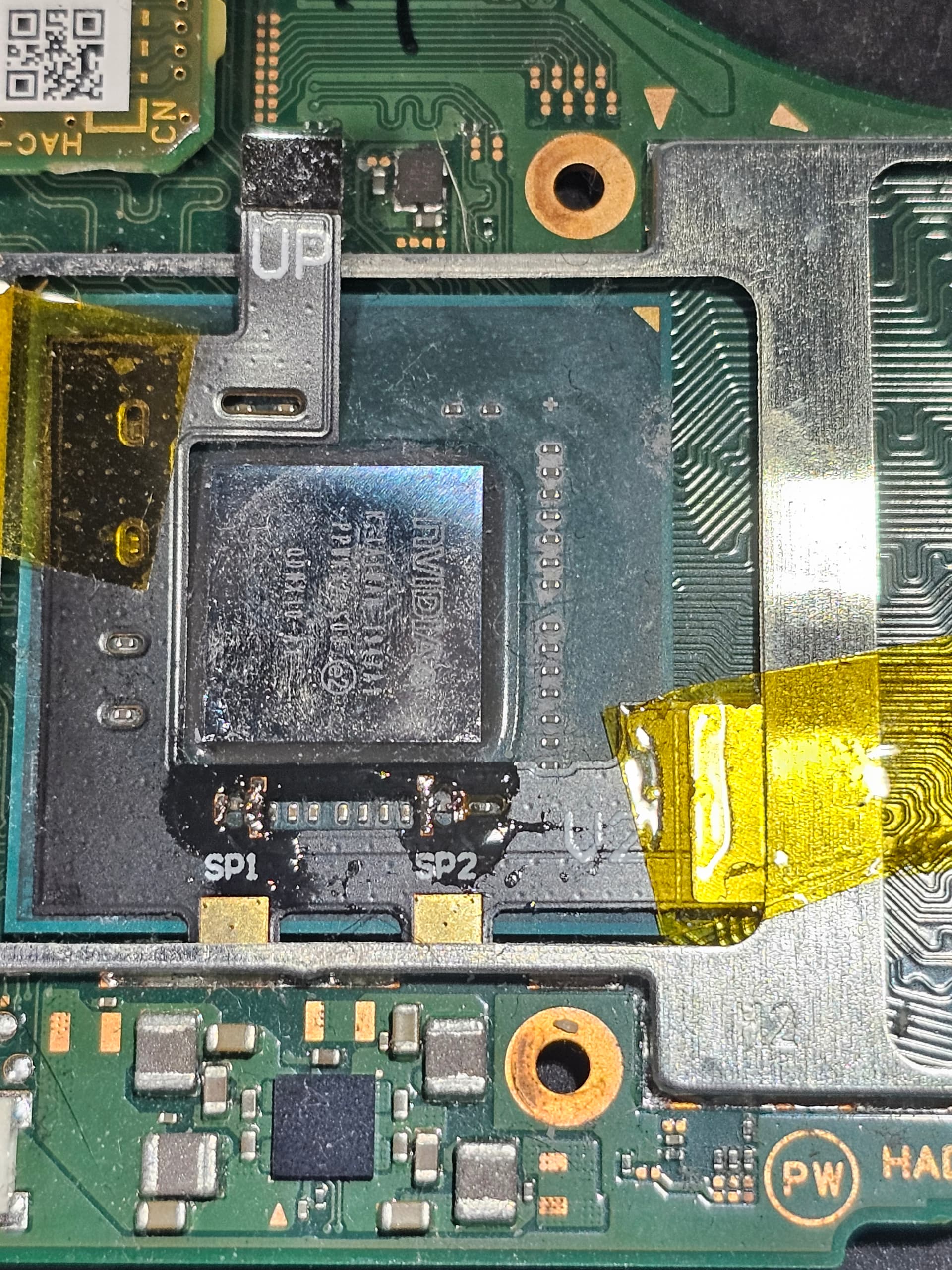

This is my first attempt at soldering and first PicoFly install. Does this look OK? I also ended up with a bit of solder on the wrong capacitor but it isn’t bridging anything from what I can tell. Should I still try to get it off anyway?
That looks like it should work. I’m a little more anal about how things look myself, I would add a little more flux and try to re work those sp1&sp2 joints to where they look a little better, but that’s just me. You may not be comfortable with doing much more that you already have and that’s fine. The hardest part for me is the clk point. Getting it tinned for some reason really kicks my butt. Try not to hold your iron on any spot very long. Flux and a clean, tinned tip and some small taps goes a long way!! Good luck!!
