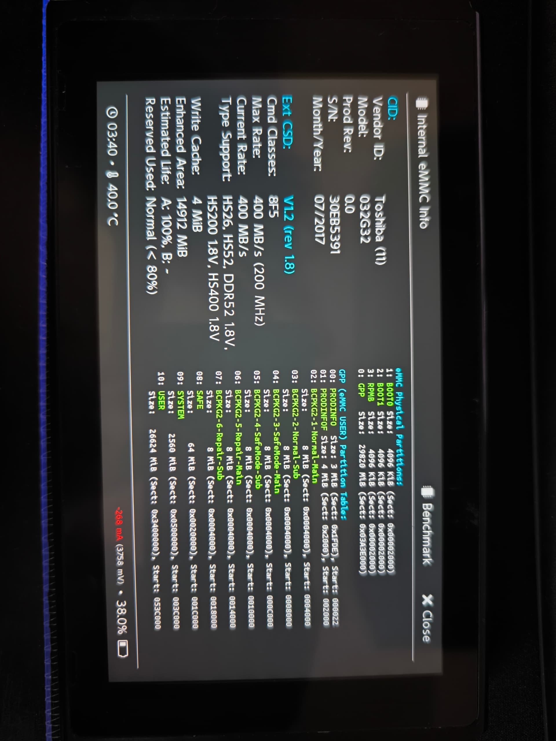

i think that the problem is emmc or mainboard because don’t boot on nintendo logo without picofly. i try to install a picofly later of black screen and with my surprise the console boot hekate but don’t run ofw or other. if i want to search a problem in a mainboard or emmc which is the control that i do?

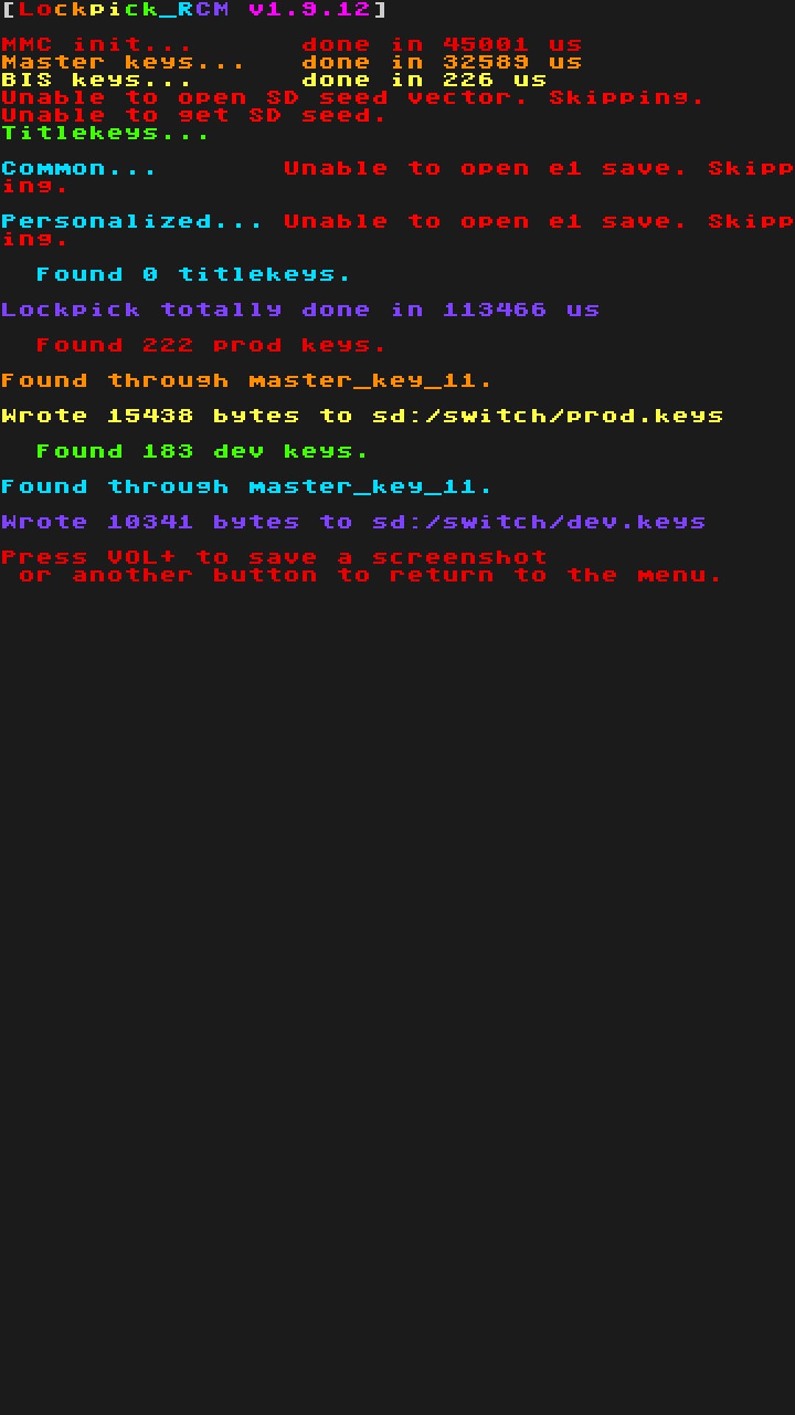

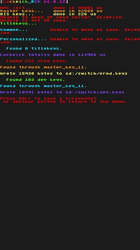

Emummc from another Switch won’t work - you can try to read the keys via Lockpick_rcm - if this is not working I guess the mmc is faulty.
