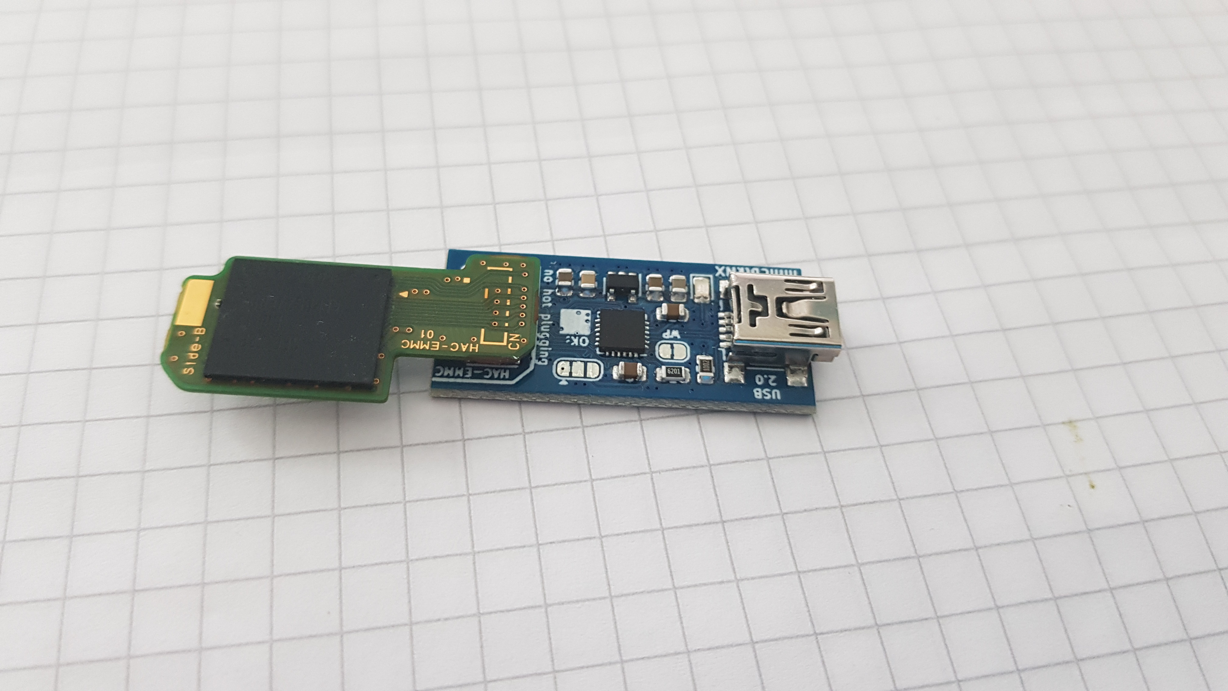

Just arrived and also the solder balls you recommended. A lot of things for the evening :wink:
Cool, Mine also showed up the otherday, haven’t had a chance to test it out yet.
