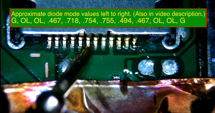

Is there any diagram where are the test points to test continuity after i replaced USB-C port to be sure everything is ok ? (for both rows) Because based on diode mode values picture i found somewehere i have some different measurements. Thanks for any help.
Maybe that can help you…
