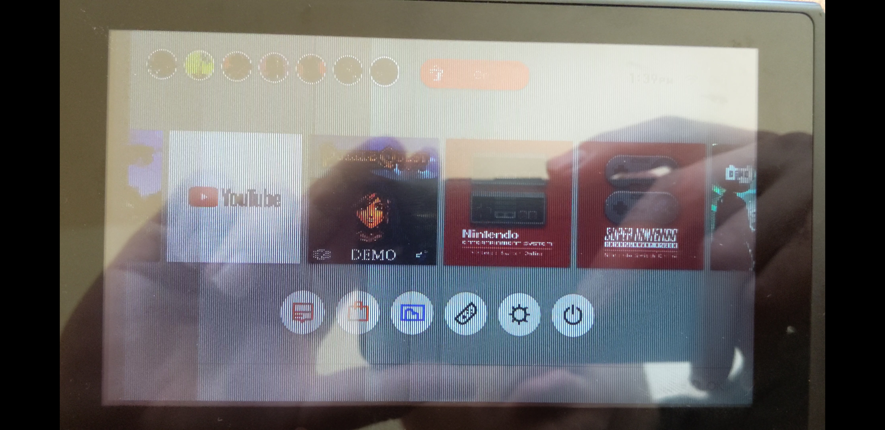

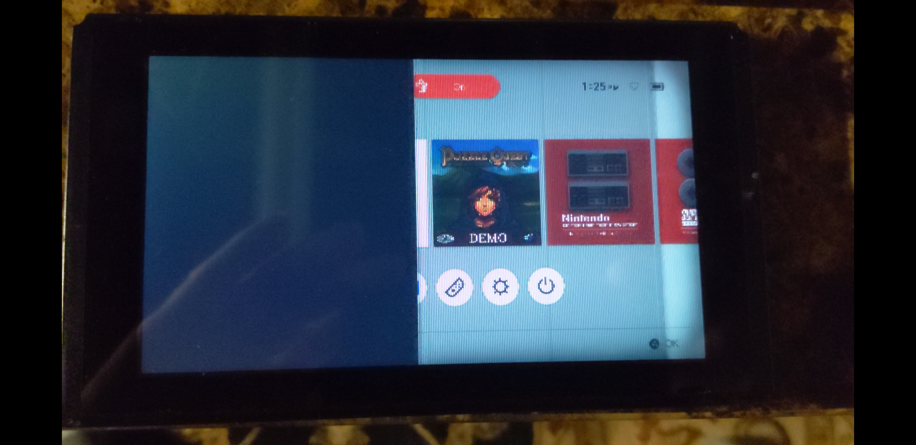

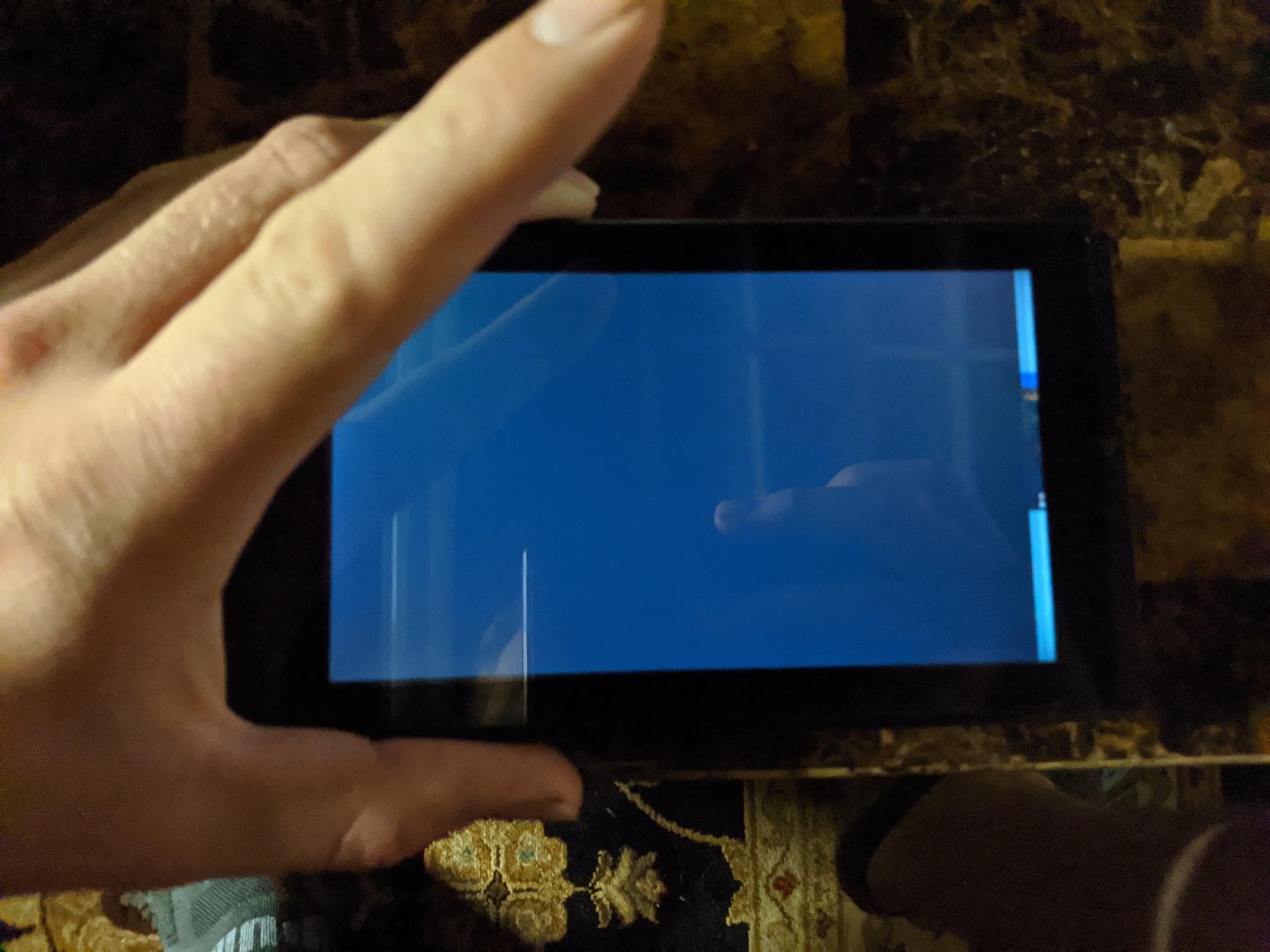

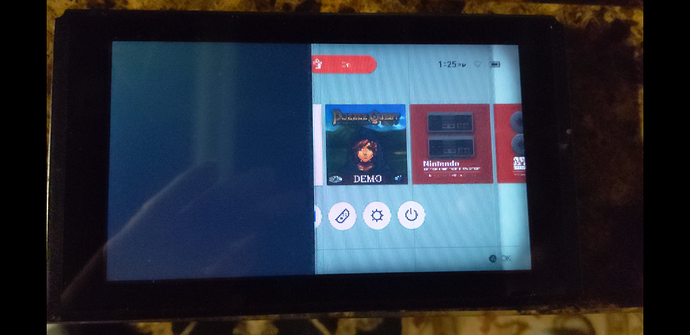

Hi all, first off I’ve been a lurker for a while, both over on YouTube and here in the forums. I have a switch that I did a charge port replacement on and initially got power with no display (backlight turned on). I could hear stuff happening when I touched the screen and there actually was a small band at the right side of the screen that I could make out icons scrolling past. It was only about a mm from the edge and very very dim. I inspected the cable and connector under a microscope and didn’t see any issues. I decided to try replacing the LCD and unfortunately was met with another issue. When I first turned the switch on, there was nothing on the screen, however after letting it sit for a while, the display started to come on from the right. It started as only one small band and slowly grew to displaying most of the screen, albeit poorly. Has anyone experienced anything like this? Thanks in advance for any and all help.

I can’t positively confirm the replacement was good, however I can say that I tried 2 new displays and both exhibited the same issue. The problem looks to be on the board.
