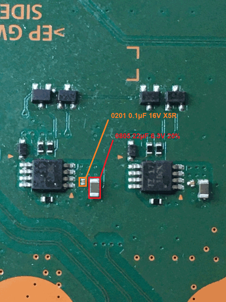

Where can I buy these capacitors?
One of them is clearly cracked. I have an EDM-020 board and need to buy replacements. Thanks
Sorry, it won’t let me post pictures.
The caps right by the USB IC - to the left of the black 8 pin IC, near the part of the board where the USB ports are physically located.
Thank you! This was a huge help
