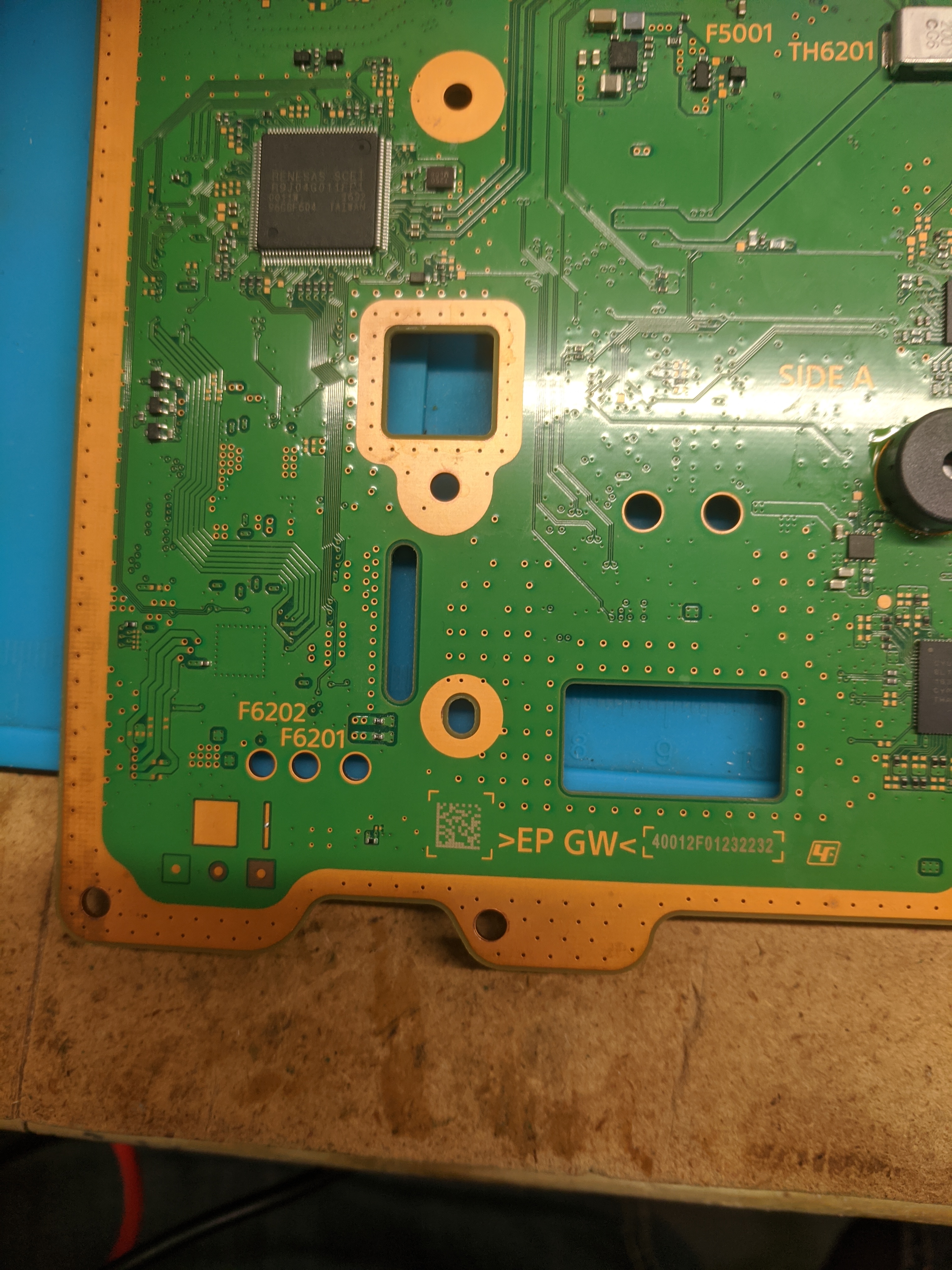

Amazingly enough I was able to fix my issue and turns out it was not a software issue as I originally thought it was but I had two blown fuses in the drive controller area, fuses labeled F6201 and F6202. Mine is a PS4 Pro but I had a spare broken PS4 slim that I was able to grab the fuses from and once I fired it up and it was a sweet site when it took the disc. Hope that helps!
