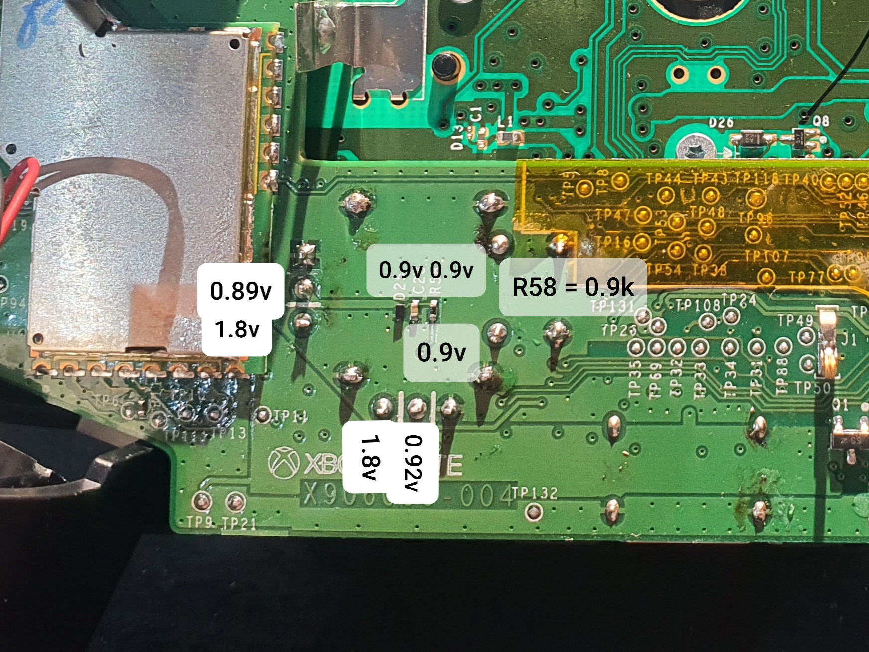

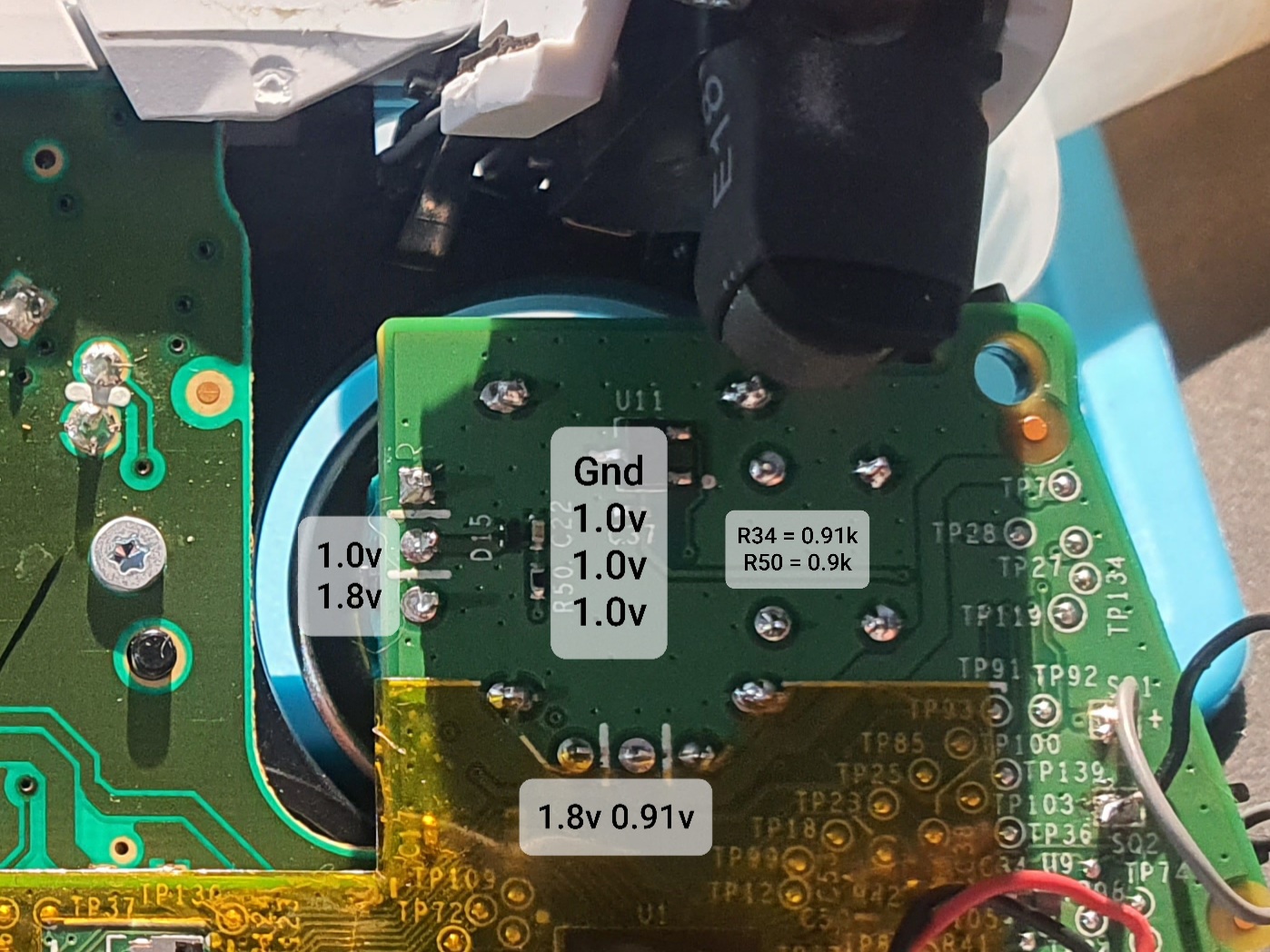

Wondering if anyone has had an issue with elite pads drifting and after replacing the analogue sticks twice it is still off center.
It seems the values are off ever so slightly on the left hand stick.
The 1v should be 0.9v, not sure where I should now be looking but it’s effecting two pads.
