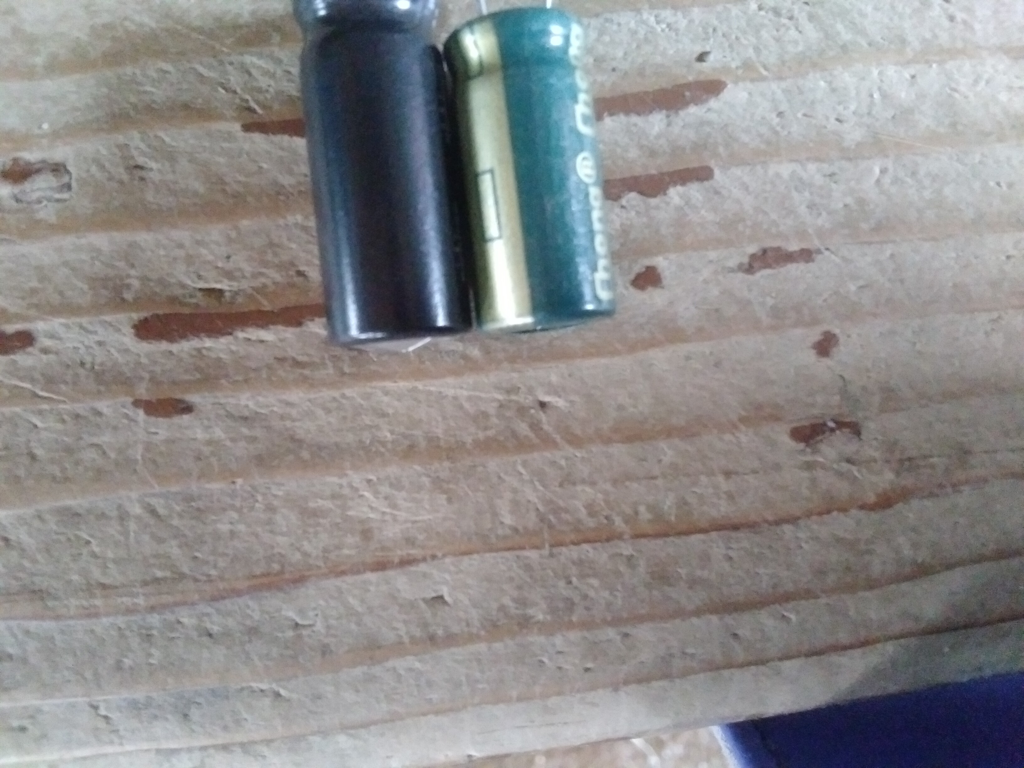

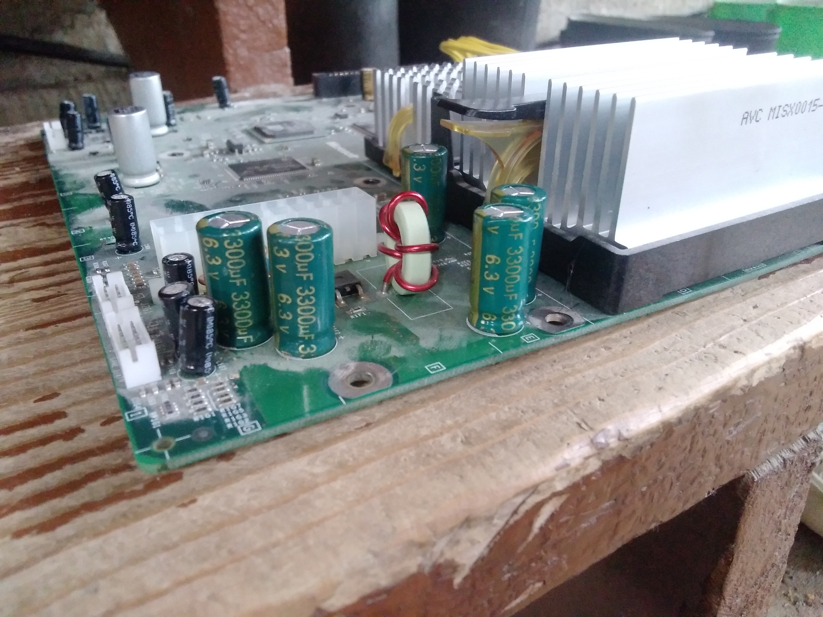

Yes, it was indeed the capasitors, I bought 5 3300mf 6.3v for the version 1.6 xbox, it took a while, had to figure a few things out before shipping it, but yes, it works now, thank you so much for telling me this was probably the problem, it totaly was. Those bulging capasitors needed to be replaced! Now I can continue playing NFS Most Wanted on my old save. I hope this helps people who may have the same problem. I have some pics too
The black capasitor is one of the old ones, and the green is the new one. There is a bulging top on the old one, a sign it was the power issue.

This is where I found these capasitors and replaced them. All 5 of those green capasitors were replaced, because all 5 of my capasitors were bulging. I got the replacements on Amazon, and I got 10 for like 15$😂 so I have more replacements if I have other original Xbox’s version 1.6 with the same issue.
