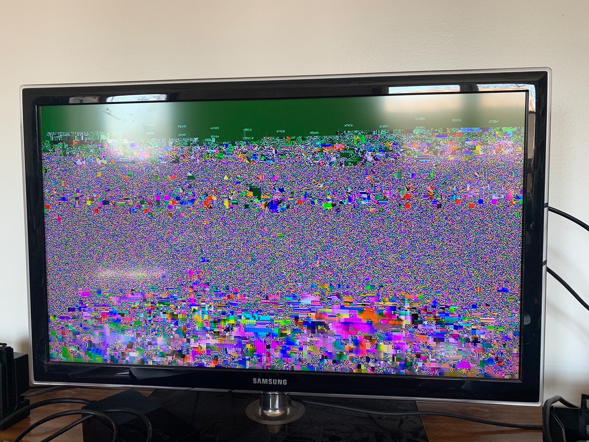

I’m working on a Xbox One 1540. I’ve replaced the HDMI port, as that was clearly bad. However, now the TV recognizes that something is connected thru the HDMI port, but still no image is displayed. I’ve checked the filter and nothing there seems to be the problem. Does anyone have any idea where the issue could be?

upload a picture of the work done with hdmi port…
have you checked continuity on EG8B1 and EG8B2? also make sure there are no bridges on port pins…
The filters have continuity and nothing is bridged, neither the filters or the HDMI port.
I’m wondering if maybe I’ve just gotten unlucky and have replaced the port with two faulty ports.
