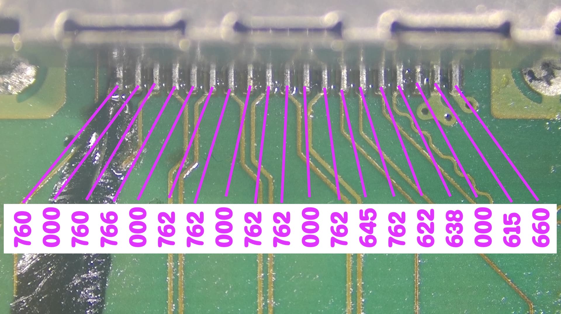

Water damaged Xbox Series S that powers on fully but has no display, I’ve replaced the port and the encoder and get the following diode readings:
I’m mainly wondering if this is correct, I see that my results match closely to the One S but from a post I saw with the tail insertion tester results, pin 17 isn’t shown to be ground. If anyone has the correct values for this device so I can compare, or otherwise any other advice about it, it would be greatly appreciated!
