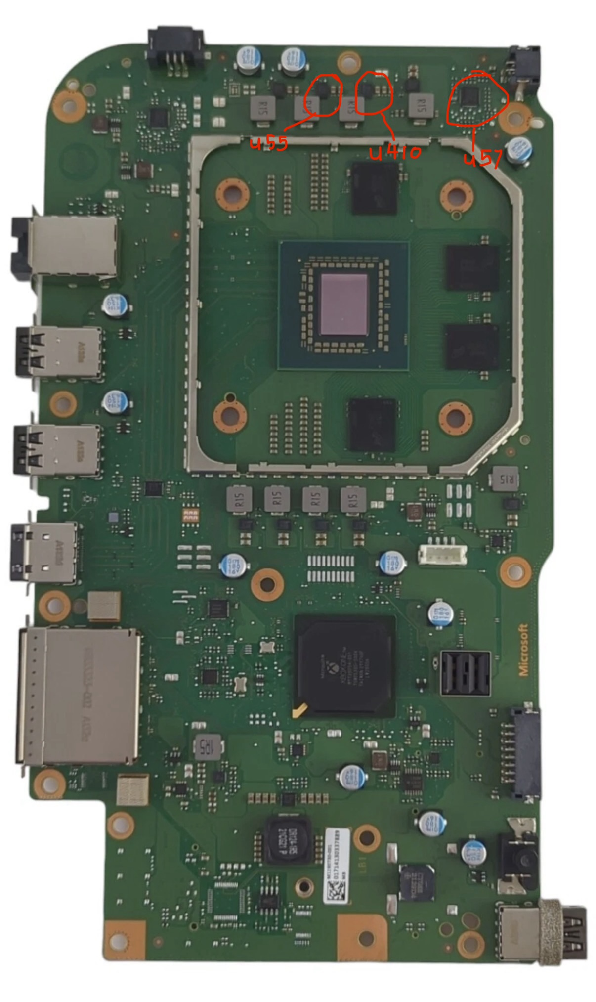

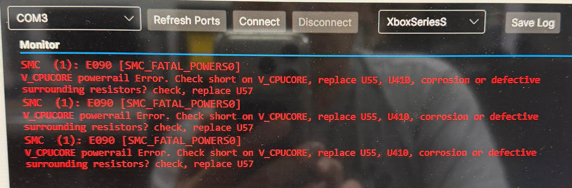

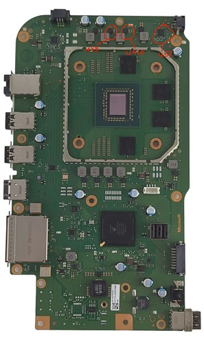

Hello everyone, I need to confirm where these components are. My board doesn’t have the screen printing on it. I looked at a spare donor board an it was a little different. I’m looking to replace U55, U410. Those were the 2 the code said was bad. I added a picture of the board and circled it. If anyone know or can point me out where to find a board diagram. That would help a lot Thanks in advance
