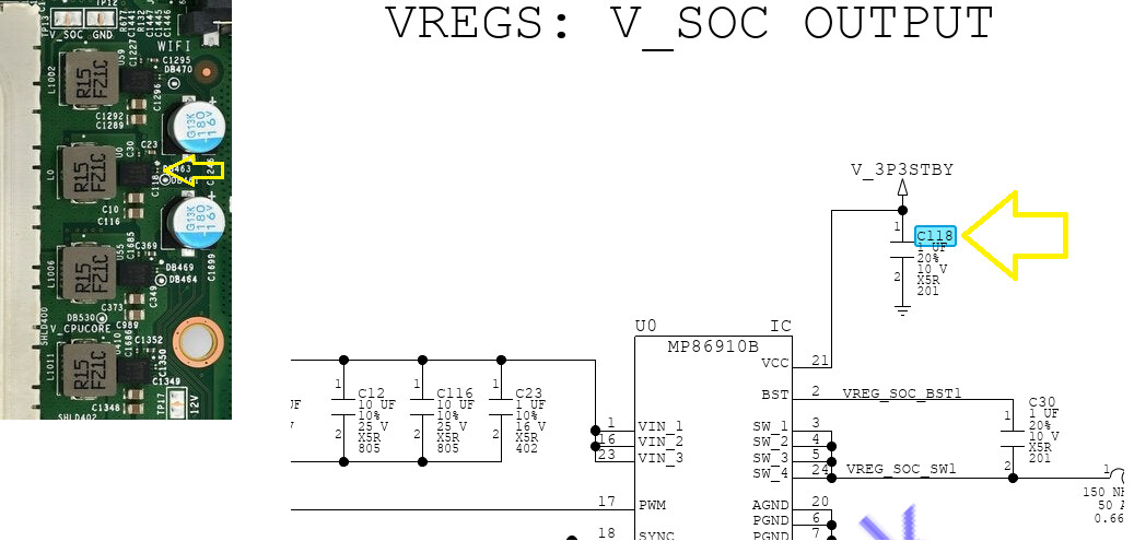

Hello new to the site. I have a series s that has no power no beep. Power supply is good but looking under the microscope i found a blown component but not sure what it is. Its a cap or resistor next to the mosfets on the power button side of the mobo. Between the edge and the apu any help identifying it would be greatly appreciated. Heres a link to redit post for a picture of the component
Seems like the c118 cap on 3.3v standby rail. You probably need to check if any short on 3.3v_stby
It would actually be the c349 but that was just a pic i was able to grab off a video that showed the best view of the component. I appreciate you pointing me in the right direction. I assume that would.be the 3.3v rail also
Also where can i find the schematics unfortunately im not home at the moment to get a board number off mine not sure if that matters though
yes, same spec on same 3.3vstby rail
