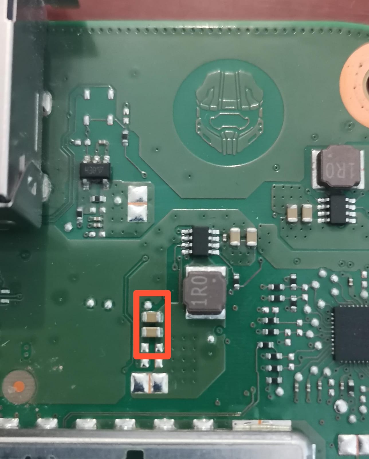

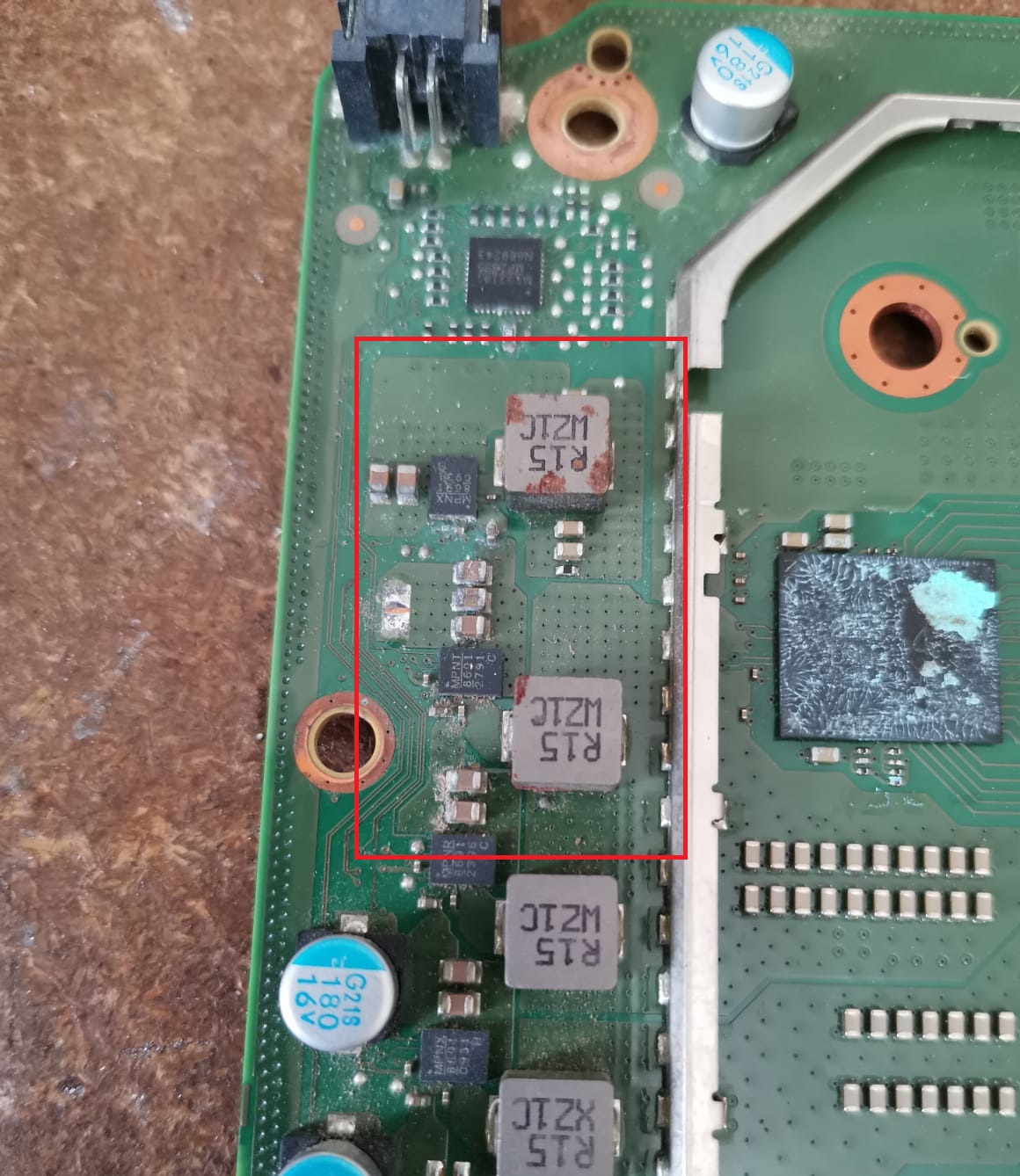

I found signs of corrosion in the area shown in the picture:

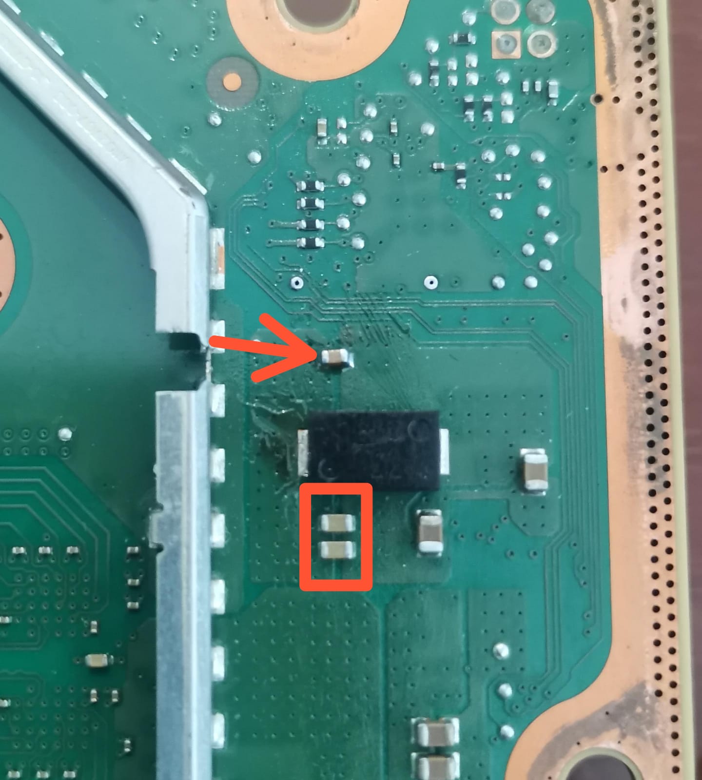

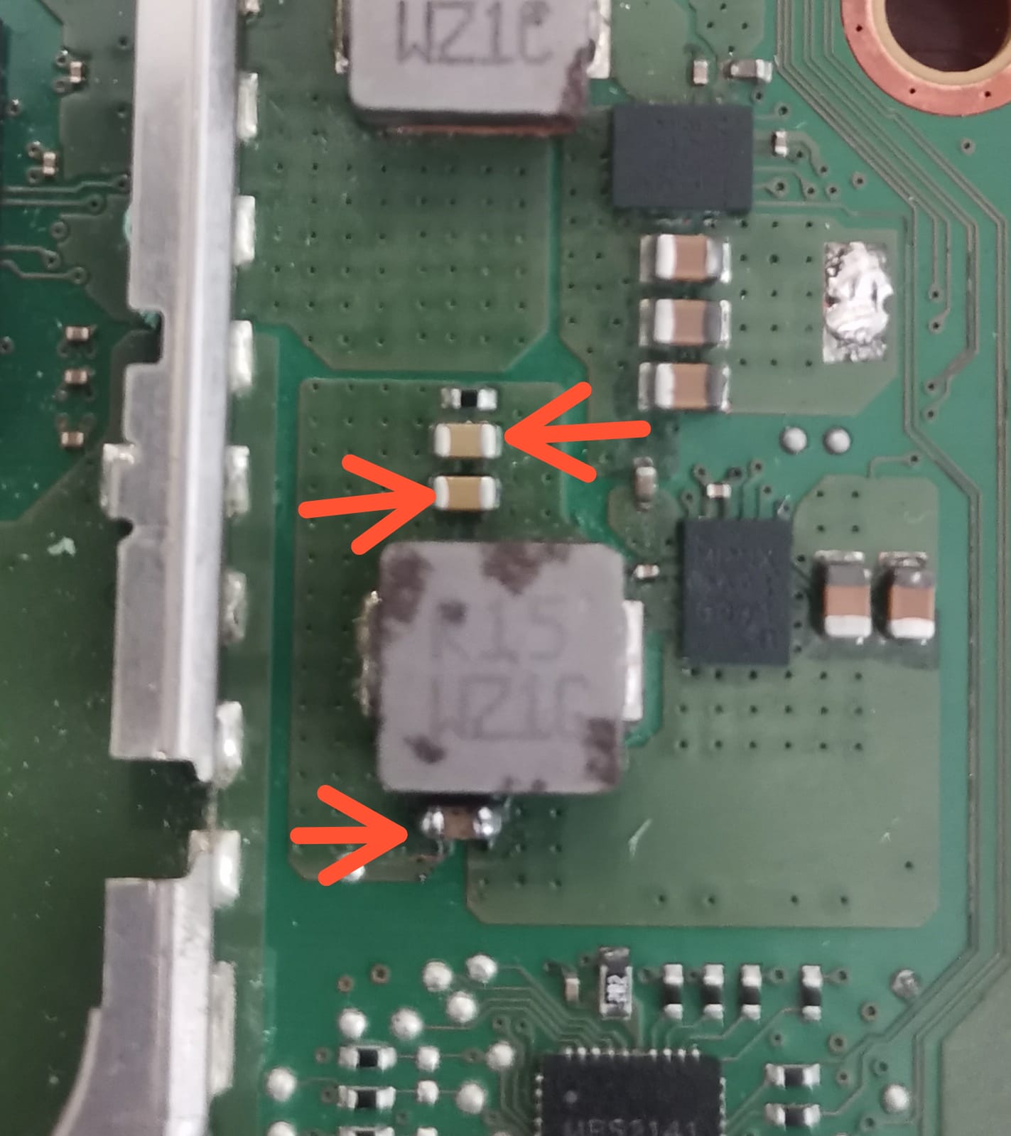

I was able to measure all main voltages: 12V, 3.3V, and 1.8V. Then I started looking for shorted to ground capacitors and found a few. I’ll show them in the following pictures:
(these are on the other side of the motherboard)
I also tried injecting 1.8V into the MOSFET area to see if anything heats up, but I still can’t find the faulty component. I don’t have a thermal camera.
