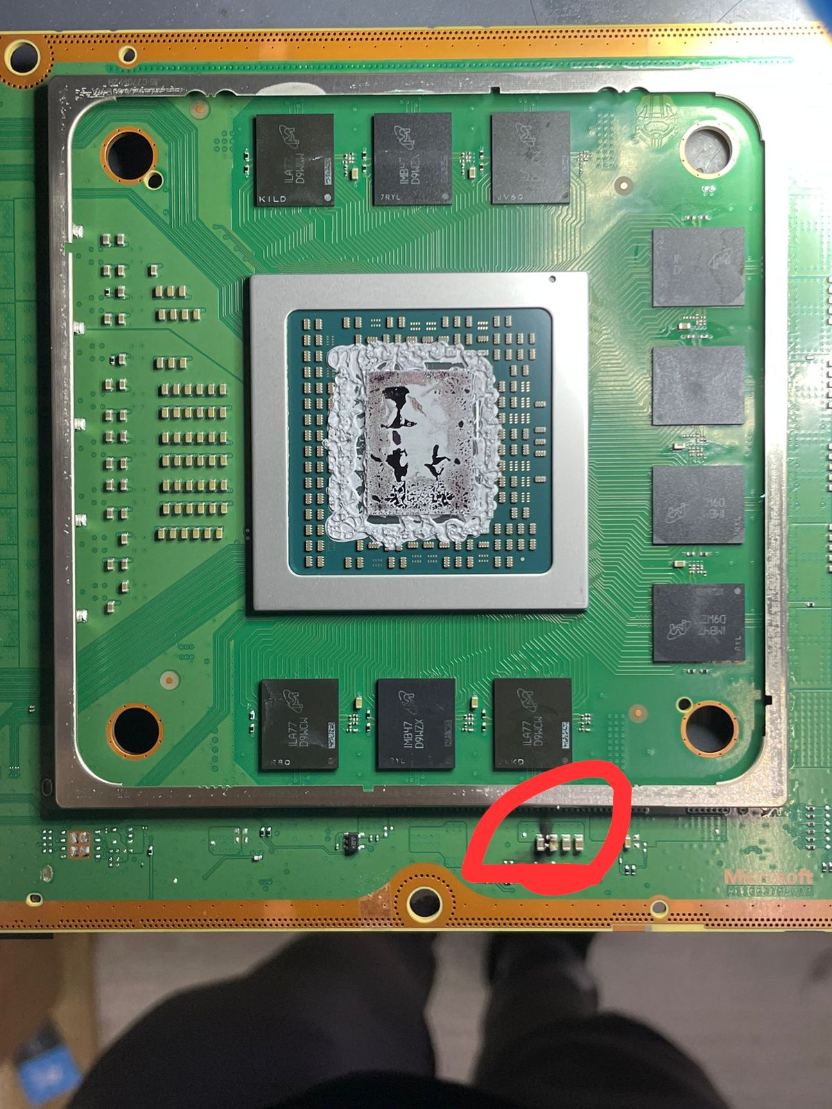

I have this x series board with a short in these capacitors. I would like to know if someone can help me with the values to be able to replace them.
Has the one second to the left scorched the board? bit hard to tell from your image.
Anyway, at the very least, the two on the right look fine, so remove one and measure it then you’ll have the value you need
(the way they are banked up pretty much guarantees they are all the same value)
thanks, in the end 3 of the capacitors were shorted; I managed to get the same capacitors on a one x board
