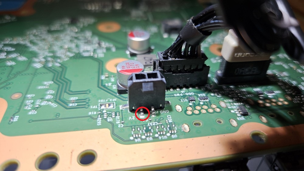

I have purchased a faulty Xbox Series X with no power.
I have done some basic checks and the southboard is not getting 12v in standby.
I have checked the power supply and seem ok (12V will be delivered).
In standy mode I cannot measure and voltages on the 12v point from the southbridge board. I have checked for shorts on the testpoints and cannot find anything
I have currently no idea where the voltage will be dropped, as I cannot measure anything one power supply is connected to the board.
Any ideas, advice are appreciated.
I have a similar issue its a dead xbox series x no shorts found on the 12v or the 5v rails but im not getting any of the other voltages no 3.3, 1.8, or 1.1
