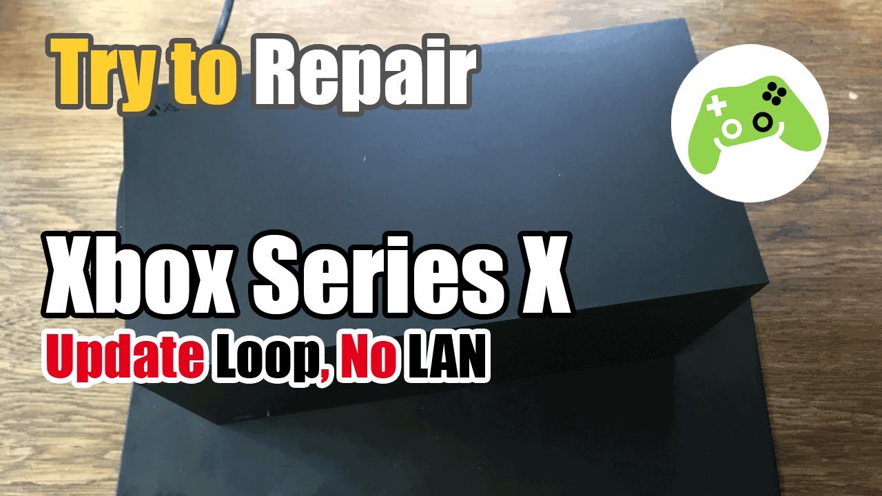

My bet is on the Ethernet Chip RTL8111H. If this chip is bad, the Xbox detects a LAN connection without ethernet cable plugged in.
This would be a job for some one who has skills in micro soldering.
A Southbridge board swap will not work anymore, like it was in the start of the Xbox Series X, because the Flash chip on it contains now infos, which must be transfered to a replacement board. And this process is not easier than changing the Ethernet chip.
Here is a link to a youtube video, where I changed the Ethernet chip:
Hi Calvin, thanks very much for the helpful reply and a great video! I will try this out and see how it goes.
