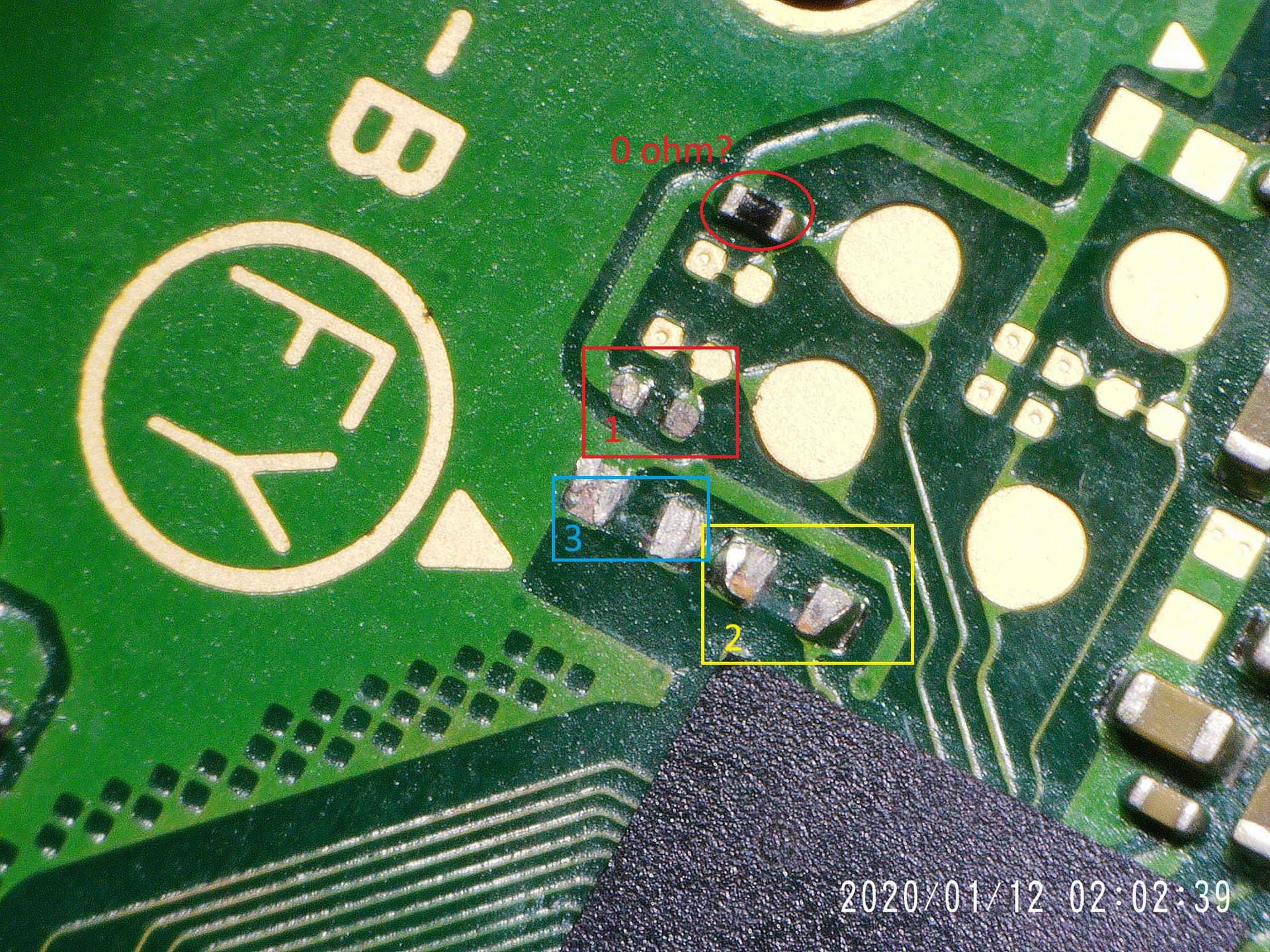

Honestly not sure how I did it, but clearly I did it (I could try and blame the cat). I was installing a new screen in a switch light and the touch feature wouldn’t work once replaced. Tried the software re-calibration and nothing, after further investigation I noticed that there are 3 components that appear to be missing.
When opening the back of the switch, left hand side just below R bumper button near the 60pin ribbon cable please see the 3 components that appear to be missing.

I dont have a lite board by hand, so cant 100% sure if the red missing resistor(No.1) is 0 ohm or not, you could measure the one next to it and see the value if its 0 ohm, those 2 resistors value should be same.
The main guess would be this unknown value FB/inductor( No.3 in blue circle), my previous measure from the post I linked is 150nH, you probable could try bridge it after you put the 1uF cap(No.2 my guess) on
ok thanks, I’ll order that one component and measure the other one and see what it is.
