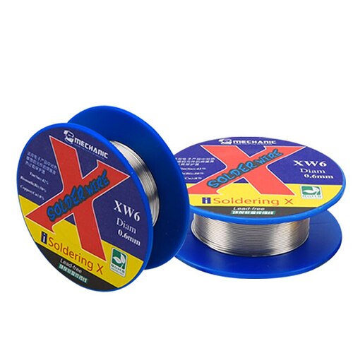

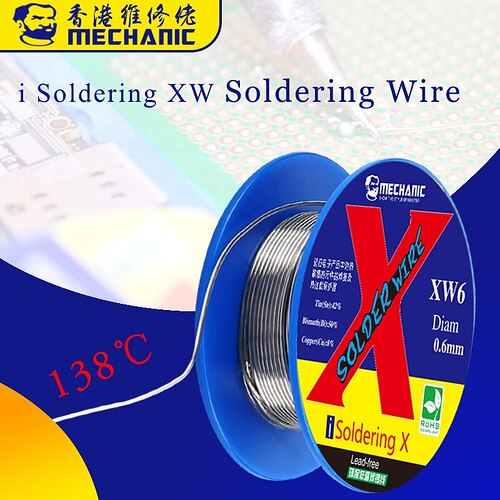

As long it is center “enough” you could also touch up with a d24 or JL02 tip. I usually like JL02 to get into the tight area ( such as left side of m92 beside the resistor). I like to mix the unleaded solder with this solder below to lower the temperature required to melt. I also like to use this solder for fpc joint, since I can reflow at 250~300 degree from the top without damaging the fpc/components around it.
I can tell Severence will hate me for using “low melt” haha.
