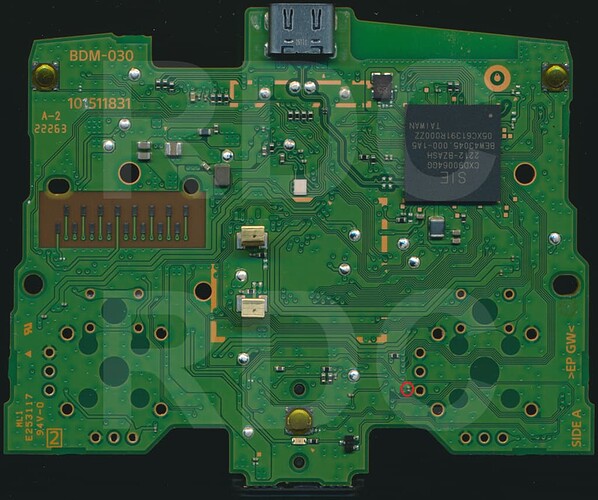

I tried some DIY and was resoldering the drift sticks on BDM-030, once I was finished I noticed my R1 button was not working. After that I checked everything and noticed some scratches on the lines and missing capacitor.
@jkyoho you know what capacitor is marked with red arrow? its super tiny
remove space from link
https ://ibb.co/5gMwKZqL
Should be 0.1uF 0201 cap
I know im late for this, but Im searching the same Resistor, could you maybe tell me if its a 0402 or 0602?
the 100k ohm resistor is 0402 imperial size

Could somebody tell me the value of the two caps red circled on this linked picture on a BDM-030 side A motherboard ?
http ://gofile.me/3fiNe/LQTuuh6hn
