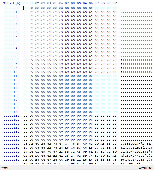

afaict it has been modified, boot0 upto offset 00000220 is usually blank and yours has data - presumaby this is the picofly bootloader/modifications… interestingly it seems slightly different to the SX method. I’m busy atm but I’ll look over it properly within the next couple of days for you.
I’ll have to compare to other dumps and see whats what, might just be a case of stripping out that data etc or padding it. afair the version number is at a particular offset but I’ll have to check on that… this info may well be on Switchbrew somewhere or else I’m gonna have to go over my boot0 dumps and find the pattern (unless anyone else knows off the top of their head)

Ok, on closer examination it seems my initial analysis was not quite right. What I mentioned above about the data at offsets etc applies to patched and unpatched Erista only.
I found a Mariko Boot 0, I only have one it seems so if anybody has a boot0 dump from Mariko I’d appreciate it if you could share incase mine is damaged/modified with SX - So a clean dump if possible as I have not labeled my dump whether or not it was “cleaned” prior.
Anyway assuming my dump is clean (stock standard) there is infact data at the offsets I mentioned earlier on Mariko (which I guess makes sense given the hardware differences on the board) It doesn’t seem like NXNandManager is capable of identifying the FW version using the Boot0 of Mariko (again this is assuming my Mariko boot 0 is clean) which likely means the offset/pattern is not known yet.
Looking at your file though does seem to indicate corruption/modification at the start though (maybe the normal header of mariko boot0?)

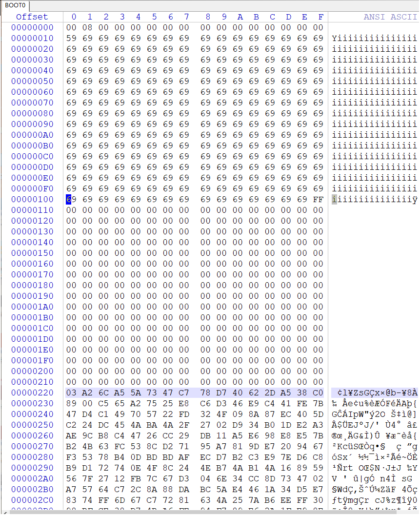

My boot0

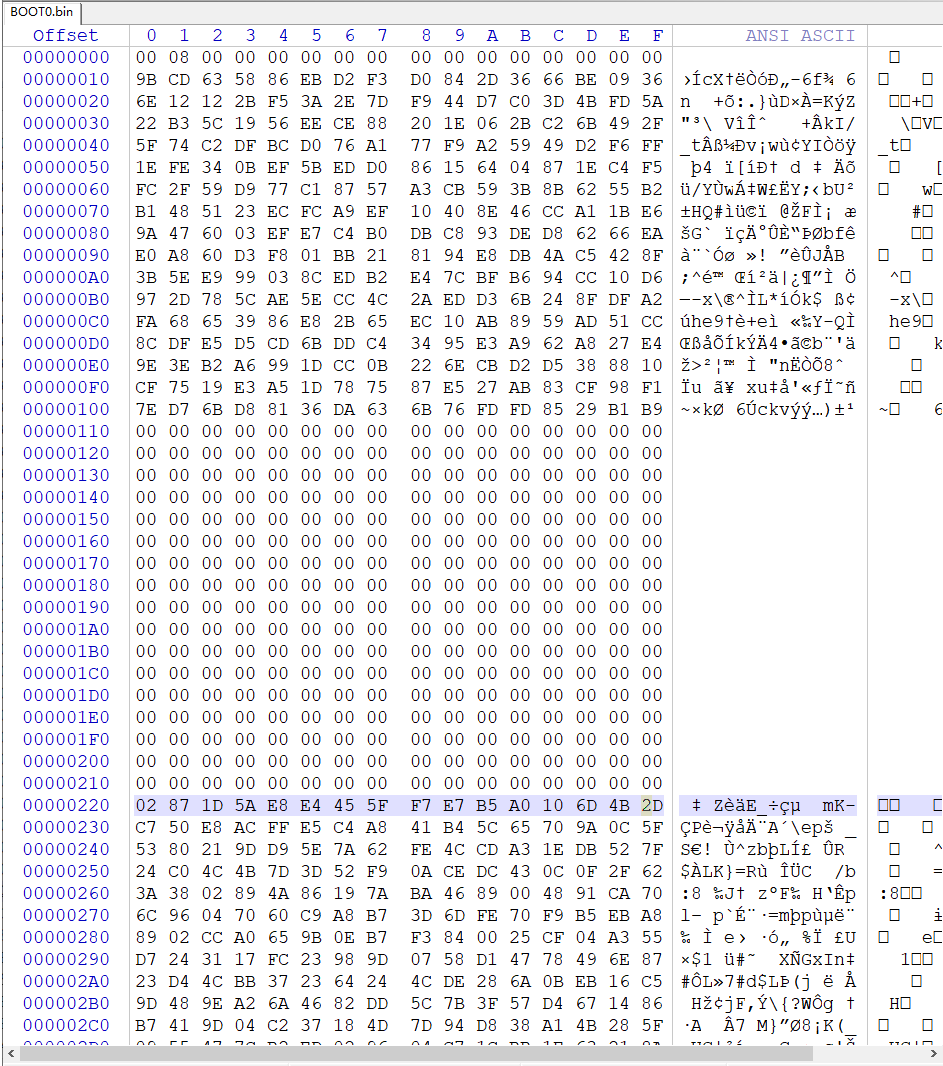

Your Boot0 - with jibberish at the start which I’d oridinarily asscociate with corruption though maybe it’s intentional by picofly (?)

this is Mariko 16.0.3 boot0 with picofly backup from Hekate

Interesting, so seems like this modfication of the the starting data is intentional by picofly (assuming more recent Switch OS/FW versions aren’t doing something very different) - Also suggest this is the same FW version as the OP (data below seems the same)
That’s my thinking though I could well be wrong, unless it clears it and writes again prior to every startup / shutdown :man_shrugging:

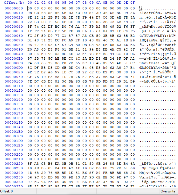

I would be curious to see your boot0 Jkyoho from picofly and your generated boot0 from emmchacgen using you console specific keys just to see how the two compare, might also enable me to see if somethings wrong with the OP’s boot0 and potentially fix (though this sort of thing isn’t really my area)
this is the same mariko device 16.0.3 boot0.bin(1.50MB) gens from emmchaccgen
does seem to confirm the stripping of the [presumed] header data on the image you posted before and the OPs - subsequent data after the header it seems picofly has modified, I’d imagine the original data is still there at a different offset (00000220 onwards) so this doesn’t confirm this is the same FW version as the OP unfortunately.
