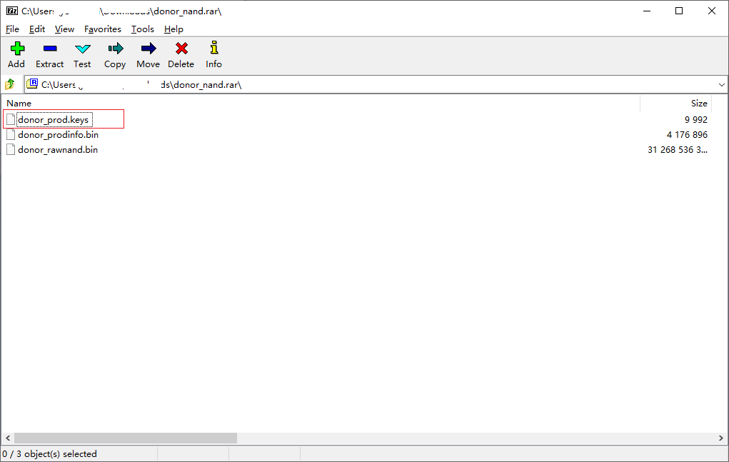

donor key is found from stheix level3 YT videos UNBRICKING THE NSW LEVEL 3 : DO NOT FOLLOW THIS GUIDE BEFORE BACKING UP THE NAND - YouTube

The yt video has the donor product.key in the description section for download.

Here is 16.0.3 boot0 and boot1 from donor key gens.
