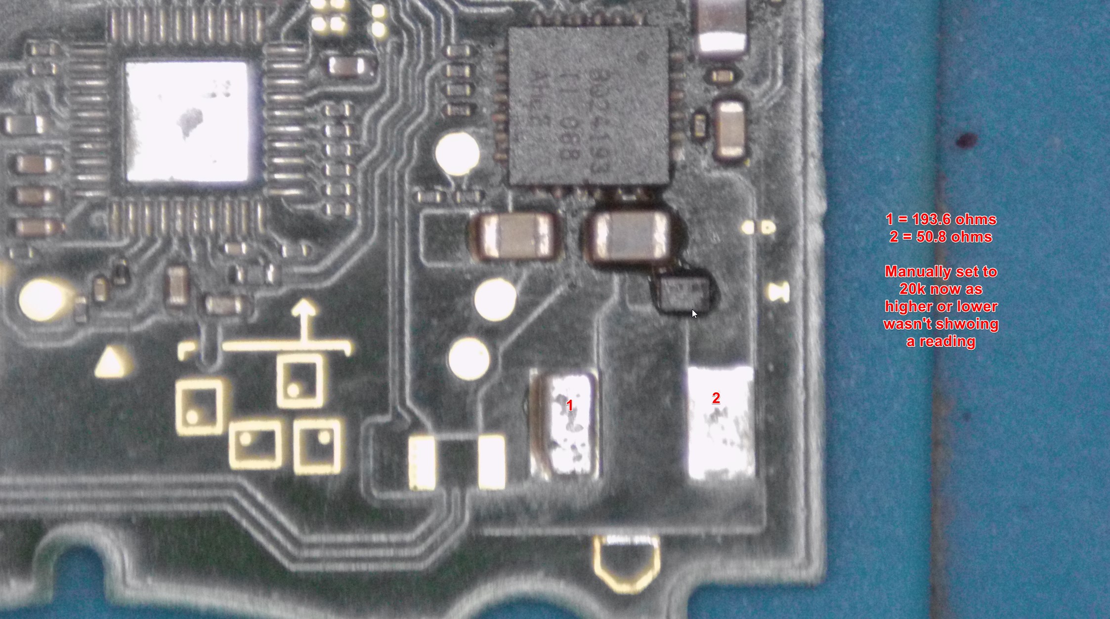

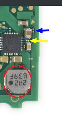

I’m sorry I was measuring the 2 caps, it’s late here I’m from the UK - I don’t see any thing with 2R2 on it but when I look under my scope nothing is grey just a yellow orange colour the light I use really makes viewing unpleasant as there’s way too much glare, I think that is what is making my pictures come out all grainy.

So it would seem both readings are bad, lets try one at a time, try removing the BQ IC and see if the reading on pad number 2 goes up significantly, if it stays around the same then remove the small diode just in front of it.
Sorry this is your pesky meter confusing again, so your measuring 20k? or you have your range on the meter at 20k?
or your measuing 6.3K on the 20k range? In which case that’s a good reading as far as I remember.

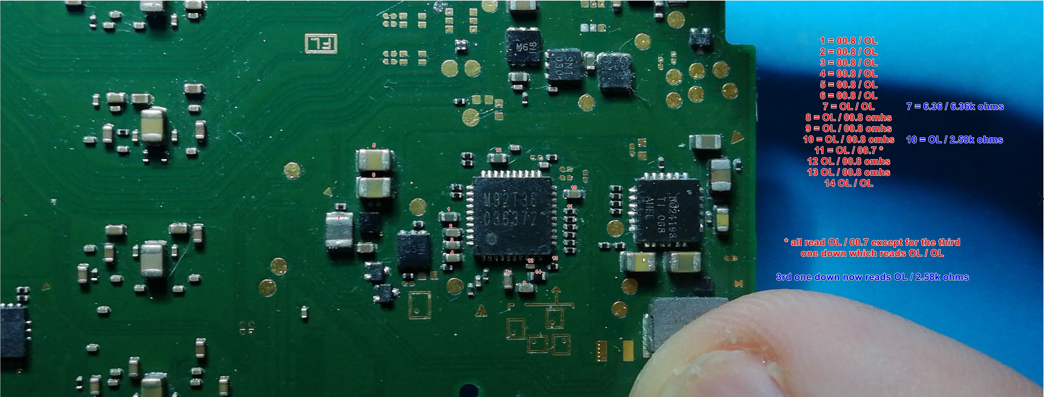

at this point, and if you were getting 6.3K. can you take those same measurments once again around M92 IC so we can see if that fault has also been resolved
Yes sorry I was using 20k range which read 6.3k ohms then I switched it to 200 range and got 199 ohms - I should of put ohms in so you know what the reading was on the meter
Cool so that’s a good reading as far as I remember.
This is obviously just your meter limiting out, this is obviously a really bad meter as most manual ranging meters would show OL or rising and falling quickly to indicate your at your limit or no value at all, oh well, either way don’t worry about this value.
ok, those readings are slightly different than what I was expecting but then that’s maybe because It’s a Lite board.
I think next step is to put the BQ IC back on and the inductor and double check and make sure that the inductor no longer reads short to ground. If it doesn’t then after you can pop the M92 IC back on, again, check you have no shorts to ground.
