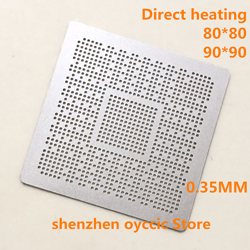

Thanks, FXDX, I’ll definitely try the re-ball on the Nvidia Tegra SoC processor. Would trying to reflow the chip first be a good idea? If not would you know where I could buy a good stencil for the chip?
The best reball…
Great, thank you so much!
