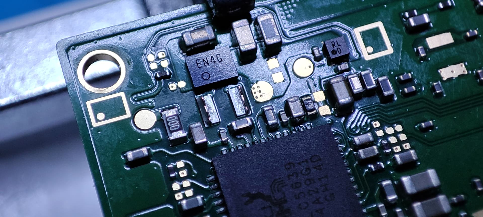

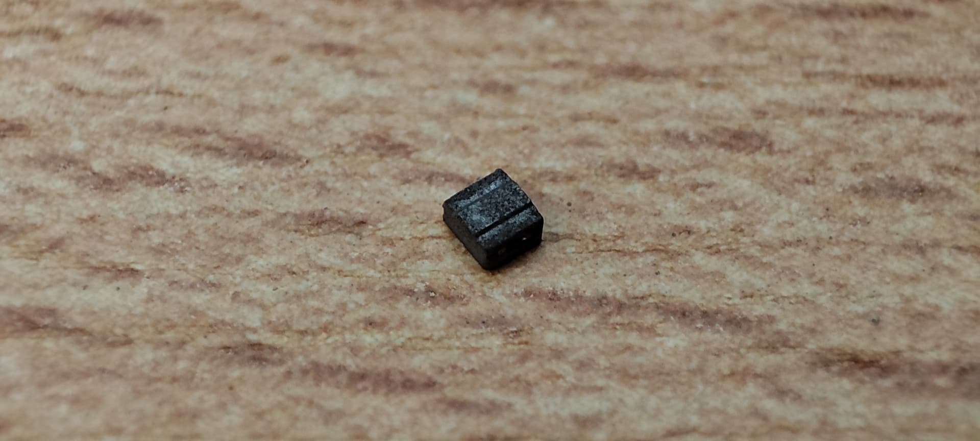

I think this time it is good, beleive or not, the problem was ⦠2 broken coils. One on top of the Realtek IC and one on the back near the āAZJ 734ā component.
I took them from my BSOD board, but they were different model, looks much more robust. By the way, as i would like to fix this BSOD console one day, is there a way to know the value of the coil on the board so that i can replace them ?

Interesting failure mode, if this coil were open youād lose your primary 3V3 rail which if that was the case the console wouldnāt boot so not so sure this was relating to your previous fault symtoms Iām afraid (no screen but hearing console sounds etc)
This one is specified in the datsheet as a 1 μH inductor and as per the datasheet theyāre specifying one of these
Though, pretty much any of the correct value, size and form factor will do
Donāt think Iāve identified this IC but on a Mariko board a similar form factor Max IC part is also using a 1μH incudctor so chances are this one is too
