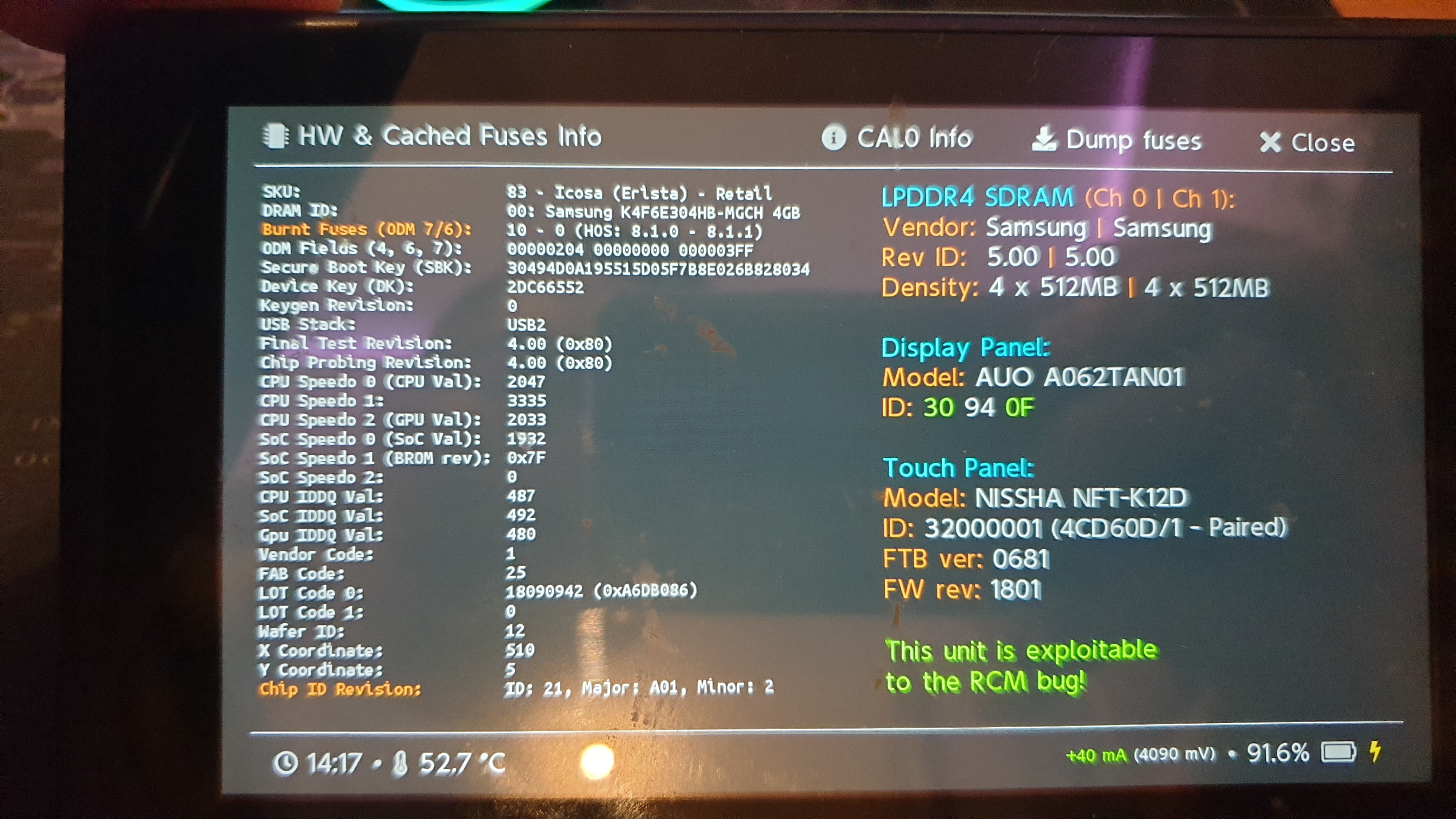

hekate says “Burnt fuses (ODM 7/6): 10 - 0 (HOS: 8.1.0 - 8.1.1)” if that means anything

This is very odd behaviour, fuse should be burned (to whatever the EMMC OS is currently on ) the moment stock OS is attempted to boot (non RCM/no jig then hitting the power button) I can’t really explain what’s going on, I mean unless you have a more obscure hardware fault which Hekate is able to get around but which would prevent stock os from even attempting a boot thus preventing the fuse from burning…

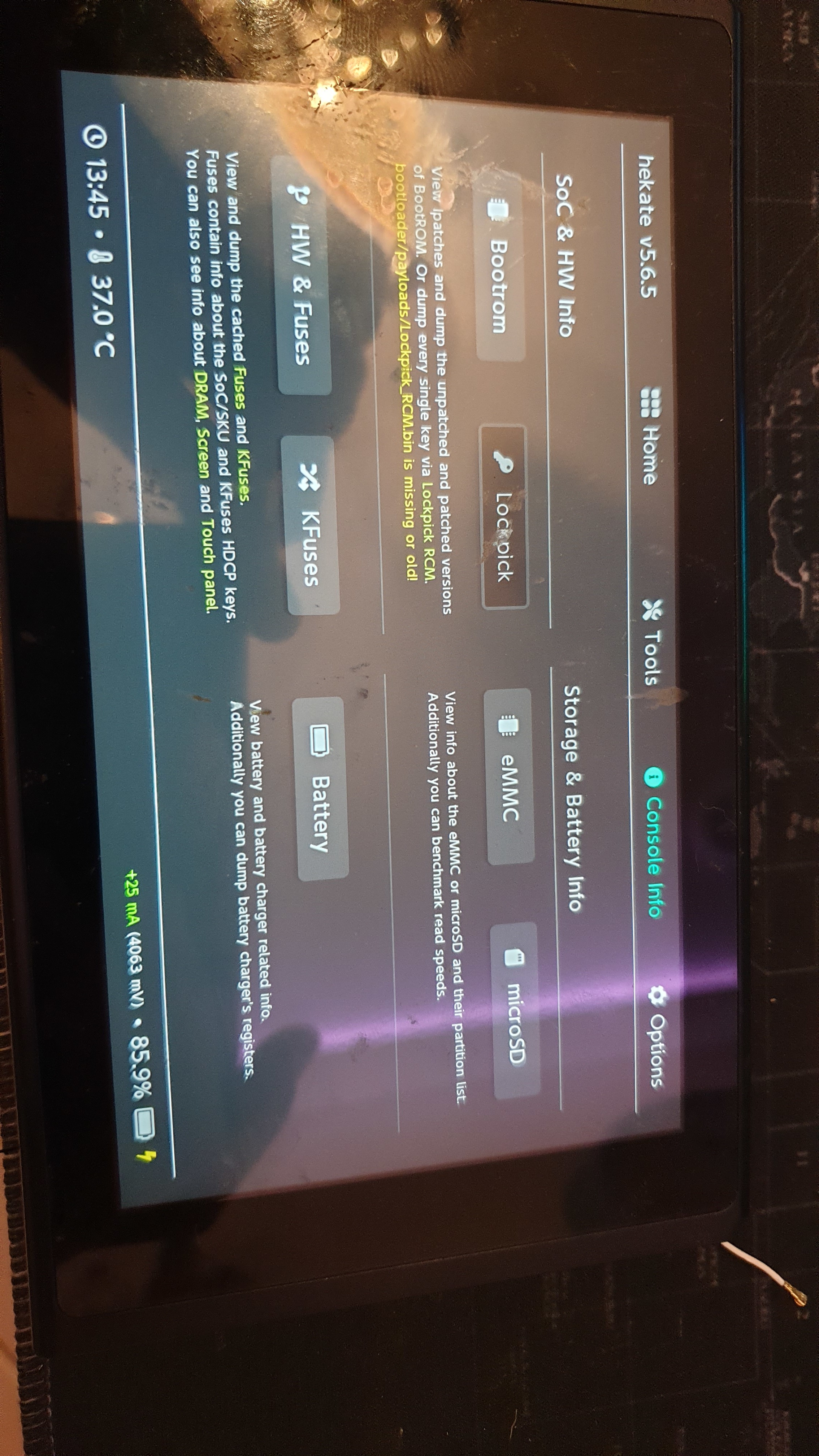

Can you take a photo of the console info section in Hekate?
That’s normal, battery often needs semi cycled before Hekate accurately reports the battery capacity. I would attempt charging the battery externally if you have an ext charger and seeing once again if the console will boot CFW or stock os via Hekate with this suspected bad battery as this may well may be pointing to some other intermittent problem if the suspected bad battery suddenly starts working fine.

Sorry I was navigating the Hekate menu from memory, can you also provide a pic of the HW/Fuses section

Pic below
