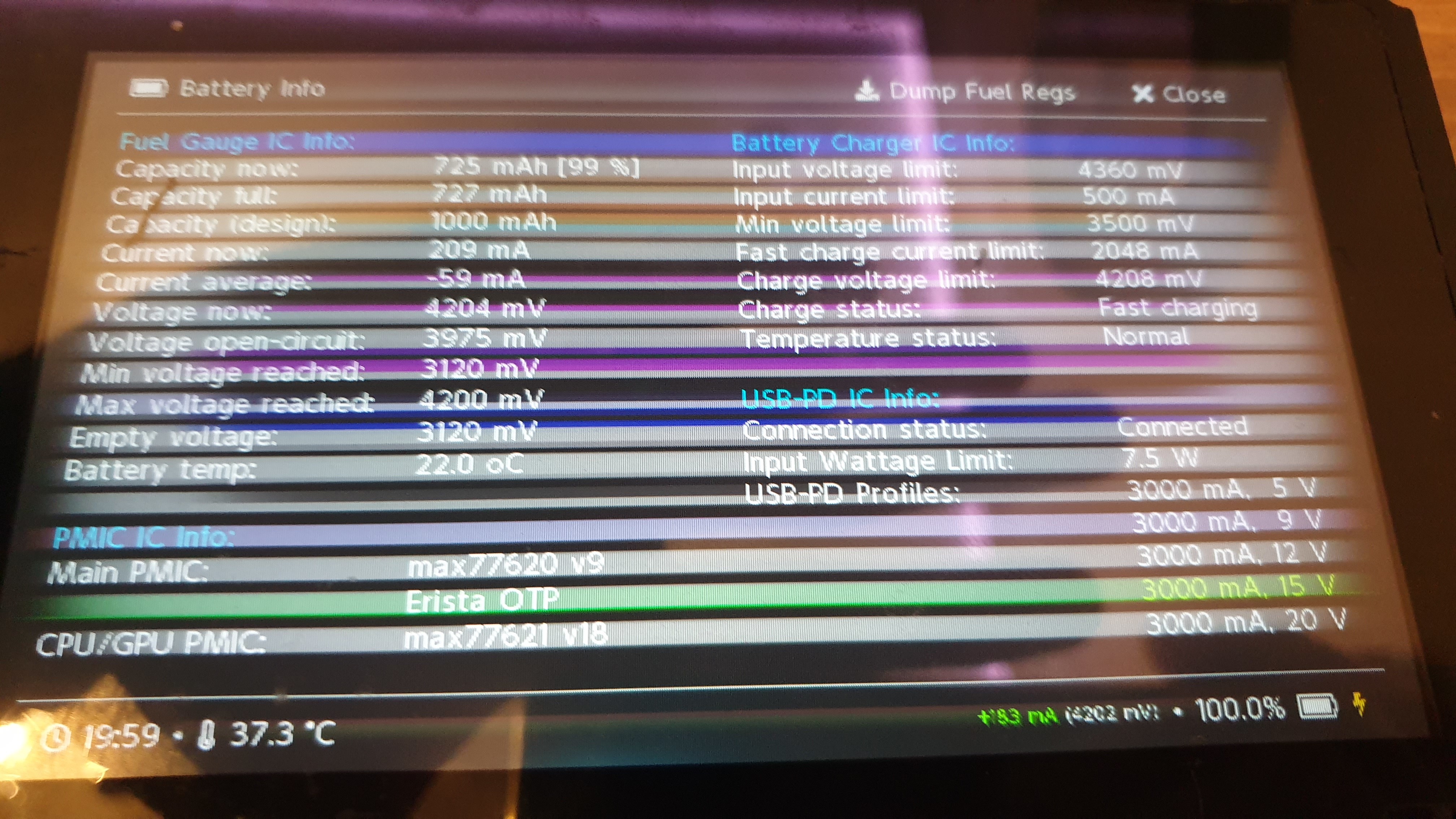

Where do you go to check the fuel gauge and is there anything else I should check / backup?
See pic with info, looks ok to me I think - excuse the bad display, it is a bad screen as works fine in another housing but that one has a touch issue so using this one for testing, it does clear up after being on a bit
yes, that is off. Do you know how to check what version of ofw is currently installed so I can check against the burnt fuses as may have a mismatch as tested this emmc in another switch before I realised you shouldn’t

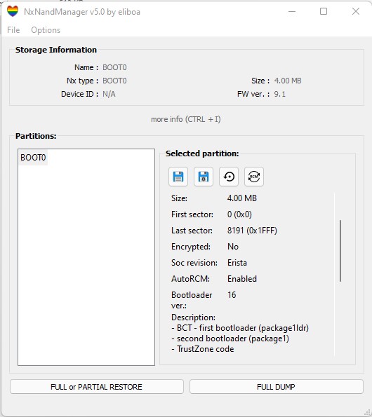

You can open up the boot0 partition from the EMMC backup you made in Hekate in NXNandManager and check the OS version and compare that to the reported burnt fuse count in Hekate and see if it’s a match with the chart here
If it’s not a match, you’ll likely be able to use Daybreak to update the OS

Oh I see you posted already, yeah the burnt fuse count is indicating the OS version should be version 8.1.0 expected on the EMMC, which doesn’t make a lot of sense tbh unless somebody has updated the OS on this EMMC via atmosphere (CFW)
I would attempt to load a CFW yourself which will bypass the fuse check and provided there is no other faults allow Horizon to boot

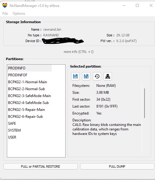

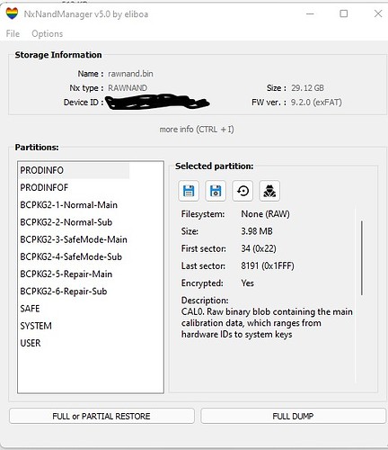

Just to be doubly sure, can you load up the prodinfo partition from the EMMC in NXNandManager (you will need to add your bis Keys for this) and check the reported OS version here too

Yeah, provided biskeydump didn’t throw an error (indicating the EMMC is paired with this board) I think somebody has updated the OS on Sysnand via a CFW, I’d load up atmosphere (on Sysnand) then I’d go through the update process using either Choidujour or Daybreak offline, but we’ll get to that if a Atmosphere CFW/HOS loads up properly
