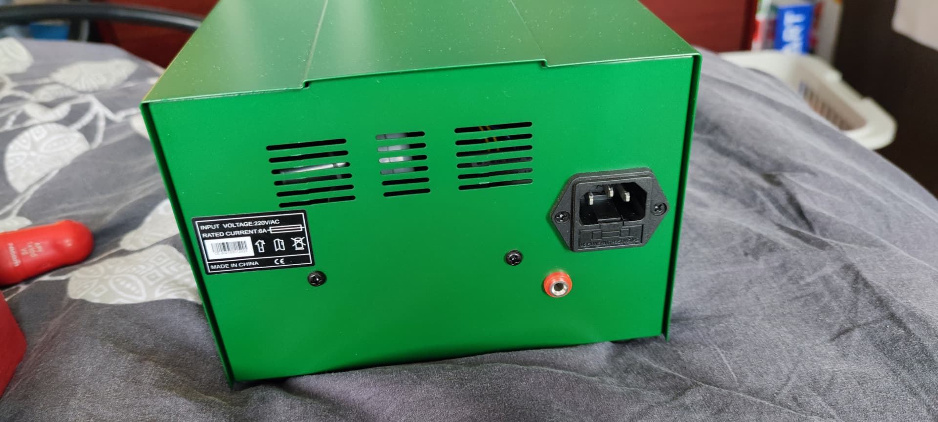

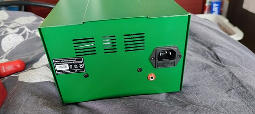

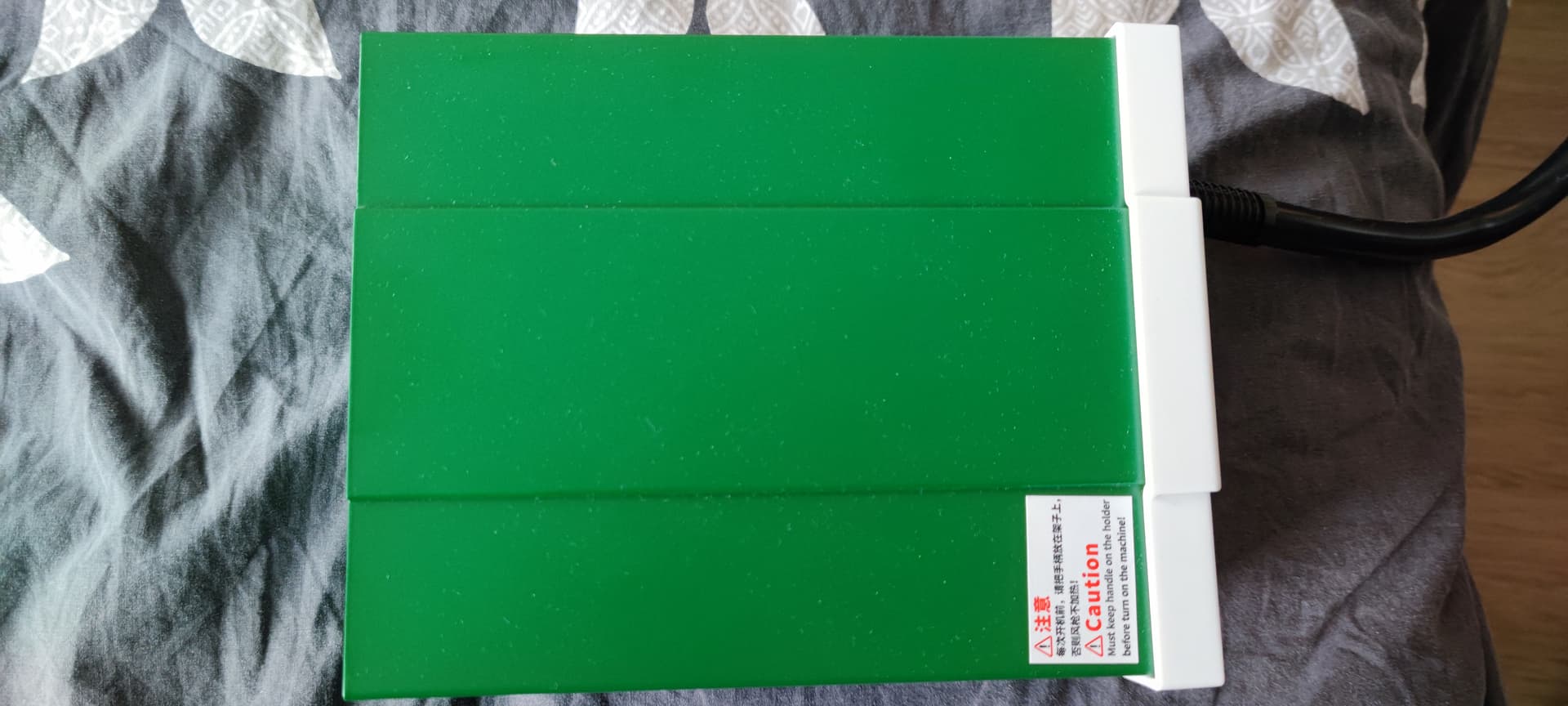

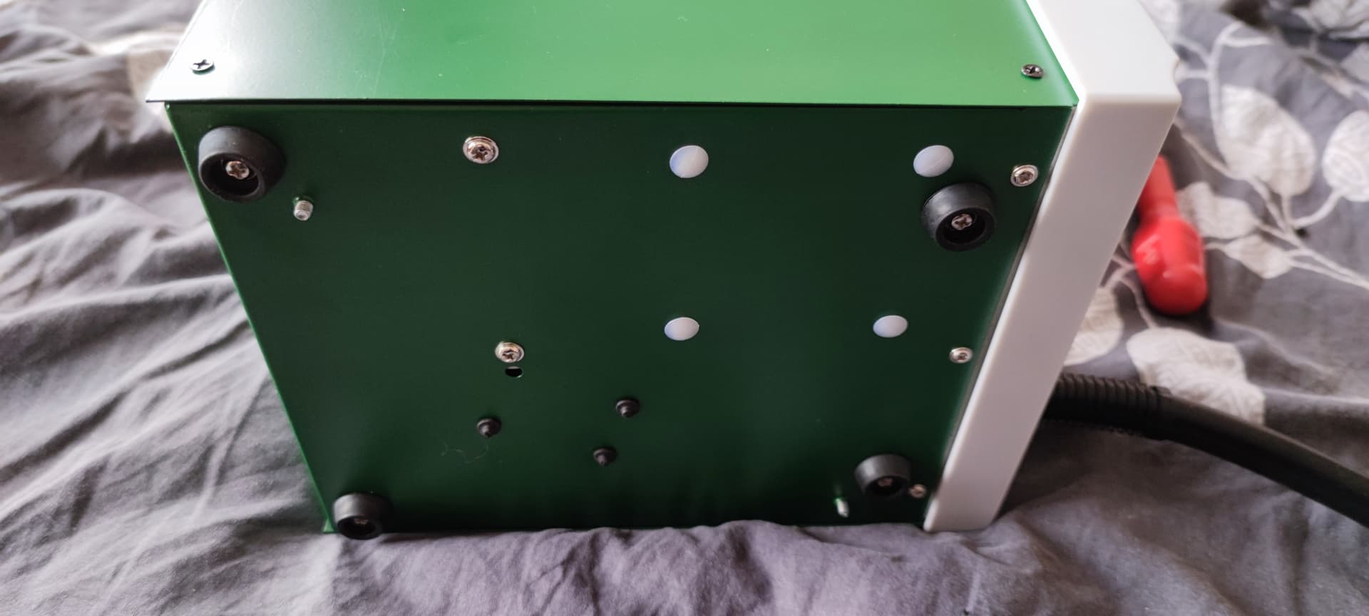

Can I ask a fav, can you take a photo of the back of your best station, I noticed in a few of the unboxing vids there is stickers (maybe waranty seals) over the pressed steel enclosure, mine has no such stickers… which maybe be normal but if not it indicates it’s been opened before… possibly refurbished
I would be an ass really if i would refuse such an easy one after all help you provided me, really.
No stickers on mine as well. However, i can tell you for sure it was new, sticker on the screen, no fingerprint in any place, all looked mint and even the smell, fresh unboxing if you see what i mean

Hmm no sticker / protective film over the display on mine when I got it out the box
Ah the stickers look the same as mine, I think in the videos they’re just placed crooked making them look like warranty stickers, most of the vids have the “BST” hologram sticker also which mine is missing.
The steel section with the green paint is covered in scratches… can only guess it’s been around the block a few times

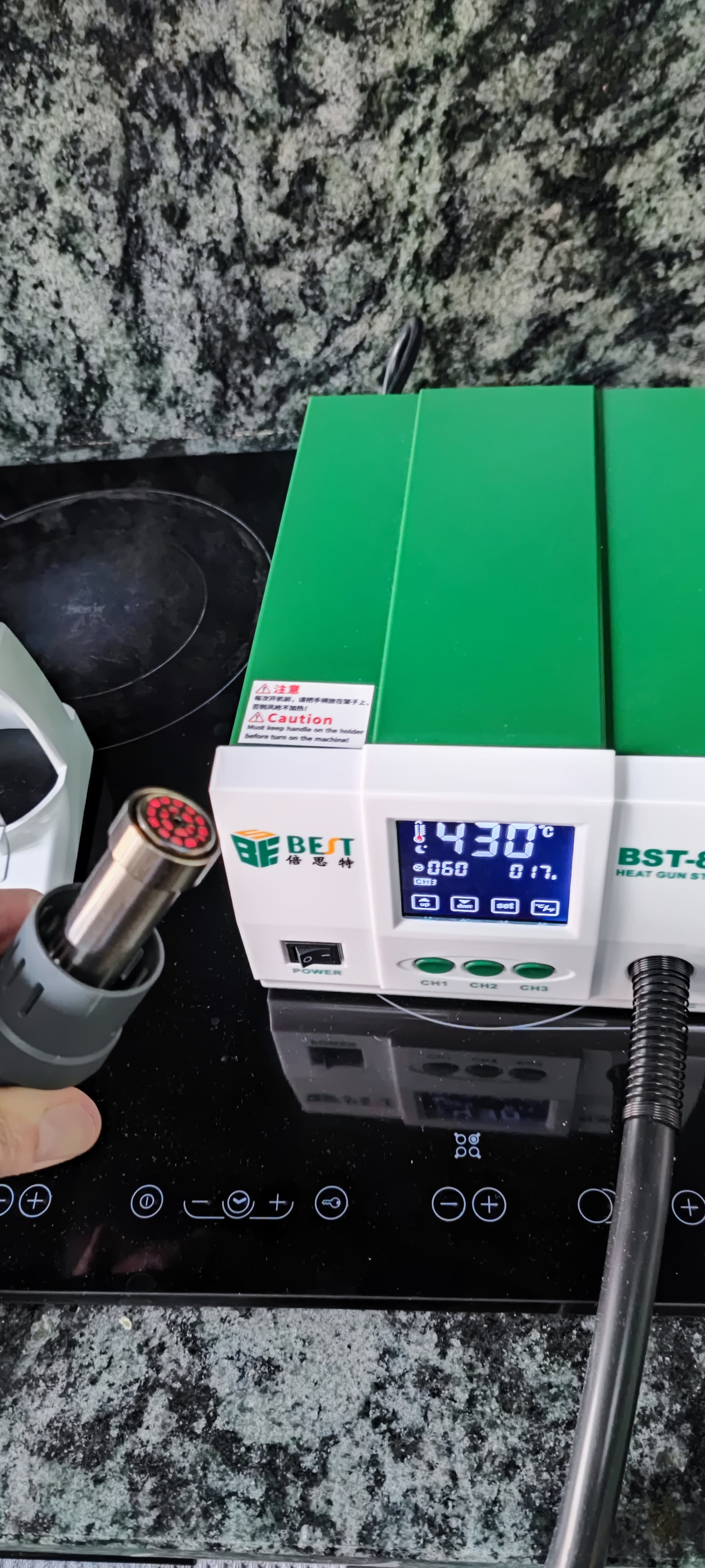

I guess it’s not getting hot at all? I suppose if it’s not unscrew the handle and check the element isn’t broken by checking it’s resistance, also think there is a thermal fuse in there too.

Something about it missing that hologrpahic sticker on the back is erking me making me wonder if the ones without are refurbs / off the books …or something
I didn’t had time to check yet, i restarted my Aoyue and started a claim with Banggood, it isn’t heating indeed. Funny they offered me full refund of the product and that i send it back to China I said no thanks, full refund and i have to pay a large amount of money to send it back in China such as 30-40€ and in the end not getting a device isn’t an option at all. In case they try to screw up with me i will go through the Paypal road.

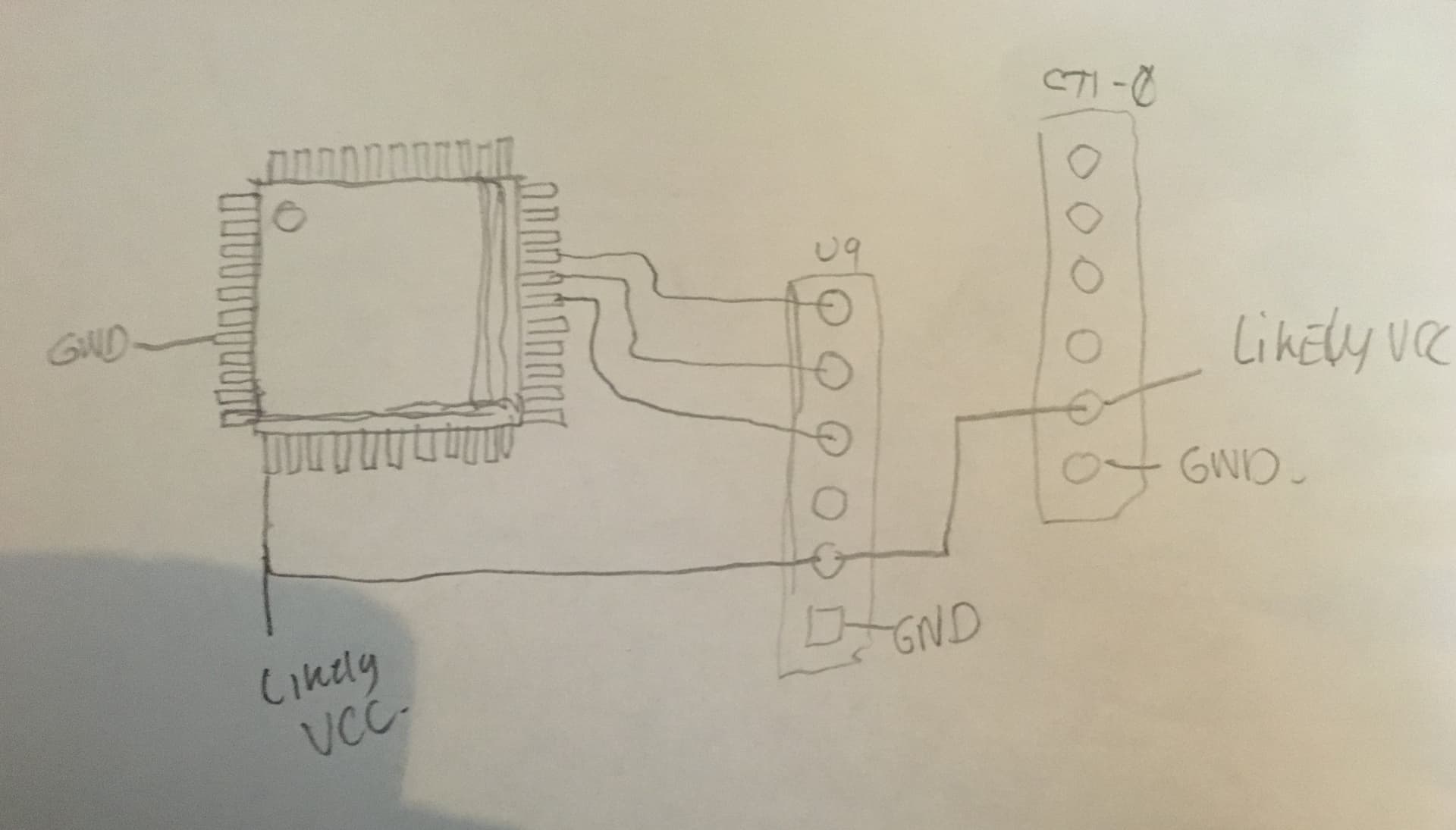

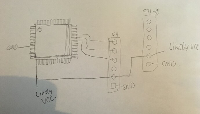

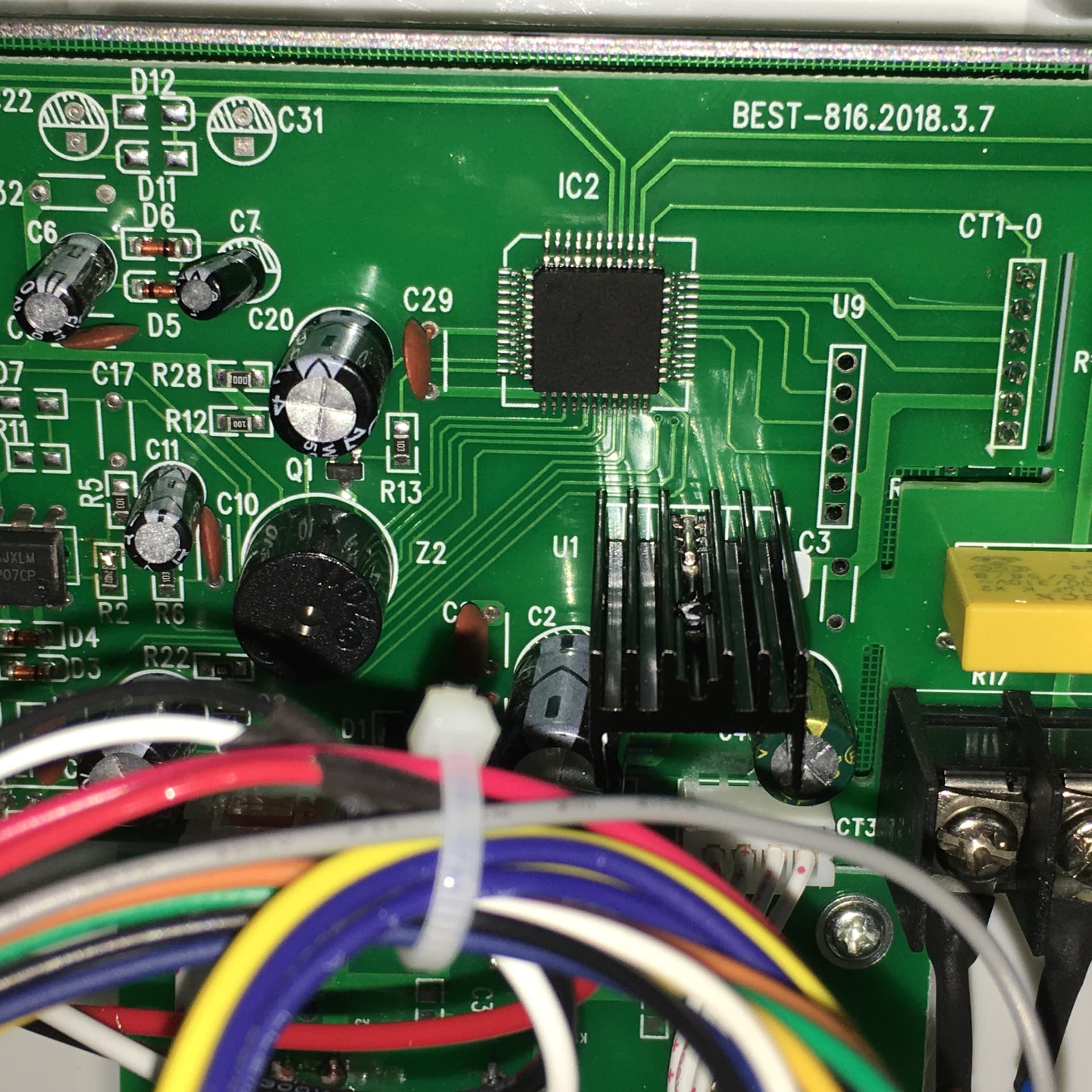

Anyway just reverse engineering the front panel PCB to figure out what the unmarked MCU is and will see if I can fix their mistakes they should be paying me
So trying to identify the unarked MCU on this station has turned out to be more difficult than I thought, I’ve looked at lot of potential candidates across near enough every brand but nothing fits it’s pinout and no chips has both VIN/VCC and GND at these same locations
ST would be the closest though I would imagine they would opt for a Chinese clone or brand, and even though the pinout wouldn’t match Holtek seems the most likely but I’m probably wrong…this one may have beaten me, I highly doubt they’ve spun there own MCU or using a custom, I get the feeling they’ve been a bit naughty and are running VIN/VCC to some other I/O (one marrked “likely VCC” in my drawing) which is inherently pulled up to the same logic level internally to power VIN/VCC to throw people off… that’s my best guess anyway

I traced it out a bit further, the board as a whole is super simple, all the MCU is doing is driving the screen, controlling the triac and sending PWM speed control signal off to the BLDC motor board, opamp for the TC, and opto isolator for the triac, it would be trivial to swap out the MCU with a “normal” MCU (ST etc) and jst lift a couple of legs and run a couple of jumpers so the pinout would match… though tbh I don’t think it’s worth it (it would be if I could identify the existing MCU) when you can get the much better specced mod board for 60 odd $ which does quite a few things better
Also btw, I double checked while the unit was open, that noise when turning off the mains is the motor, afaict it’s as a result of energy stored in the large cap on the BLDC board, as the MCU is not shutting off gracefully and as there is no discharge resistor across that large cap atleast afaict on quick glance I think as the MCU is ungracefully losing power it’s outputting junk on the PWM line, I woud guess the mod board resolves this issue.
Given that the fan turns on when out of the cradle it implies it’s not the reed switch or magnets in the cradle at fault, not much else it can be other that the element itself (or the wiring to it) or the thermal fuse (or the wiring to it)

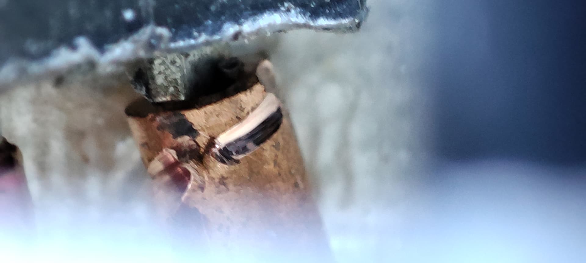

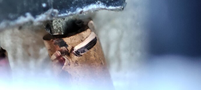

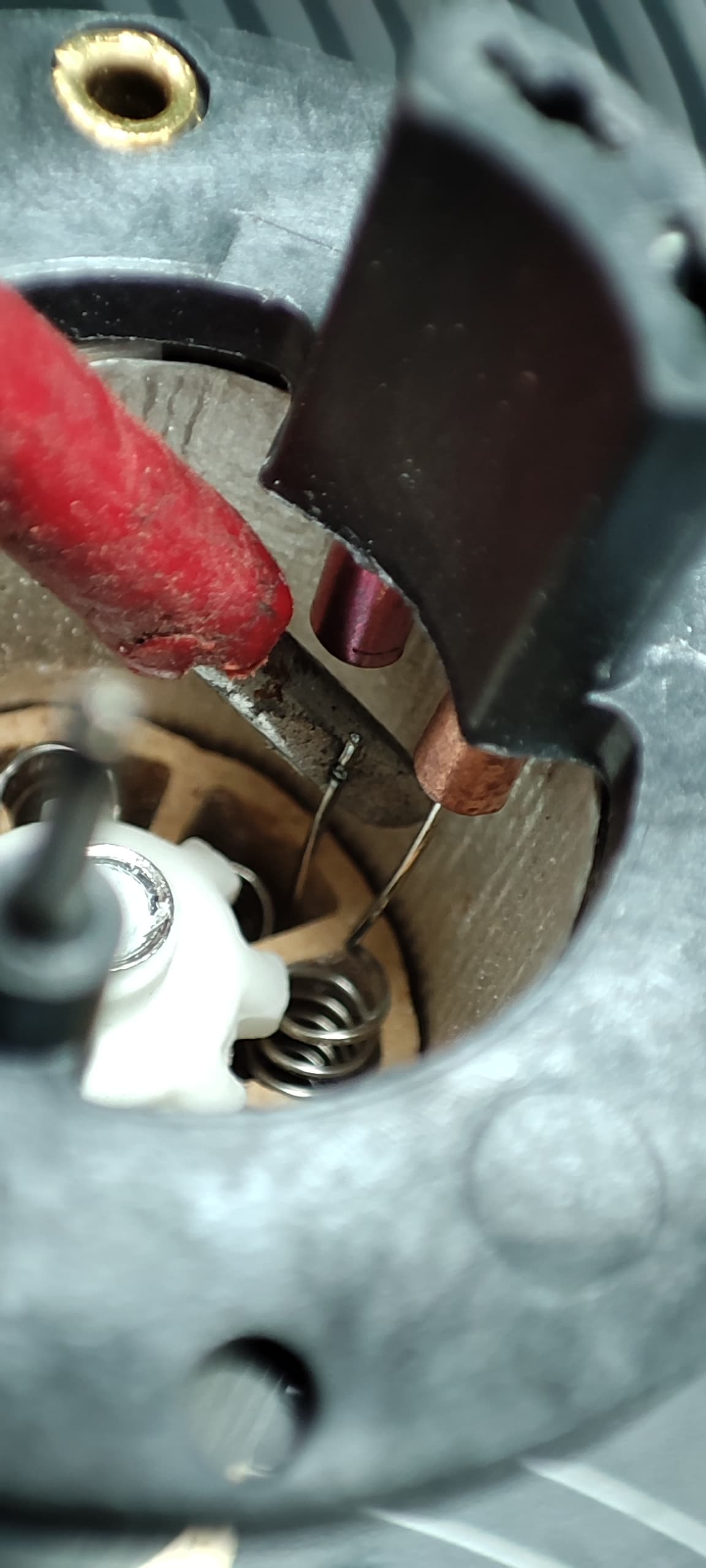

I just disassembled the handle completely, the thermal fuse is open, we have the culprit. But one question, why is it calibrated to 121°C ? The temperature is going much higher, i don’t get it ?
I bought replacement fuse from Amazon, 8€ for 10 but i got them the day after, will try to replace that today. Afaict, the handle is strictly identical to the quick one, from the pictures at least you can’t tell the difference.
And concerning the vendor, they finally understood the issue, and will send me a new heating component (complete they said, but not the complete handle). So overall, i will have a new element for free which is ok. In the end i think if i didn’t had the patience and went the Paypal road, i would have got the unit for free But it is like it is.
Yeah I think so, I ordered one the otherday, I’ll let you know when it arrives
Is that the fuse? if so would imagine that the inside of the handle (provided the fan is running) wouldn’t get anywhere near that so it should only trip in a fault condition for example if the fan died or something, I would hazard the internal handle termperature is no more than 20C above ambient.

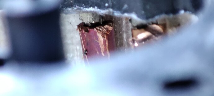

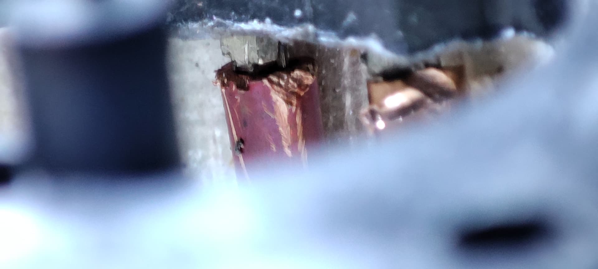

Oh yeah, bit hard to tell what’s going on there without looking at it myself but I guess the wire has broken going to the element?
Yeah will melt instantly, a bare ferrule would work though crimped on
Well weird then that the original temperature is set to 121 Celsius. But yeah it was the fuse.
Correct and I fixed it, I think you should also have a look because it looks like a flaw to me. The wire from the heating element is going into this connector, and both weren’t tied to it. I just could remove the second one with a tweezer, there is no retention of any sort. So to fix it, I replaced both wire inside their connector, and using a small clamp, somehow crimped the wire inside. It isn’t pretty, but now the wire is strongly attached, I can’t pull it anymore with tweezers.
Trouble is, if say for example you whacked a 150/200C rated thermal fuse in, what would happen in the event of a fault condition is the plastic would either deform or melt before the fuse ever blew so approx 121C is the right choice afaict

Wow seem pretty shoddy, so they were just lightly touching? maybe this was causing arcing as a result which is probably what caused that fuse to fail prematurely
I haven’t changed the temperature, i placed the same of course, i was just wondering why, but your explanation makes sense i see the point.
Correct, just placed in like that, no retention of any sort, just unbelievable. Now with my mod, it is really tight. Probably yes for the fuse, i agree
