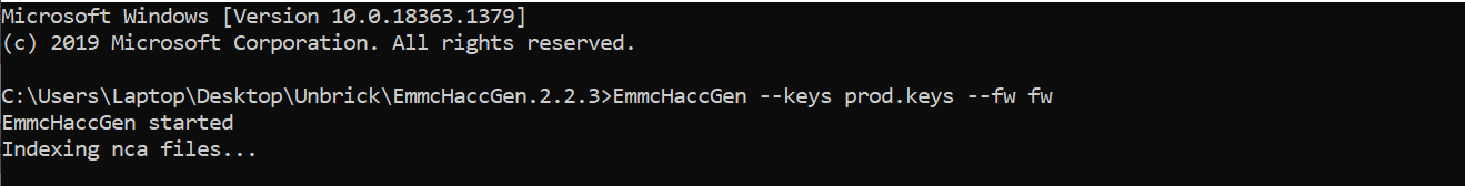

Hey,
I have attached pictures. Start cmd on the folder and use the command below
“EmmcHaccGen --keys prod.keys --fw fw”
My downgrade/upgrade firmware is in the “fw” folder. prod.keys is generated by lockpick.rcm and placed in the EmmcHaccGen folder
https://suchmememanyskill.github.io/guides/unbrick/#mmc-rebuild
