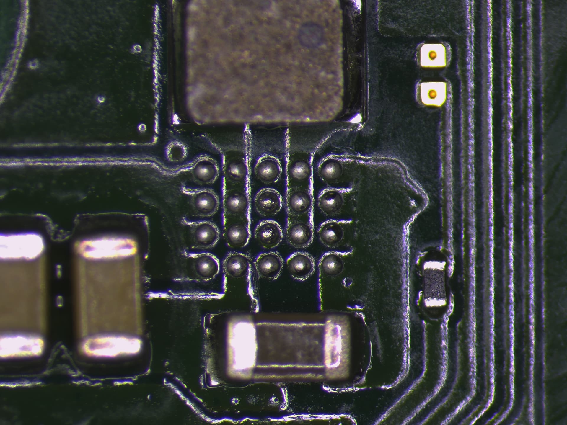

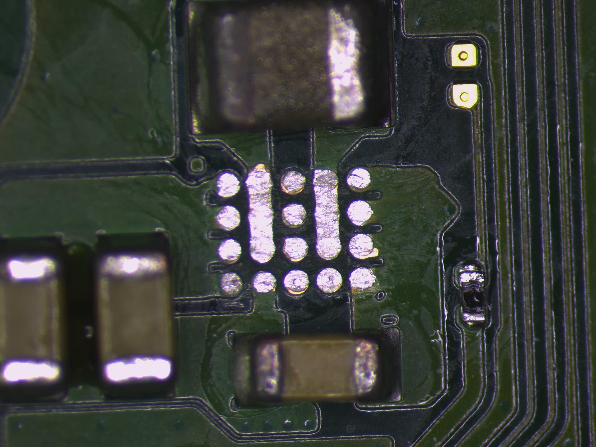

guys i have this switch lite in repair, on the motherboard i have the ic ENJ9 cracked by a bump.
could you tell me what it is?
I can not find.

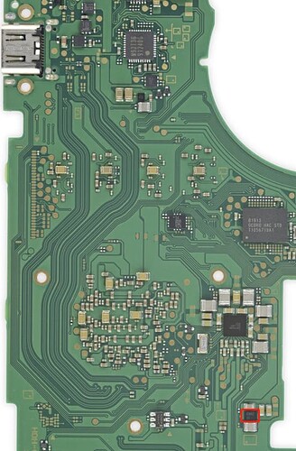

Searching around here suggests it is a RP602Z330C.
If you talking about this chip on switch lite
Thank , i have ordered on mouser
yes ,this is RP602Z330C ?
This is the thread I found:
I usually trust Severance when it comes to these things.
I believe is RP602Z330C . It was a big mistake long ago someone said that were Toshiba DAC amp ic
