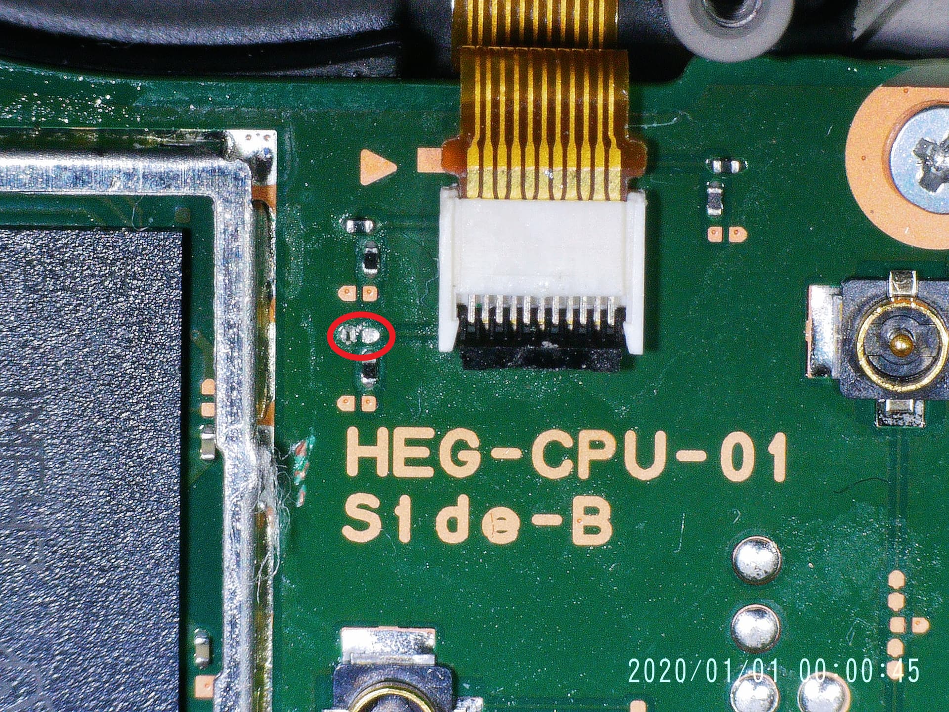

I have received a defective OLED where someone tried to install a modchip and killed the complete board.
The DAT0 line was completely broken - I think i fixed it - at least after the fix console turned from black to a purple screen ![]()
I have seen that one cap (?) near the LCD connector is also missing - does anybody know what kind of cap it is and maybe if there are spare part on an -non OLED mainboard (I have a couple of them but no OLED)
Not sure if I can bring it back to life but would be happy trying…
