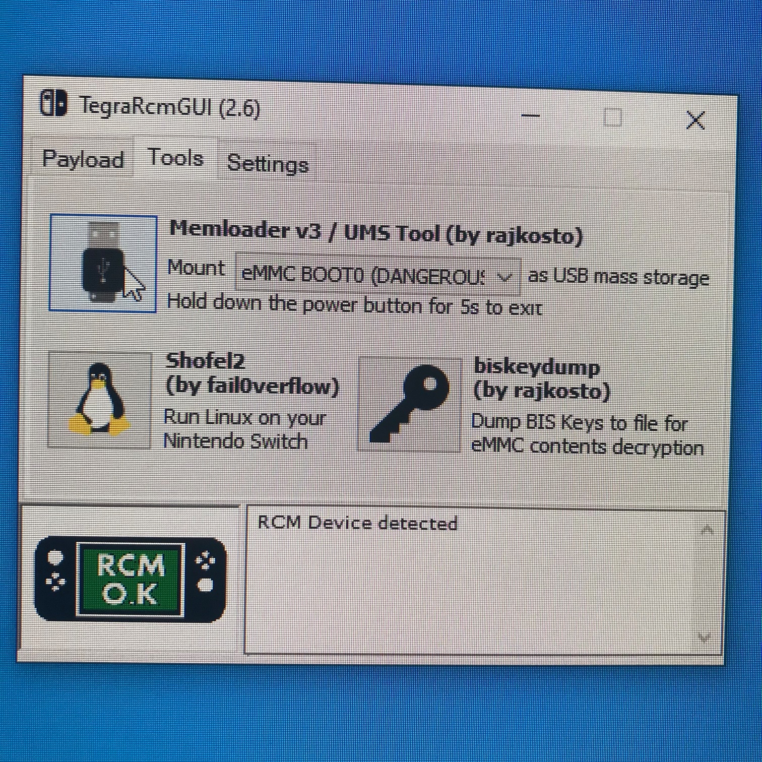

Thanks for the tutorials. Both of them show the step where they inject memloader payload into the bricked console to access the eMMC chip via a pc tool.

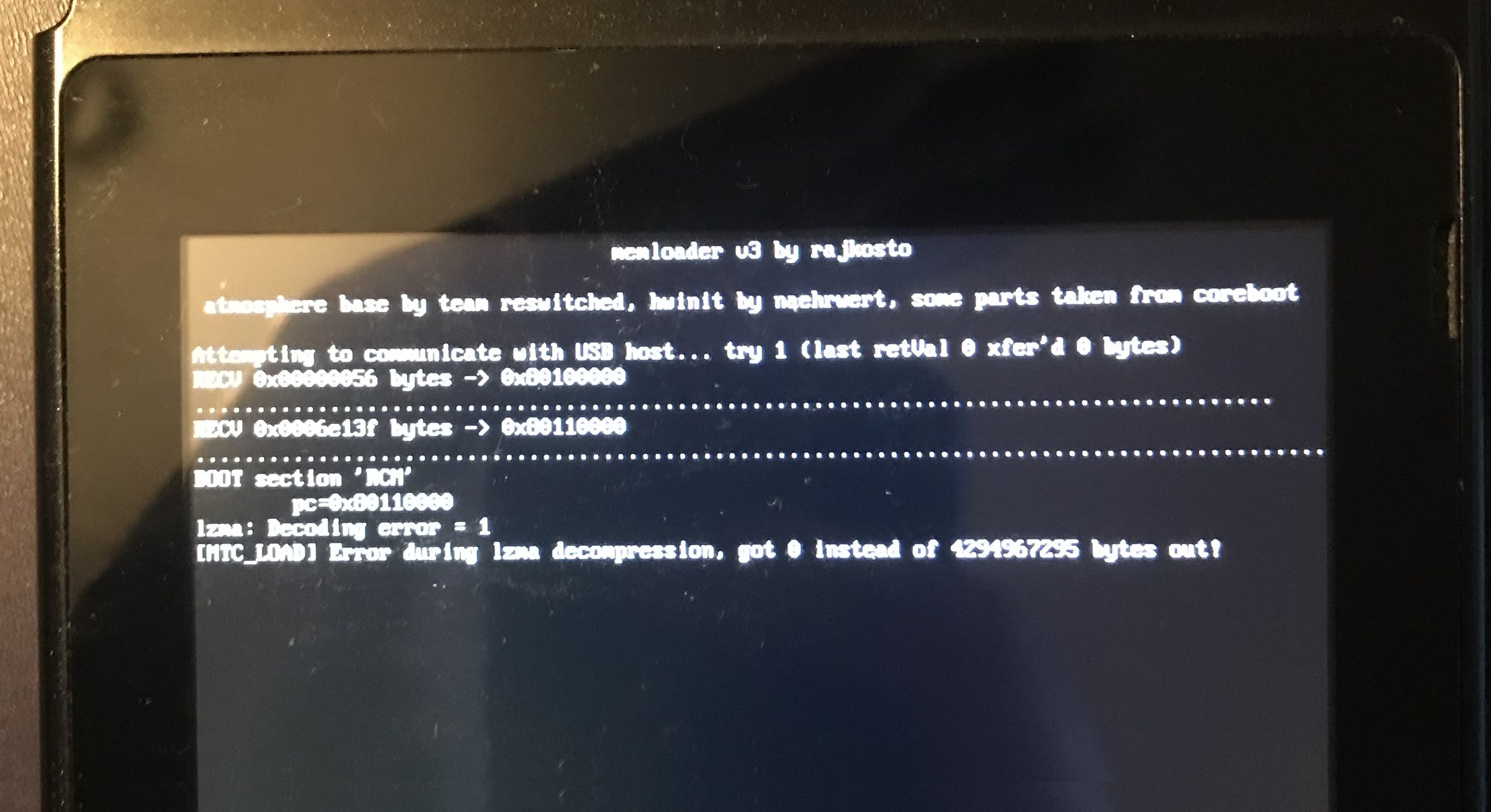

In my case, I’m not able to access the switch as a physical drive. After injecting memloader like this
The switch receives the payload but is then stuck at this screen with “Error during lzma decompression, got 0 instead of xxxxxxx bytes out!” nevertheless which eMMC section I’m trying to mount.

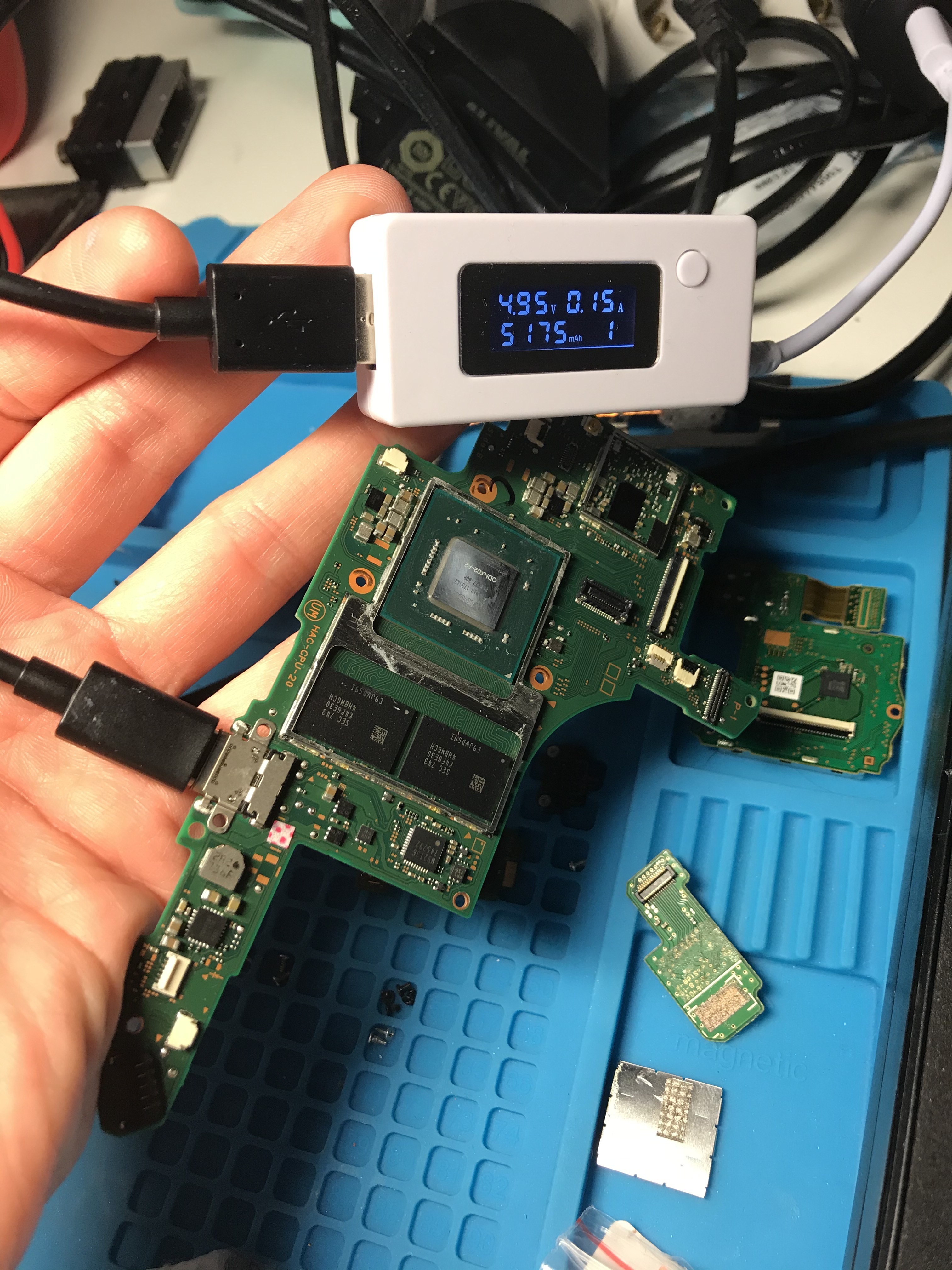

Right now im doing some more research on the hardware. The bare logic board is drawing around 0.13 - 0.15 amps at around 5 volts. Is this normal behaviour or shouldn’t it draw any current at all?

I managed to get a separate emmc memory module which I can access via tegraexplorer (just like the old one) but the problem with memloader is still present. What else can cause this issue?
Possible problems with the Tegra processor or any of the memory ram.
Short update on this: I reflowed the memory ram and the tegra processor and now memloader can load the nand successfully and I’m able to mount the drive on my pc. Unfortunately I’m not aware if the tegra processor or the ram was the problem. Thanks so far!
