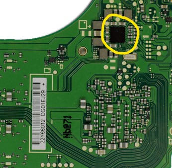

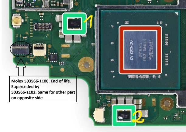

Hi, thanks for your reply, SherriffBuck! I’ve been doing some reading in other posts and assume that with “GPU buck” you mean one of the ICs controlling the GPU, is that right? Could you point out which one are you referring to? I’ve attached two screenshots of the places that I think might be the ones, all pointed out in yellow “1”, “2”, and a circle. As I already pulled the IC on position “1”, that one is proably not the one you are talking about, but just double checking here.
Thanks!
Hi, this is already ages ago, but I’d like to give an update here:
Removing the two Max ICs (the one I marked 1 and 2) didn’t clear the short.
I finally pulled the RAM and SoC, and it turned out the short was gone after the SoC was removed… =) Thanks again everyone who contributed to this post!
