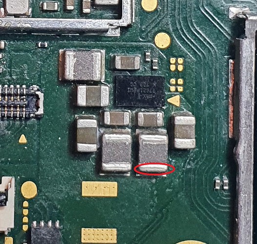

Now to your short, try in same diode mode on both sides of that capacitor. You could try using ipa(or lighter fluid) to wet board with bench power supply connected and amp limited to see where it will evaporates first. Before you do that if you have working board you can try to find where tracks connected to which components that can help to see where possible problem may be. How I wished schematic for nintendo to fall off the truck would made it so much easier to troubleshoot.
see last post, I corrected it. And it was set to diode mode with red probe to ground.
good idea! might try that next.
hmm, wouldn’t really know where to start here… maybe m92? I might take that off one more time to double check anyway…
When there’s a short to ground, usually voltage pulled down by the short and as you are measuring 1.8v or close enough, short is not convincing . Also all lines on pins are good. I got 3 switches left all with different faults (some awaiting parts) but I guess being technician and have all tools helps in detection.

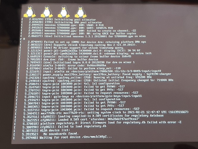

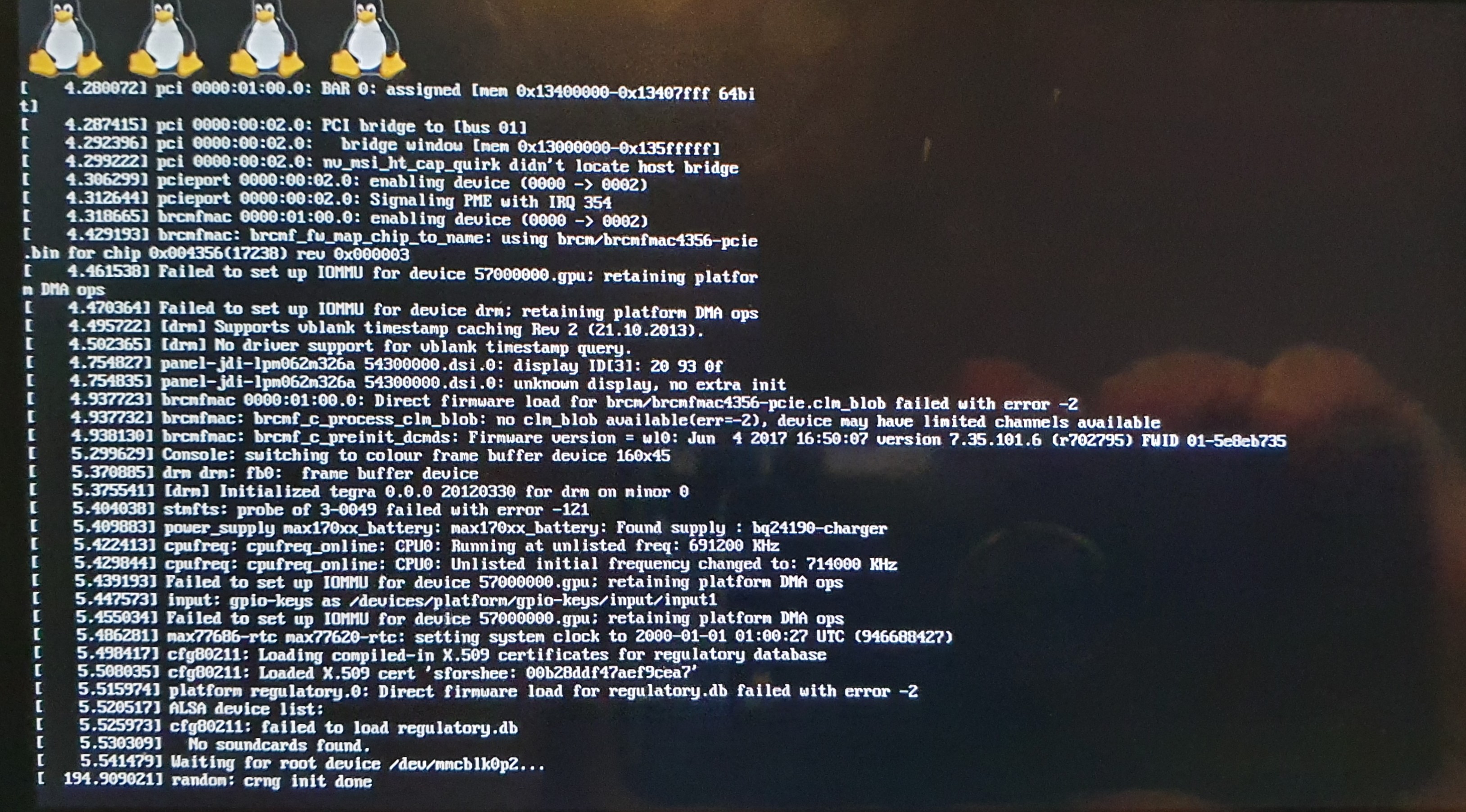

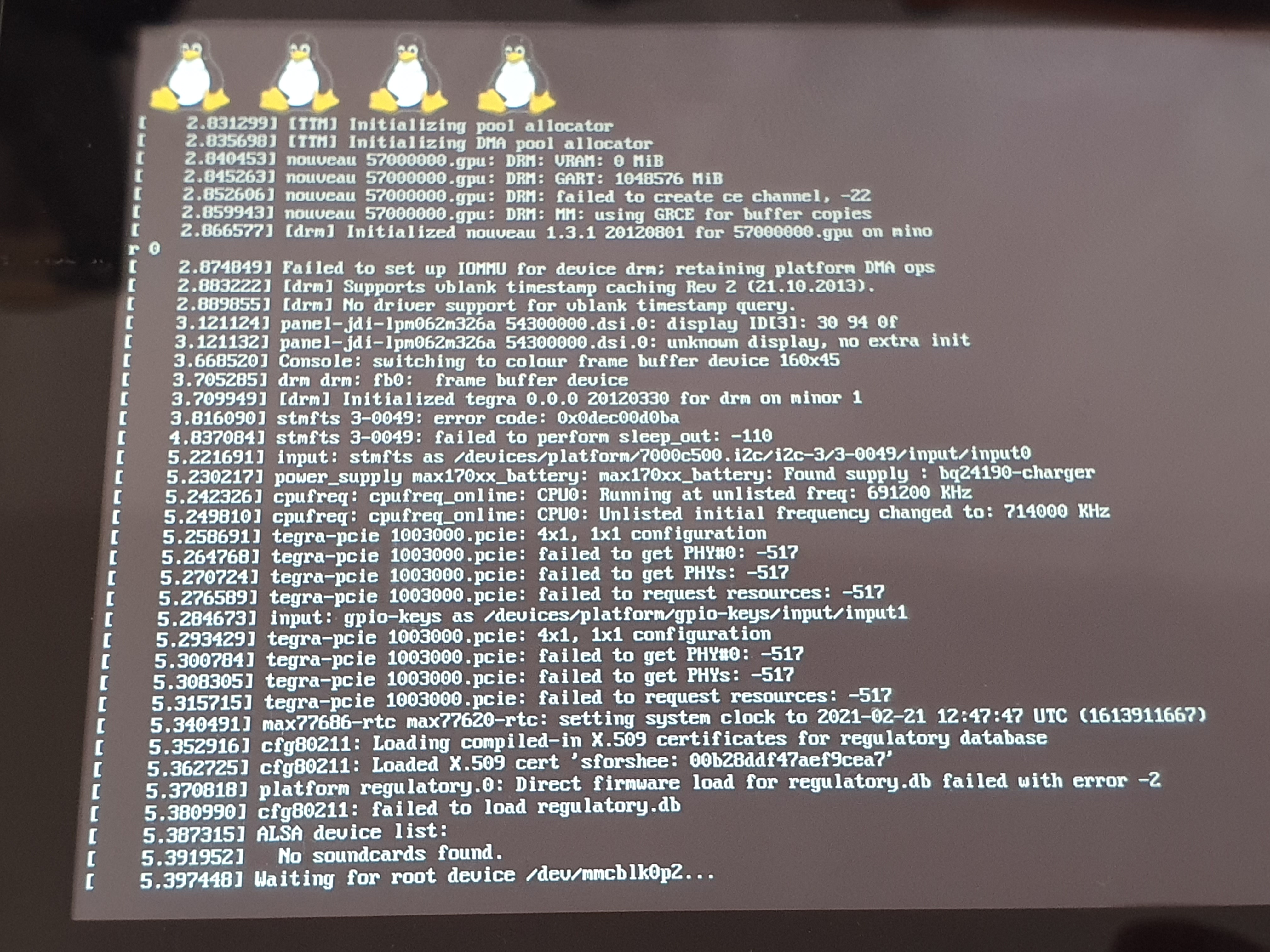

lets first get back to what we wrote earlier in PM, thought its also good to share that info in case other people find it interesting or helpful. I compared the linux boot logs of my faulty Switch and a good Switch and indeed there are some differences, especially the line “Failed to set up IOMMU for device 57000000.gpu…” that pops up multiple times.
Here to compare, the BAD one:
And the GOOD one:

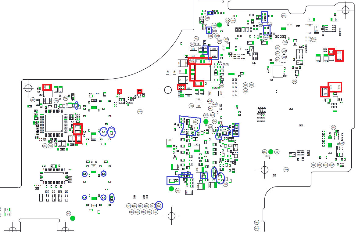

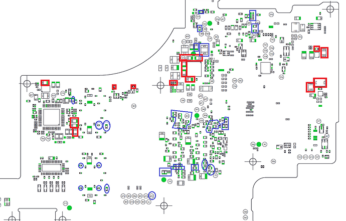

Additionally, before pulling anything off, I took out the board one more time to check some components using @Calvin 's diagrams (HUGE thanks for those, they are very helpful!!! ) and I found loads of shorts to ground on the back side of the CPU (or GPU? that nVidia thingy… I think the one you call SoC
), RAM and other places. Look at this image, I marked them all BLUE (ignore the red squares):
- I tried to measure as many as possible, but I might have missed a few, so there might even be more places.
- my multimeter beeps but shows a resistance of 7 Ohm at all those places with the short (the ground side shows 0).
- I also found shorts on some components the top side of the CPU board, where few little resistors/capacitors are around the main chip.

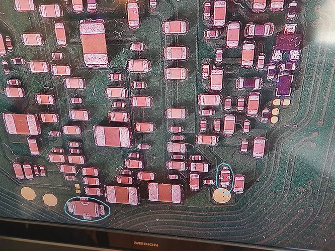

Also, on the following photo (back of CPU), I am not sure what those (blue circled) parts are that have these two additional solder spots on the sides of their “body”, which are shorted to ground too (it’s probably normal, but I am not sure). However some of the solder there looks as if it has been melted before, maybe the previous owner put it in the oven or something ^^

Caps below SoC connect to earlier measured rails, these critical rails are short to ground (red, yellow) hence why some of the caps etc are measuring short.
It’s an inductor btw, almost looks glittery, that’s the ferrite.
I would have expected the output to be enabled while attempting to boot linux and a voltage present at the highlighted point, you could check this on another switch.
Tbh i think it’s more likely to be Ram or SoC… but the Mac IC is easier to remove
