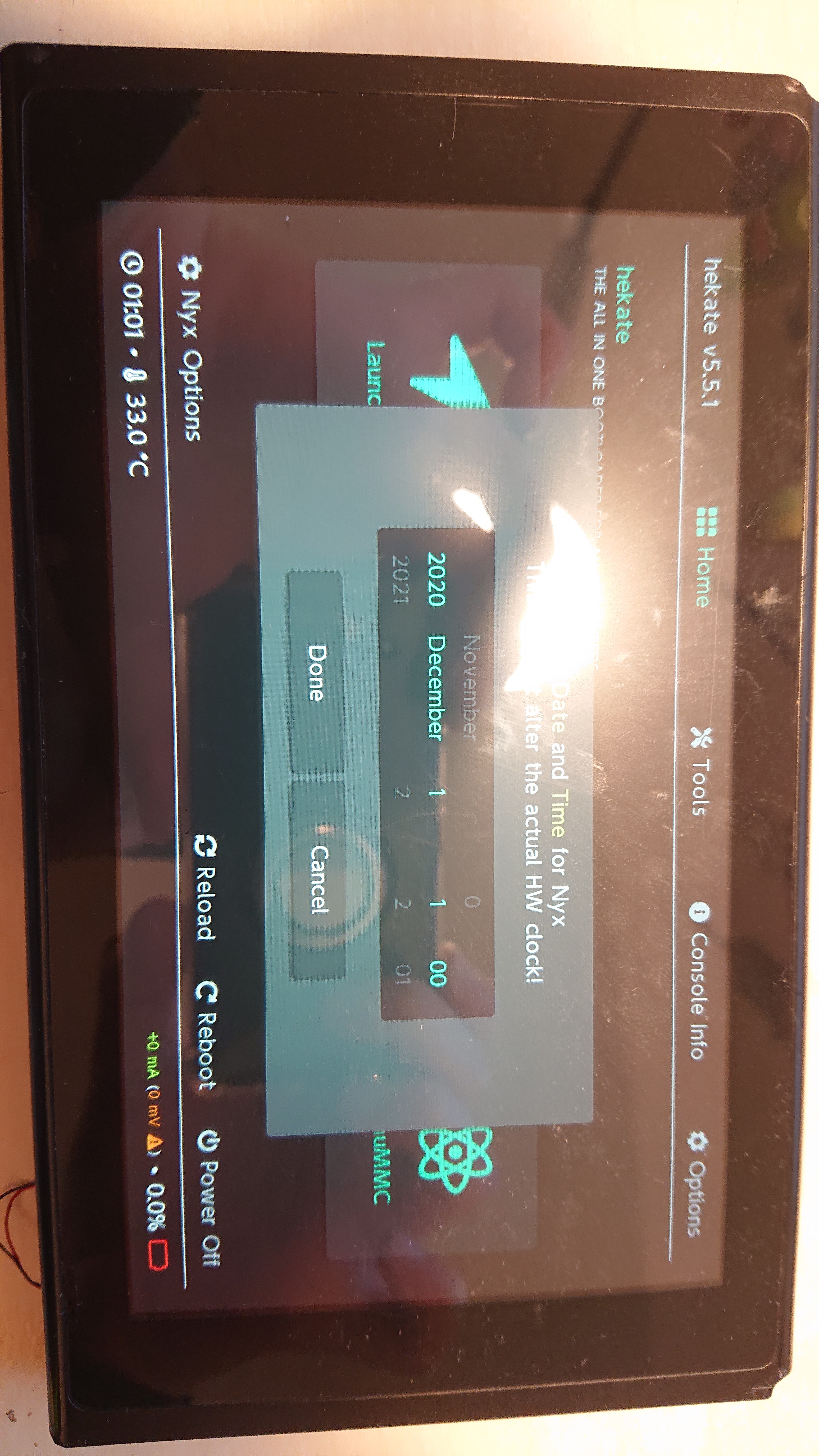

It booted in hekate, but then i could not proceed because touchscreen isn’t working
Also seems like it can’t detect if battery is charging or not, neither the percentage

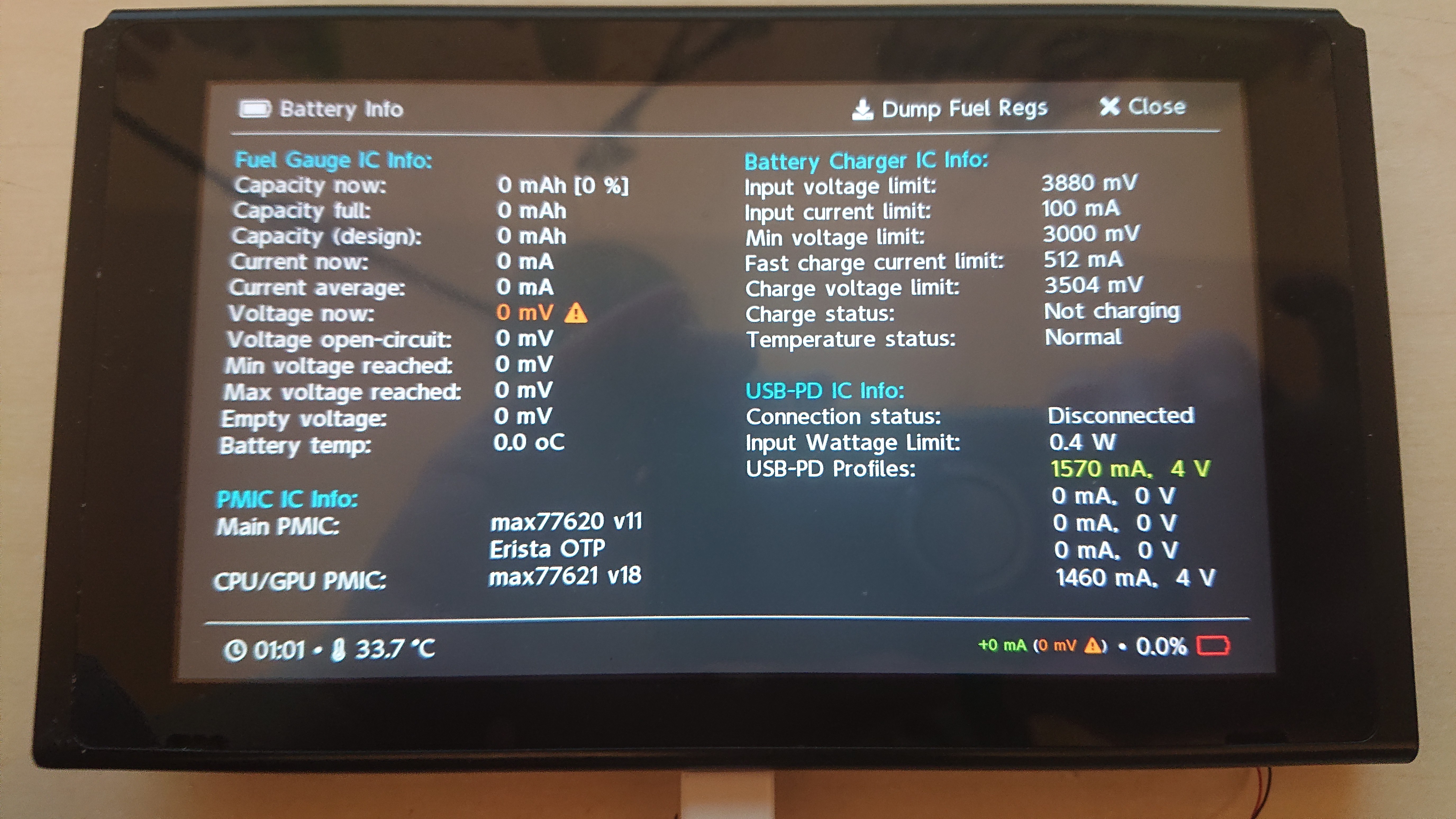

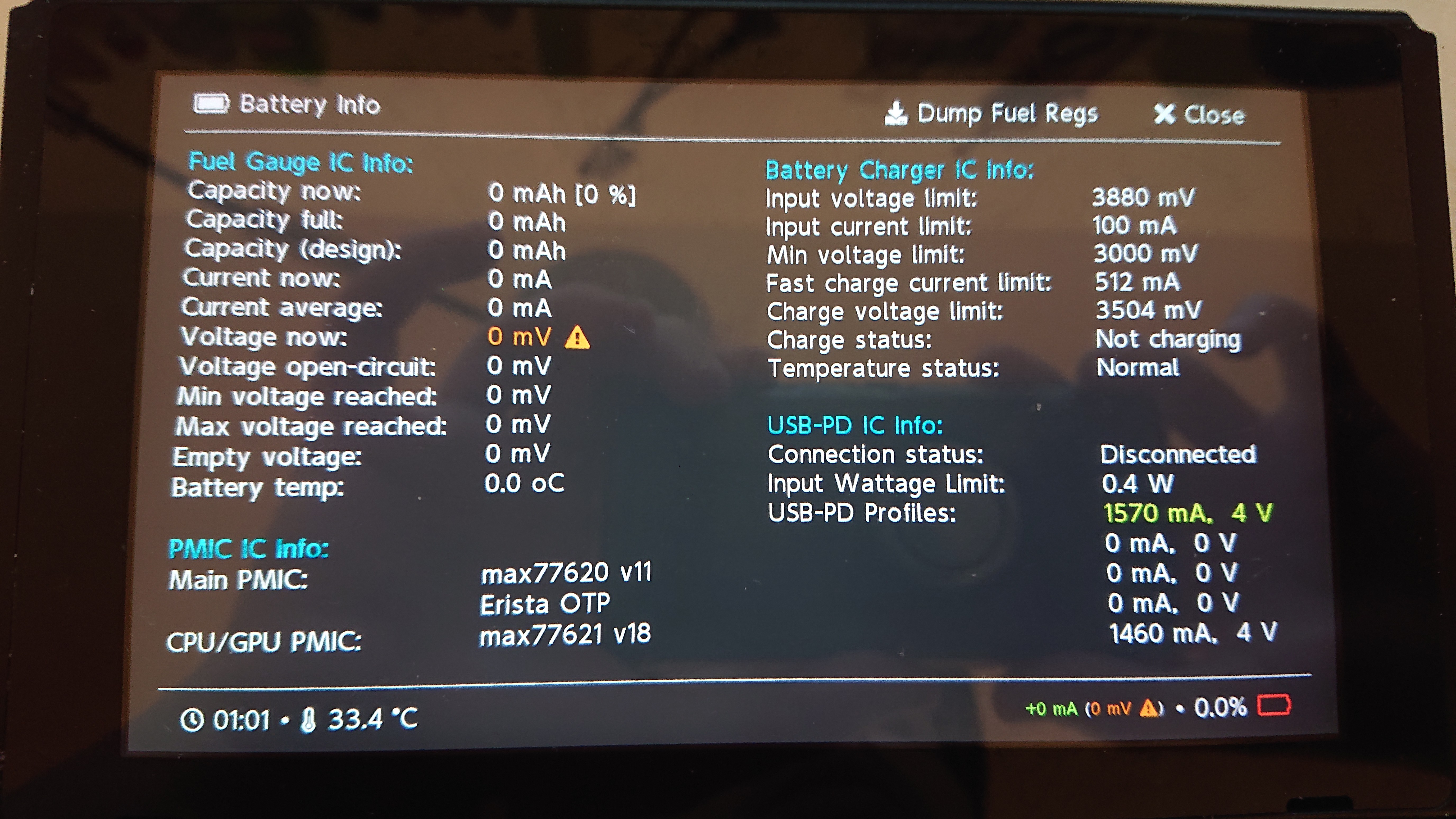

Now I m finally in :slight_smile: . Made a photo of the battery info, need photos of something else?
It would seem that your fuel gauge is bad.
is this with USB power connected?
Nop, should i make another photo of the battery with usb plugged?
Yeah you can do and i’ll have a look
Seems the same
did you try this with both USB orientations?
If yes and the page looks identical, then i think you have two seperate faults, one with the fuel gauge and two with USB, or with M92 IC
Yes, tried now, no changes, the photo is with the orentation that makes the switch noticeable with tegrarcm
yeah, i think first, disconnect power and verify your diode readings on the other diode top side near USB, if they measure fine (same as the other one) then it’s likely the USB or M92. You should resolve the fuel gauge last.
