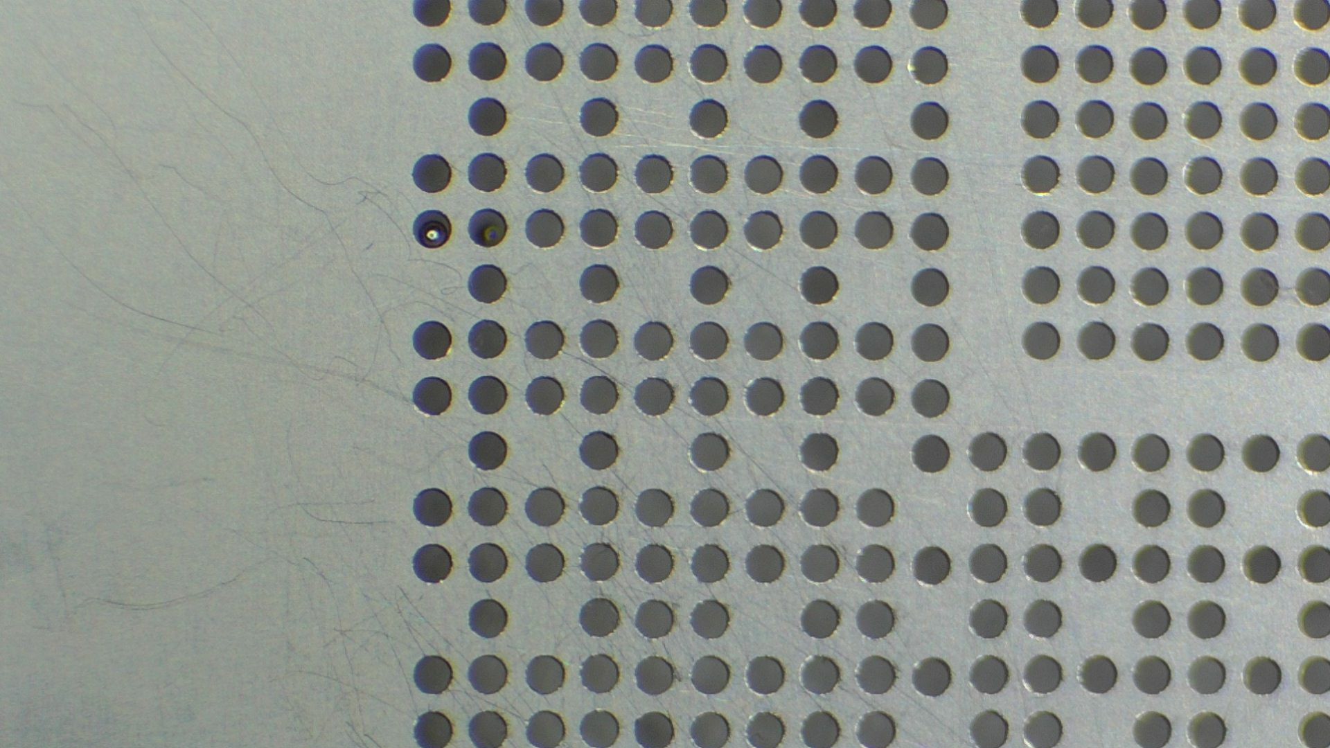

hmm, do a test with the stencil out of the jig (on a flat table or something) and see after putting in the 0.35mm balls if when lifting the stencil they all fall through, or if any require some amount of force to push them through.
It’s possible these Chinese solder balls have too much deviation… which i wouldn’t be surprised about given their track record regarding other solder products.
I will clean now with break cleaner. Maybe IPA is not degreasing the stencil perefctly. Afterwards I will just put it onto a table as you recommended.
If you check the picture I attached before thatn basically it can be seen that the balss are way smaller than the holes but still stuck to the edge inside
I’m using the same stencil as you, but maybe the machining or laser cutting (i don’t know the process) is not as good for some reason and the edges are rougher or something.

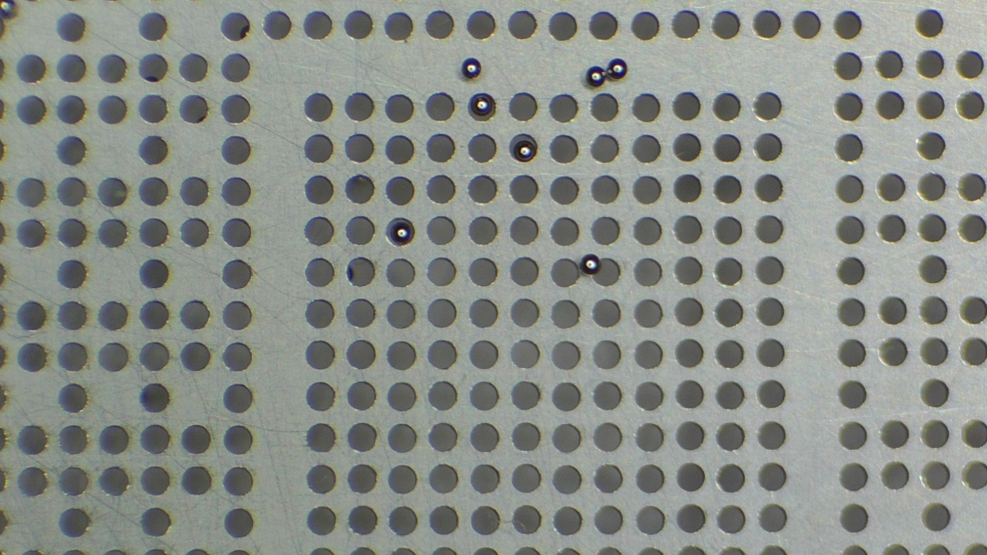

Look at this. It really looks a little bit like static… This is now after cleaning with brake cleaner, tested on the table yust with ca 50 balls… I am really sad thath nothing wants to work out :frowning:

I earthed my balls :slight_smile: but did not work either. At least 20-30% of them stuck inside… I am really close to through them out on the window :smiley:
Haha i had my doubts if that would work. Well i think as we both have the same Stencil then it must be the balls at fault, perhaps they aren’t as spherical as the ones I’m using and minute flats gives static more effective surface area, or perhaps they’re a fraction bigger.
